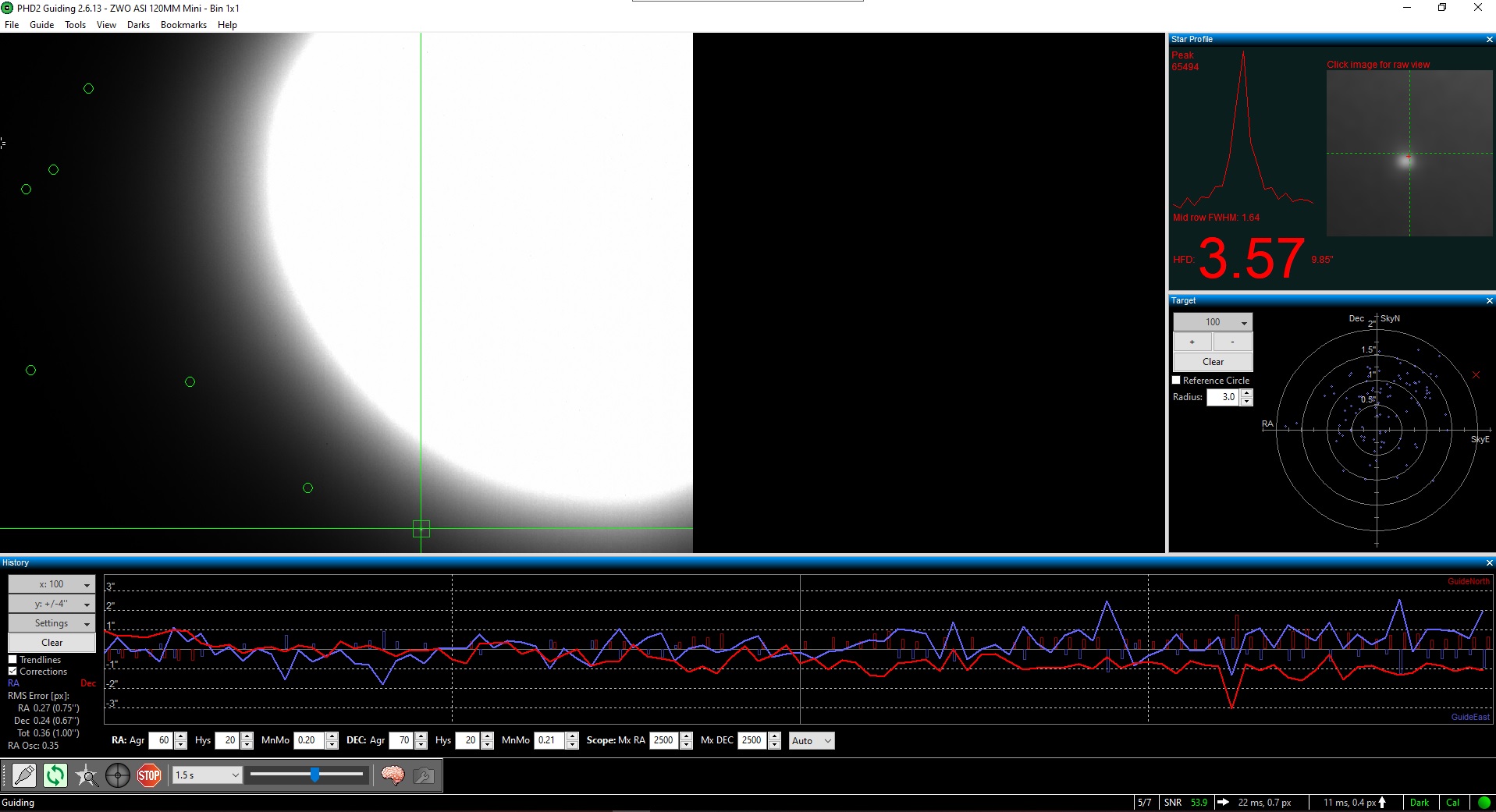

I actually did guiding in the last Saturn Occultation. Not because I needed for capture small videos, but it was the way that I found to keep the planet as center as possible during the night and the event, since I was at 6400mm in a SCT using a tiny CCD sensor from the old school. Any brease at the focal lenght would take the planet out of the way.
I guided using a mid guide scope on the planet itself, which did a perfect job. In my situation, a few minutes before the first contact between the planet and the Moon, I switched to Titan who was still visible, and then ended a few minutes after the complete occultation. Then 45min later I did the same thing when the planet came out from the other side of the Moon, starting with Titan, the going to the planet. I only used PHD2 to do this.
Here's a peek of the guiding (I'm at 1" of RMS, because I wasn't with a good polar alignment at the time and I was guiding with too much brightness because of the Moon, but usually my mount goes around 0.50" in this situations.

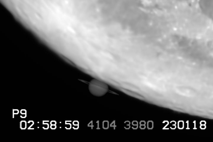

This was my final result on the main camera:

Critter 0.90
That’s a great shot, amazing capture!
