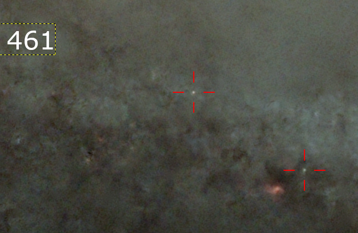

Just following up on your suggestions.  It took me a while to get GIMP installed and a bit more time to do a few tutorials to get past the initial learning barrier.  Once I was able to learn the simplest skills sufficiently, I have taken a week or so to actually put them to practice to convince myself that it is GIMP that will work for me.  See a simple example of what I was talking about:  image.png
Yes basically the same functions that are provided by Annotate Image or WhatsInMyImage, but with the control and the quality of the end result that will satisfy me.  The other two were far too prone to causing artifacts of the graphics and the image and work best for quick results that end up being super useful for other reasons.  My ability here with GIMP will by no means will result in a product that could not be much better if done by an experienced graphic artist.  And likely done far more quickly and efficientlyby the experienced artist, but this retired old fart has plenty of time on his hands...!

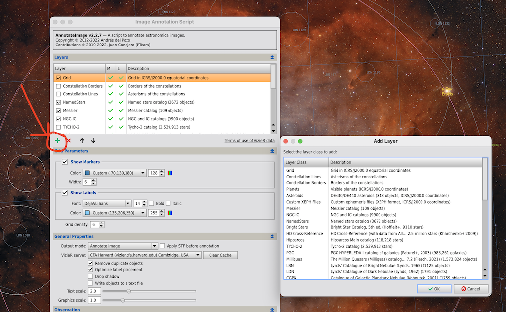

Hi Andrea,  It sounds like you've used the Image Annotation Script in PI and I understand that you're looking for a zooming feature that might allow you to zoom in and get more granular info on objects without destroying the field of view of your image at 1:1... agreed, that would be cool. Unfortunately I can't help you with that exactly but I did recently discover that the annotation feature in PI is a bit better than I previously knew and as a half solution you might be happy to know the following if you don't already:
There is a way to increase the depth of annotated items by including more catalogues and there is also a way to control the line thickness, point size and color of the overlay, which will help towards maintaining a relatively uncluttered view even when you've added more annotation. All of these settings begin with a small green "+" mark, where you can add catalogues that are not immediately available out of the box. Then, with each catalogue or feature selected in the main view, you can control the color and appearance of those annotations underneath. I'll include a screenshot with both windows up; the main window to the left and the catalogue "layers" window to the right. Hope that helps.
