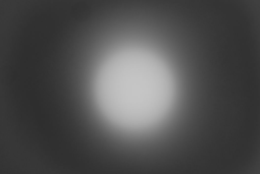

Hi Jérémie, That's an interesting way to fix the problem and I'm impressed that it works, but it doesn't get at why the problem is occurring. In theory, flat correction is very simple but in practice there can be a lot of things that screw up the result and sometimes the cause of the problem is tough to figure out. I've been there so I understand the impulse to simply make it work and move on.
My very first reaction after looking at your flat frame is that something is seriously screwy with your optical system. A good flat should record only two things: 1) The cos^4 radially symmetric radiometric irradiance fall-off and 2) The irradiance fall-off due to optical vignetting, which includes the effects of dust and flaws in the optics such as bubbles and pits as well as light loss due to mechanical edges that may protrude into the beam. Flats should NOT record any stray light from reflections, diffraction, or other stray light that might be different that what your light data includes. Stray light is a killer! In general, a good master flat frame will show mostly smooth variations in signal across the field and the dimmest regions will not be significantly fainter than the bright regions. Sharp variations across the field like I see in your flat data are typically an indication of serious problems.
From what I can see, it appears to me that you are starting off with WAY too much vignetting in your system. Have you looked backwards through your system from the sensor position to determine: 1) What things are blocking the off-axis ray bundles and 2) If there are excessive stray reflections from interior surfaces in either the telescope or your camera package. When you have so much vignetting, small differences across the flat frames can turn into very large differences in the calibrated result. I don't know for sure if that's the problem here but in my opinion, it would be a good idea to get the optics right first before moving downstream to fix anything else.
I know how these problems can drive you nuts, it's always good to have a second pair of eyes. You can’t imaging how nuts it drove me indeed ! I have made many tries and spent lots of time on it, without success... I will post a link with some files if you can indeed have a look at it : I am pretty sure I am part of the problem, if you get me out of the equation, you have a better chance to solve it 😂 Thanks for the proposal Ray
Hello Jeremie, I do agree with John the vignetting seem's to be to strong let's say. Please describe your optical path. Whenever you succeed in the flat the signal to noise ratio in the corners would be very bad. Clear Sky
Hi @John Hayes , Many thanks for your answer. I am happy to read that, because I was suspecting other causes, but was really lost about the causes. First off, I confirm the optical system that issued these flats has flaws : I have a quadruplet that has an integrated corrector to get a flat field and is « made » for astrophotography (M48 thread at the rear), on which I connected a M42 very cheap Walimex x2 teleconverter (originally sold with their cheap catadioptic lenses), on which I connected a M42 filter drawer, with small 1.25inch filters (in this case the SII 6nm). And then the camera that has the sensor 17,5mm away (if I remember correctly). It is a very small sensor (asi183mm pro, sensor is about 13,2 x 8mm). I suspect the diameter of the Walimex introduce some vignetting. As suspect as well the filter is too far from the sensor : I just bought a filter whell, and I could see that ZWO has built it so that the sensor plane is much closer to the filter than it is with a filter drawer. Not to mention the possible reflection of the ring of the filter, the coating of the Walimex teleconverter that is quite reflective I guess... so in my opinion I am multiplying the flaw possibilities. That being said : I used this setup only once to be able to shoot the Bubble Nebula that was quite small without the teleconverter  The lights were as badly vignetted than the flat you have seen, even 1 sub... but twice less contrasted than the flat. Here is the final result using my method : https://astrob.in/u8xmhp/0/My method alone could help get most of vignetting problem, but my calibration being done by hand, if was not perfect after stacking of the subs, then I had to run a dynamic background to finish it anyway. So it works but is not a great solution. Last but not least, I also did pictures without the Walimex, and the vignetting is really smooth, as you said, and really less severe. But still more contrasted than the subs. Thus overcorrecting my lights during calibration. But this time my measurements where closer and I did not need to use DBE in Pixinsight to « finish » the correction. I suspect the diameter of my filters to be too small given the distance to the sensor. And it is so expensive I won’t change them, but I will put the sensor closer once I can use my filter wheel (I can’t use it : my Skyguider Pro will be killed if I add one more thing on it.... 😂). I am waiting for my CEM70. Thanks again for your input John, very instructing.

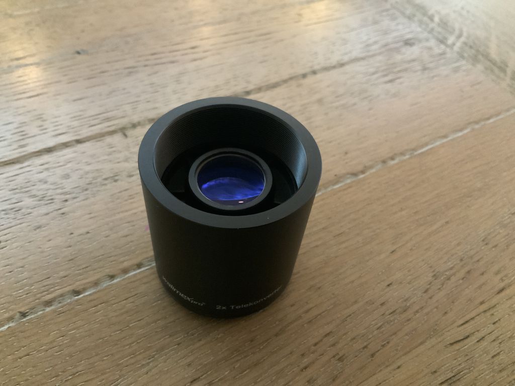

@John Hayes : forgot to mention that this is also for this teleconverter that I was looking for a solution to reduce the come using deconvolution :-) It is small, but can generate lots of troubles and discussions ! Thanks again, I am really going to check how to mount my setup (filter / sensor distance first, but maybe also backfocus and this sort of things... I bought the quadruplet with integrated corrector thinking I wouldn’t have to worry about that, but it seems that I need to).
Here is the guilty... Now, looking at it, the lens seems small in comparison to the M42 thread, knowing it is screwed directly after the M48 thread of the refractor (with very very thin adapter ring. So pretty sure it reflect large amount of light all over inside the. Optical train when lit with « intense » light source (though I don’t know if the law of reflection and refraction are also functions of intensity in « real life »... for me they were just depending on wavelength, indice of refraction..). Maybe I should have used larger rings to put it backward ? Concerning stray light : I have doubts... all is « screwed » with threads, so in theory no stray light. Maybe the filter drawer ? But it is well made. And again, everything was worse with this teleconverter - I probably badly illustrated my problem with it - but the overcorrection happens as well with a more standard setup. So it may still be light stray with filter drawer (but I take my flats at night so it should also affect my lights - maybe not with the same intensity ?), or again a sensor / 1.25inch filter distance. I will have to test that.  |

2) I agree entirely with John, your flat frame shows way too much variance on a small scale. In my experience, getting flats to calibrate the frame properly is almost impossible if the illumination of the sensor is heavily variant over such short distances, such as with your super bright spot in the middle. The only times I've seen this in my (altogether different) setup (an SCT), is when I had the backfocus distance completely incorrect by placing the camera way too far away from the tube, in an attempt to artificially decrease my focal length. I don't do this anymore because I know how harmful it is to the image, however it looked exactly like yours; super bright in the middle with a steep falloff afterwards.

Looks like I see glass being taken out of your imaging train; definitely do this. My focal reducer for my SCT absolutely butchered my images (until I spent $400 on one….) and flats absolutely couldn't fix it, no matter how perfectly taken (long story short, the deviations themselves depend on the brightness and distribution of light on the imaging sensor…  Definitely reduce your system to have as few elements and pieces of glass as possible, and work from there. My flats always worked well until I added the focal reducer, which was another problem I faced in this. Then gradually add them back in, one by one.
I should mention that the pictures of flats I posted are heavily stretched to show you the patterns, for illustration purpose.

Hi Jérémie, The best way to approach this kind of problem is to first reduce the system to its most basic elements. Take out reducers and everything that isn't absolutely essential. You should configure the system with the best mechanical spacings between the components. In general, you want the filters to be relatively close to the sensor and you want to make sure that any guiding prisms or mirrors are not cutting into the off-axis marginal ray bundles (this is appears to be a very common problem). Getting the system properly configured takes patience and attention to detail–and sometimes it requires ordering new parts so don't skimp on parts or short cut this step. To be honest, this is where I screwed up configuring my new 20" scope and it is taking months to fix it. I hate to admit it but I'm an optical engineer…and I still screwed it up! So, trust me, I understand the challenges of getting this stuff right.
Once you have it configured, look backwards through your system from the corners of your sensor to make sure that: A) nothing is in the way so that you can see the entire exit pupil and B) there are no stray reflections. You may have to increase the size of some of the adapters and you may have to apply black paint or flocking to eliminate strays. Paying close attention to details is important! Then take the scope out and shoot some images and some flats to determine if your calibration process works. At that point, first look at your flats to make sure that they look correct with smoothly varying brightness from center to edge. Any variations that appears "sharp" in your flat data may signal a potential problem. Next, do some calibration runs to establish that your processing steps and settings are correct. Once everything is working, you'll see perfectly calibrated images at the output. Then (and only then) start adding other optical components to your system such as reducers or compressors. You will still need to look for vignetting and strays so don't skip that step. In general, my advice is to keep your system as simple as possible–for a lot of reasons; but, sometimes there are good reasons to include additional components.
