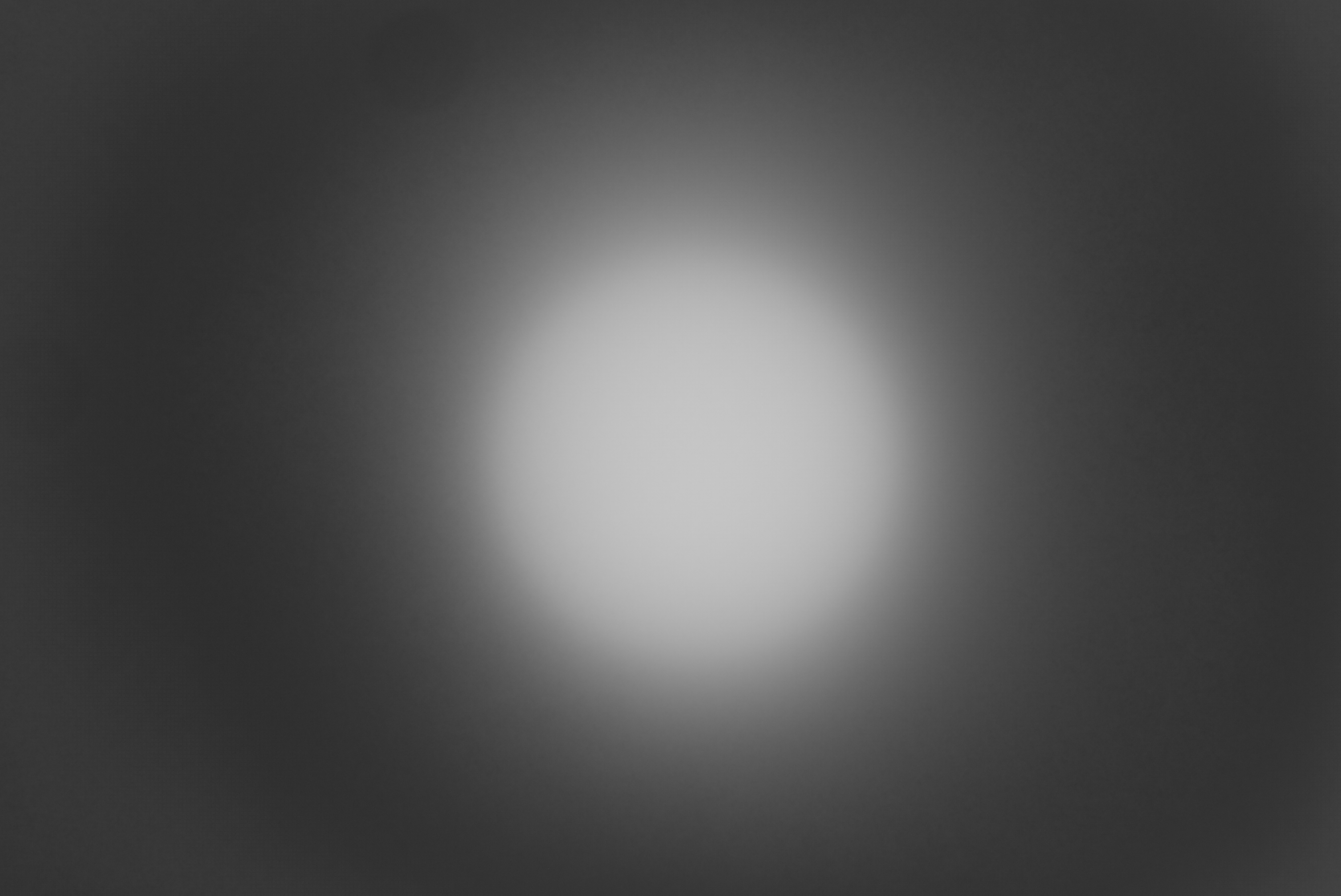

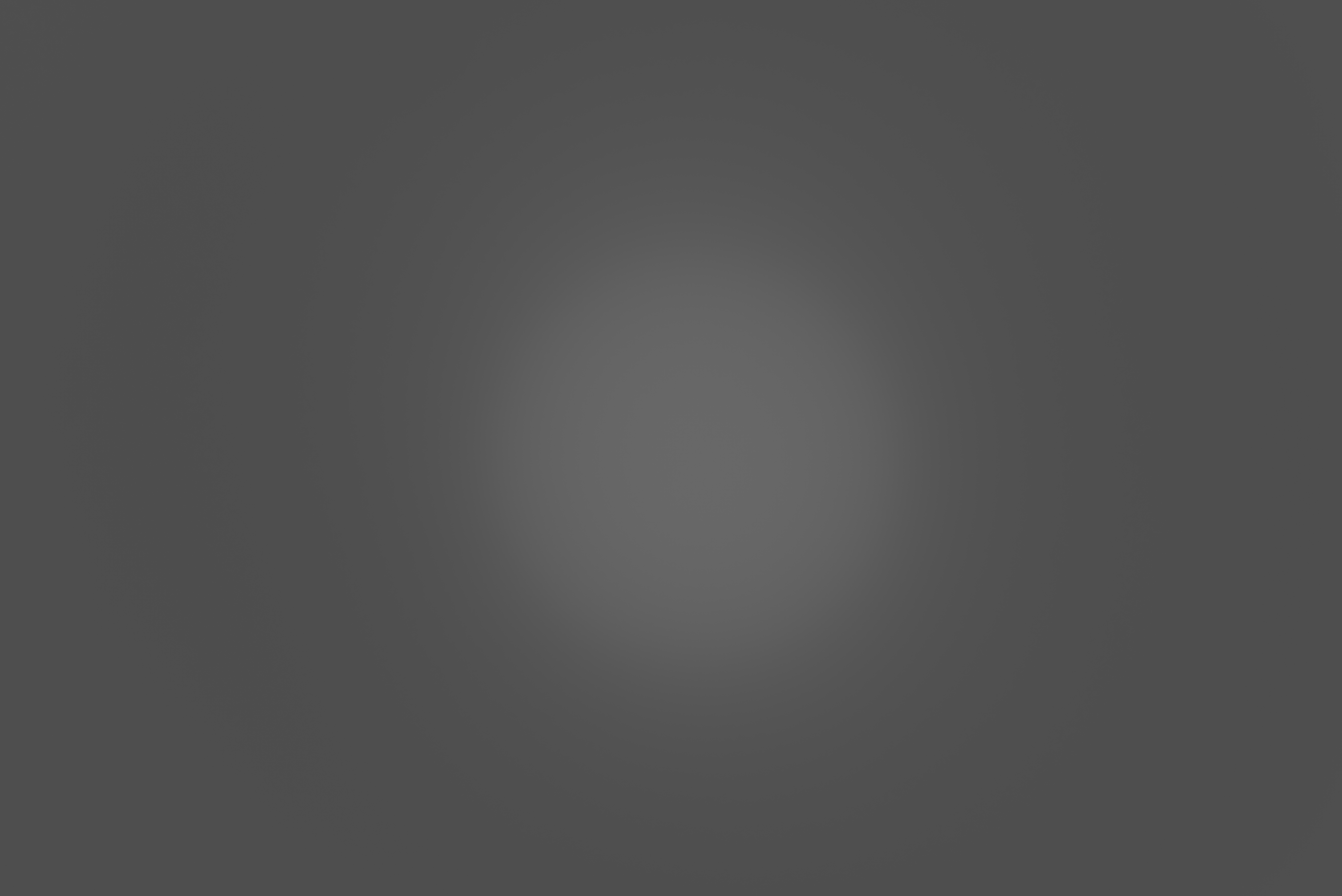

Hi again,
This problem of overcorrection has been a hot topic in many forums and I couldn't find any good solution after testing the various recipes read on those forums (exposure time of the flats > 5 seconds - I have been doing flats with all kind of exposures to avoid "non linear" responses of the camera, but nothing works, short or long exposures ; I have tried various way of calibrating my lights, with Darks that includes Bias or not, with or without Optimize Darks etc.). And I had the same problem in Pixinsight as well as Siril.
Anyway, the thing is : when measuring the ratio between brighter and darker pixels on the flat and in a light, the difference was of around x1,7 (ratio of the ratios). So mathematically, it couldn't work.
I will add some pictures (jpg of my 32bits files) so that you see what I had.
My workaround - which I don't like because it is a dirty trick - was to adapt the contrast of the Master Flat to match the one I have in my light.
To measure the contrast, I have taken some values manually on the flat, at the center and at one of the darkest corner, and did the same - near the same areas in a Light. I derived the contrast ratio in both images and computed the ratio between them (1,7).
Then, with Pixelmath in Pixinsight, I just tweaked the contrast in a classical way :
(MasterFlat - mean(MasterFlat))/(2*1.7) + mean(MasterFlat)
The 1,7 was derived from my previous measurements of contrast ratios above. I still don't know if that's reproductible with my setup.
Then I saved the new MasterFlat ("TweakedMasterFlat"), and the correction works like a charm.
Of course, I may do something wrong elswhere and this is probably not the way to go, but if people who are starting astrophotography like me and haven't finished all the books yet, struggle with that, they may have a quick workaround :-)

jhayes_tucson 26.84
Hi Jérémie,
That's an interesting way to fix the problem and I'm impressed that it works, but it doesn't get at why the problem is occurring.  In theory, flat correction is very simple but in practice there can be a lot of things that screw up the result and sometimes the cause of the problem is tough to figure out.  I've been there so I understand the impulse to simply make it work and move on.
My very first reaction after looking at your flat frame is that something is seriously screwy with your optical system.  A good flat should record only two things:  1) The cos^4 radially symmetric radiometric irradiance fall-off and 2) The irradiance fall-off due to optical vignetting, which includes the effects of dust and flaws in the optics such as bubbles and pits as well as light loss due to mechanical edges that may protrude into the beam.  Flats should NOT record any stray light from reflections, diffraction, or other stray light that might be different that what your light data includes.  Stray light is a killer!  In general, a good master flat frame will show mostly smooth variations in signal across the field and the dimmest regions will not be significantly fainter than the bright regions.  Sharp variations across the field like I see in your flat data are typically an indication of serious problems.
From what I can see, it appears to me that you are starting off with WAY too much vignetting in your system.  Have you looked backwards through your system from the sensor position to determine:  1) What things are blocking the off-axis ray bundles and 2) If there are excessive stray reflections from interior surfaces in either the telescope or your camera package.  When you have so much vignetting, small differences across the flat frames can turn into very large differences in the calibrated result.  I don't know for sure if that's the problem here but in my opinion, it would be a good idea to get the optics right first before moving downstream to fix anything else.

ManuManu 0.00
Hello Jeremie,
I do agree with John the vignetting seem's to be to strong let's say. Please describe your optical path. Whenever you succeed in the flat the signal to noise ratio in the corners would be very bad.

JO_FR_94 6.49
Hi @John Hayes ,
Many thanks for your answer. I am happy to read that, because I was suspecting other causes, but was really lost about the causes.
First off, I confirm the optical system that issued these flats has flaws : I have a quadruplet that has an integrated corrector to get a flat field and is « made » for astrophotography (M48 thread at the rear), on which I connected a M42 very cheap Walimex x2 teleconverter (originally sold with their cheap catadioptic lenses), on which I connected a M42 filter drawer, with small 1.25inch filters (in this case the SII 6nm). And then the camera that has the sensor 17,5mm away (if I remember correctly). It is a very small sensor (asi183mm pro, sensor is about 13,2 x 8mm).
I suspect the diameter of the Walimex introduce some vignetting. As suspect as well the filter is too far from the sensor : I just bought a filter whell, and I could see that ZWO has built it so that the sensor plane is much closer to the filter than it is with a filter drawer. Not to mention the possible reflection of the ring of the filter, the coating of the Walimex teleconverter that is quite reflective I guess... so in my opinion I am multiplying the flaw possibilities.
That being said : I used this setup only once to be able to shoot the Bubble Nebula that was quite small without the teleconverter
The lights were as badly vignetted than the flat you have seen, even 1 sub... but twice less contrasted than the flat. Here is the final result using my method : https://astrob.in/u8xmhp/0/
My method alone could help get most of vignetting problem, but my calibration being done by hand, if was not perfect after stacking of the subs, then I had to run a dynamic background  to finish it anyway. So it works but is not a great solution.
Last but not least, I also did pictures without the Walimex, and the vignetting is really smooth, as you said, and really less severe. But still more contrasted than the subs. Thus overcorrecting my lights during calibration. But this time my measurements where closer and I did not need to use DBE in Pixinsight to « finish » the correction. I suspect the diameter of my filters to be too small given the distance to the sensor. And it is so expensive I won’t change them, but I will put the sensor closer once I can use my filter wheel (I can’t use it : my Skyguider Pro will be killed if I add one more thing on it.... 😂). I am waiting for my CEM70.

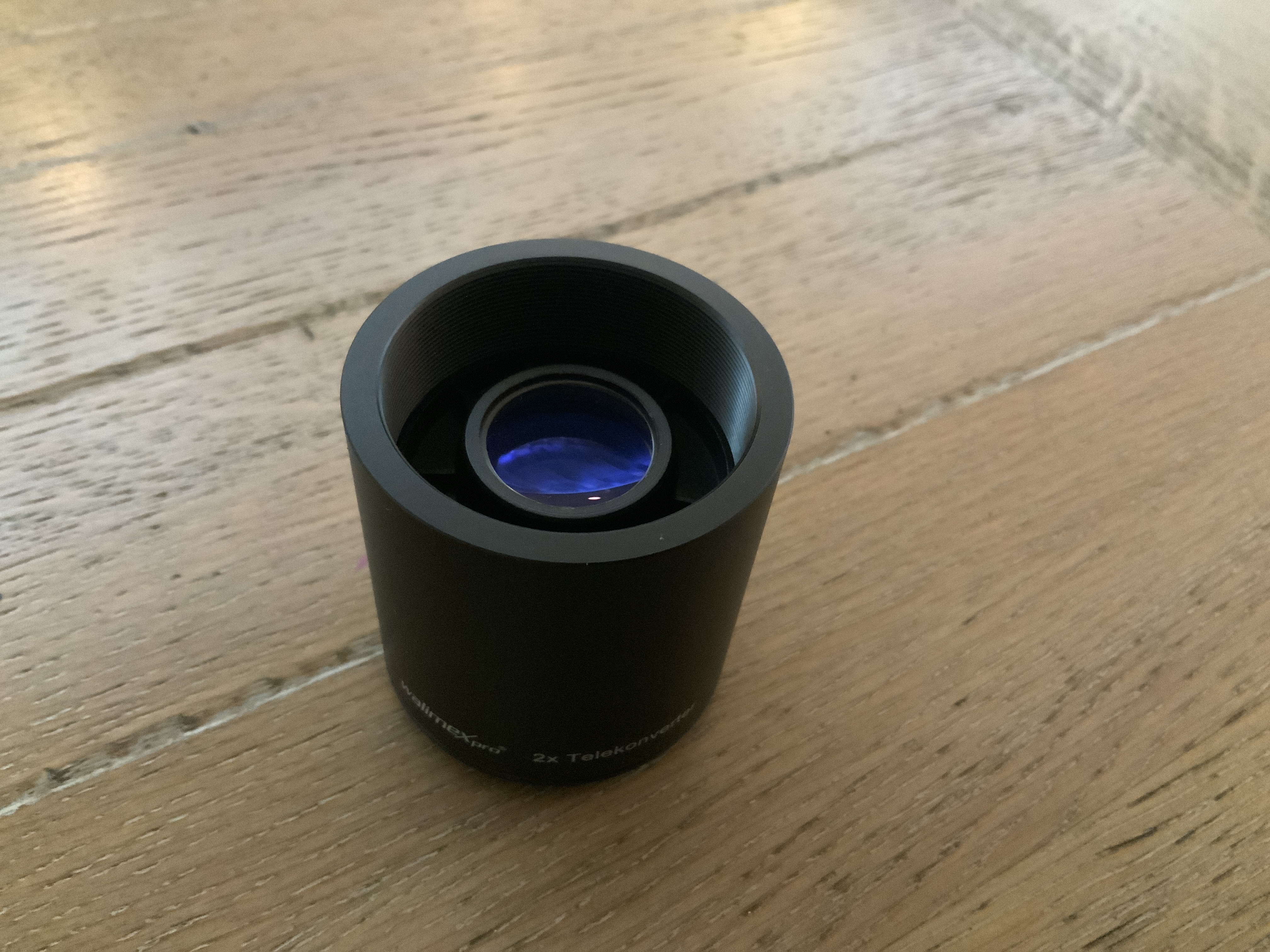

JO_FR_94 6.49
@John Hayes : forgot to mention that this is also for this teleconverter that I was looking for a solution to reduce the come using deconvolution :-) It is small, but can generate lots of troubles and discussions !
Thanks again, I am really going to check how to mount my setup (filter / sensor distance first, but maybe also backfocus and this sort of things... I bought the quadruplet with integrated corrector thinking I wouldn’t have to worry about that, but it seems that I need to).
JO_FR_94 6.49
Here is the guilty... Now, looking at it, the lens seems small in comparison to the M42 thread, knowing it is screwed directly after the M48 thread of the refractor (with very very thin adapter ring. So pretty sure it reflect large amount of light all over inside the. Optical train when lit with « intense » light source (though I don’t know if the law of reflection and refraction are also functions of intensity in « real life »... for me they were just depending on wavelength, indice of refraction..). Maybe I should have used larger rings to put it backward ?
Concerning stray light : I have doubts... all is « screwed » with threads, so in theory no stray light. Maybe the filter drawer ? But it is well made.
And again, everything was worse with this teleconverter - I probably badly illustrated my problem with it - but the overcorrection happens as well with a more standard setup.
So it may still be light stray with filter drawer (but I take my flats at night so it should also affect my lights - maybe not with the same intensity ?), or again a sensor / 1.25inch filter distance.
I will have to test that.

JO_FR_94 6.49
I should mention that the pictures of flats I posted are heavily stretched to show you the patterns, for illustration purpose.
