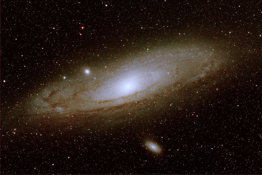

This image of M31 isn't bad, but I think the colors can be improved.  There doesn't seem to be enough blue in it.  I have a OSC camera (ASI2600MC) and separated the R,G and B channels to get the best balance I could.  If I stretch the blue channel too much, the core of the galaxy gets burnt out, but if I keep it subdued I cannot get some blue in other parts of the galaxy.
What are the processing tools in PI that can solve this?  I tried Photometic Color Calibration but it failed.  I feel like this image is getting close but it can be made much better.
60 60" subs.
Thank you!

Hallo Jerry,
i would take more lights. You have 1 hour of total integration time? I would get at least 4 hours, and then see how it works out.
CS Haakon

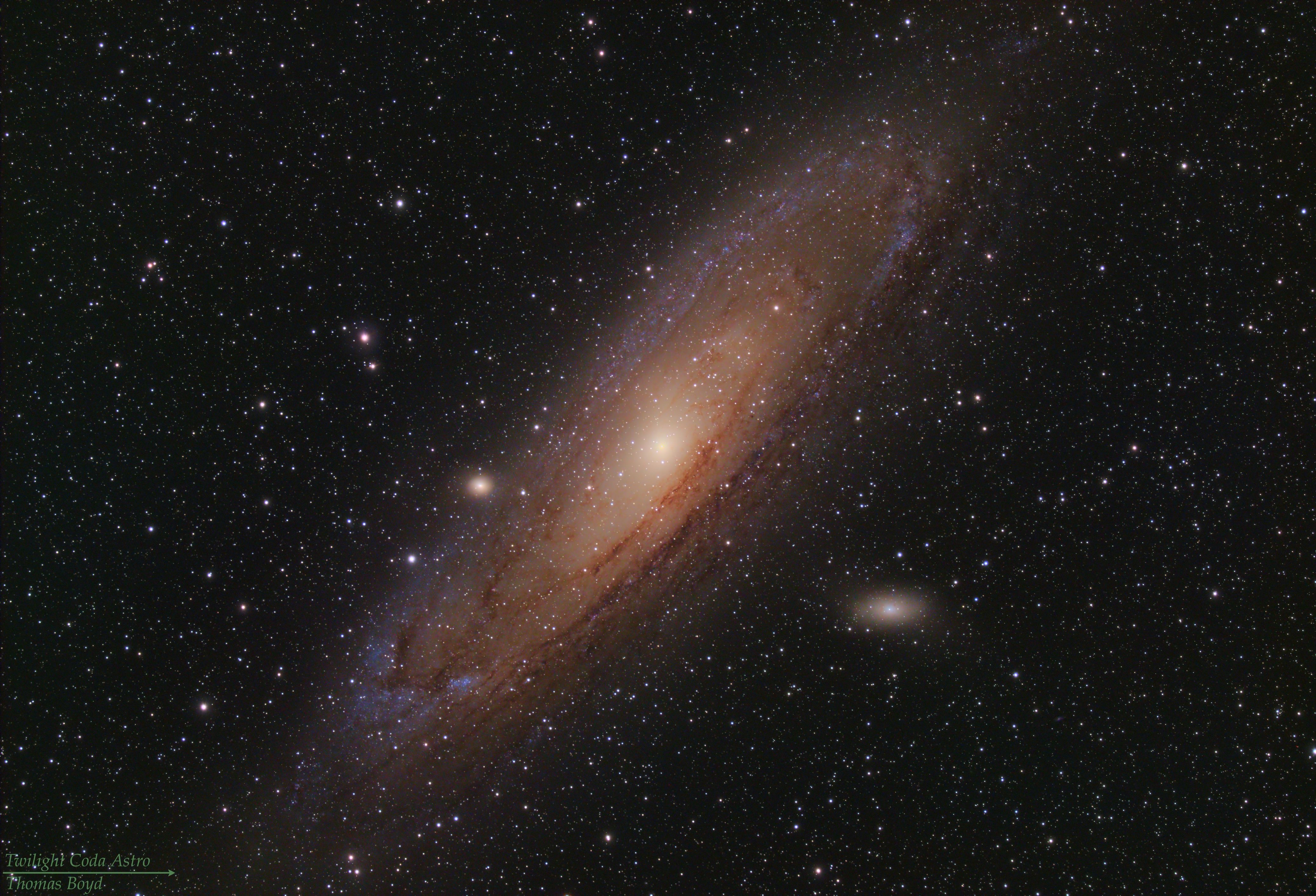

This is mine from last year, also an hour of data shot with a 294mc. Once nonlinear, I use the PI CurvesTransform tool extensively. Don’t know it you are using this,  it it not it is probably my most used tool for nonlinear image enhancement. Anyway, you can adjust color saturation using this tool and the ColorSaturation tool. 162E865F-822D-4DE6-BAC4-1821C4239A60.jpeg
The image is very noisy so obviously there is a need for more photon collection. This said, M31 is peculiarly tricky to get the colours right on a OSC. I'd tend to use ColorCalibration and then tweak the greens out with the CurveTransformation using the Hue tab and changing the transfer function there. Additionally, tweak the colour rendering using the same tool on different colour channel. Masking might also help, if you how to do it.

Like others have said I would get more data. Also make sure to dither if you are not already doing so! The bayer matrix being what it is you want to dither and spread those micro filters around to get decent sampling in all colours.
Also consider giving Spectrophotometric Colour Calibration a try. You can actually combine the L-Pro band passes with the OSC filters in each channel to get a better result.

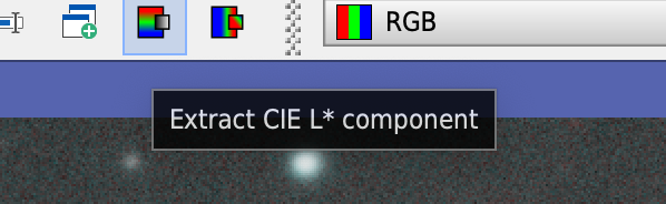

Just curious: How do you extract the Luminance out of an OSC (RGB) image stack?
In PI, you just click the "Extract CIE L* component" button:

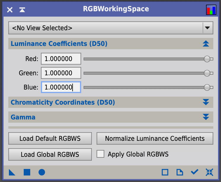

Before extracting the luminance component, I'll typically run RGBWorkingSpace and set all three channels to 1.0:

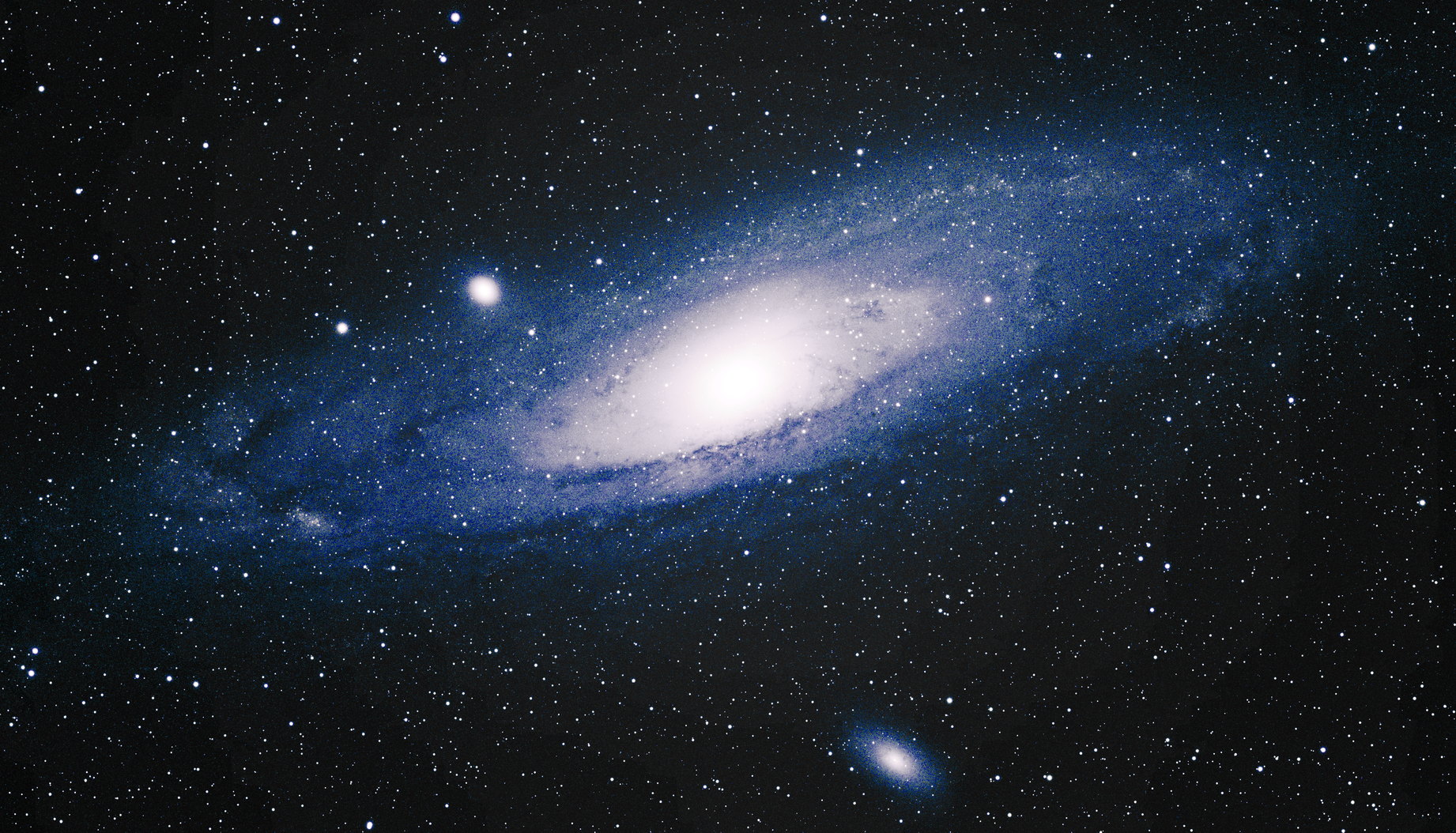

Here's another version as I learn more about processing with PI.   I realize I need to get 5 or more hours of data for this object, but I am taking baby steps as I am learning from the very beginning.   Still not enough detail in the area near the core, but I am working on it!M31 Integration.jpg

Hi Jerry,  this may have been said above. Apologies if it has.
In PI you can use Curves to up the colour saturation .  It is very easy to use.  Open your stretched image and open curves.  Click on the preview (open round) icon in Curves and you should see a copy of ypur image.  Then select saturation which should give you a straight purple line from bottom left to top right.  Click on the middle of it and drag to the left drasgging the line into a curve - as you do do so you will see the colour saturation increase in the preview.  Take it to a level you like – not too far - and then operate on your image and it should up the colour.
But before that step it is very important to have the colour  balance right  by using COL or PHOTOMETIC COL calibration earlier in the work flow - your image above looks too blue I think
