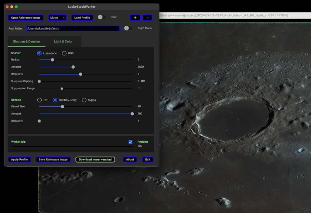

I am pleased to announce the new release v3.1.0 of LuckyStackWorker, which is now also available for MacOS!
LSW is an open source planetary astrophotography app for automatic post-processing of image stacks, with the aim of simplifying and speeding up the process.
Visit the website for download and usage instructions:
https://www.wilcokas.com/luckystackworker
Besides the MacOS release, v3.1.0 also contains several bugfixes from bug reports that I received from various people. Thanks a lot everybody that contacted me about it! Although I have tested this version quite well myself I encourage everybody to report any bugs that you may have encountered in this release.
The MacOS x64/intel binary has been tested and works as is. However as I don't have an arm64 based mac at my disposal I can't confirm yet that the arm64 binary works also on the newer M1/M2 macbooks. Therefor I would appreciate if you let me know that you have tried it on a new M1/M2 macbook via the contact form: https://www.wilcokas.com/contact.
The windows binary may still be blocked by the windows smartscreen. I am working on getting this version unblocked by microsoft, but in the mean time if this happens during installation you can still intall the app when the smartscreen pops up with the message "Your pc is protected from an unknown app", by selecting "More info" and then press "Run anyway".
See a screenshot below for an impression of the app running on the mac.

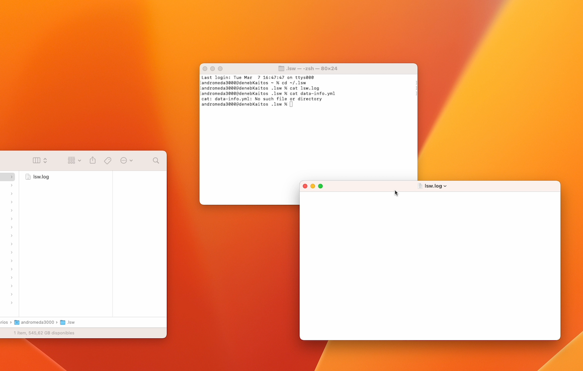

It says "No such file or directory" and if I go to that folder manually there is a .log file there but it's empty ( no text/ code inside ).
Is that on the ARM or the Intel macbook? Do they both have the same result?

In both. I tried first in the M1 computer and right now with the i9 and it says the same and the log file in the .lsw folder is empty in both computers.
WilcoK 7.86
Looks like it doesn't find the bundled java runtime, that must be the reason why it works on my macbook which has a seperate installation for it.
It will probably work when you install the JRE seperately. To do so, go to https://adoptium.net/ and dowload+install the "Latest LTS Release". Make sure to download the pkg.
I will try to fix it in a next revision release.
