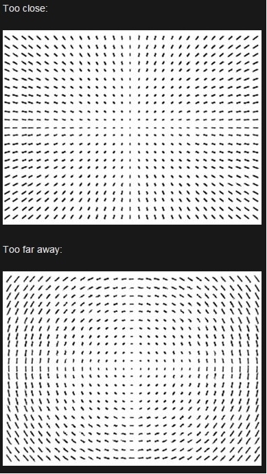

some  very handy info. 915241512_flattenerspacing.jpg.a6833a95acca503166f08bb88911e625.jpg.59fa772a5dc7946306e9f62e8e1a43e0.jpg

@mousta is not using a flattener yet. What his problem is is the so-called Petzval field curvature which requires a field flattener. What you are showing is the behavior of incorrect backfocus distance for a flattener/reducer.

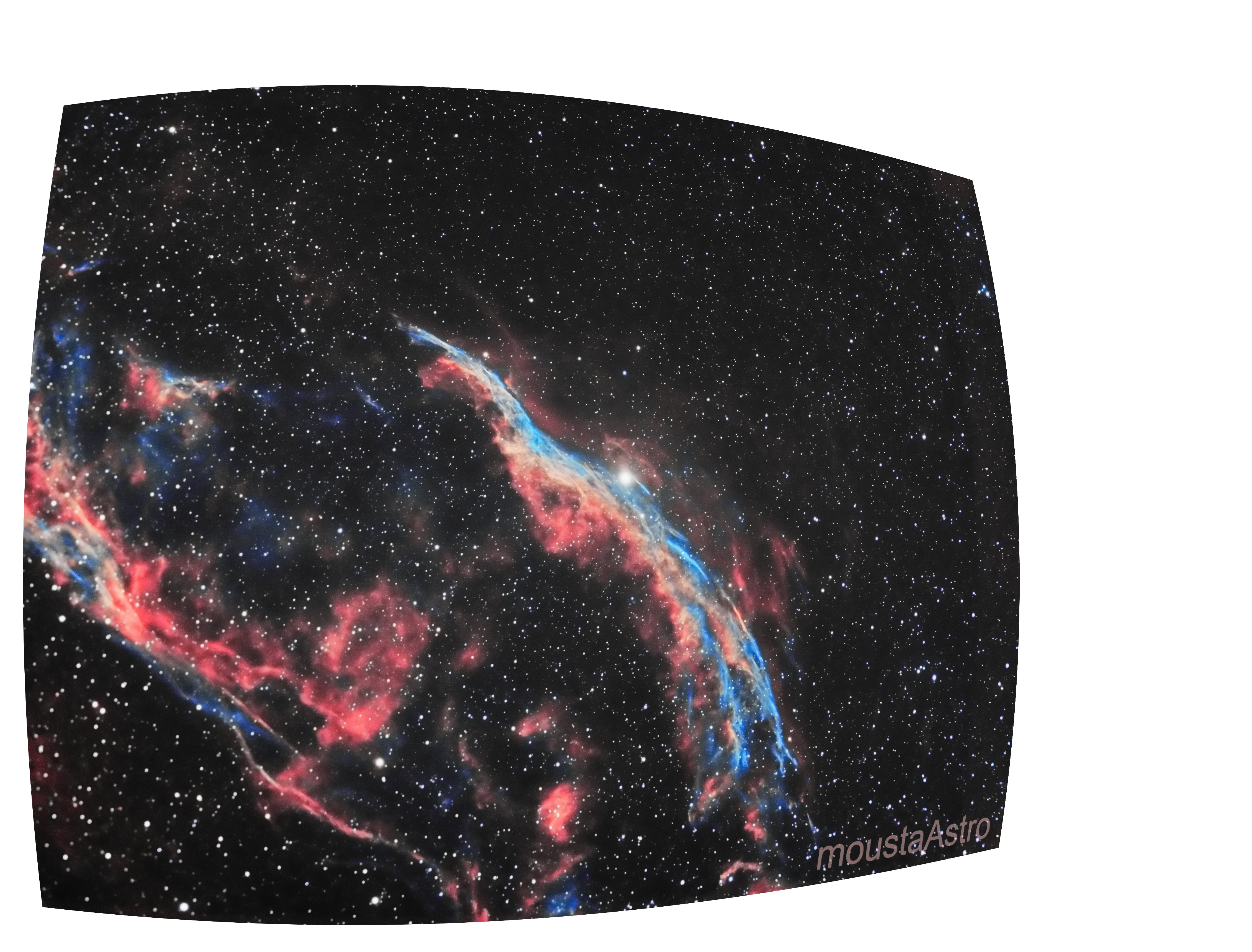

@mousta I couldn't help myself and do some mathematical playing. I've elaborated a small transformation that would do a rough fix but that's more for mathematical curiosity instead of a serious problem solving approach, as I'm still with my statement that a flattener is the way to go. If you give me permission, I would show the transformed copy of your image in this thread to show what it would look like?
mousta 2.71
Thank you all for the feedback - so much to learn still
@Björn Arnold Thank you so much for your thorough explanation. Of course you can edit/post the image
barnold84
@mousta  Thanks. The transformed image at the end of the post. As a general notice: in computer vision, camera systems are calibrated for image distortion. Also in many RAW-Converter programs, there are profiles for DSLR lenses which are supposed to compensate the remaining image distortions. Therefore, I'd guess one could elaborate a software solution. Nevertheless, the goal is always to have corrected optics.
In order to transform the image, I had to find a few parameters by hand (the center of the distortion and the degree of distortion) and therefore, the solution won't be optimal. Judge by yourself. I'm pretty sure that there are software solutions out there which one would find after thorough searches. The problem is probably to place the right keywords in the search box.
Here's the "corrected" image:

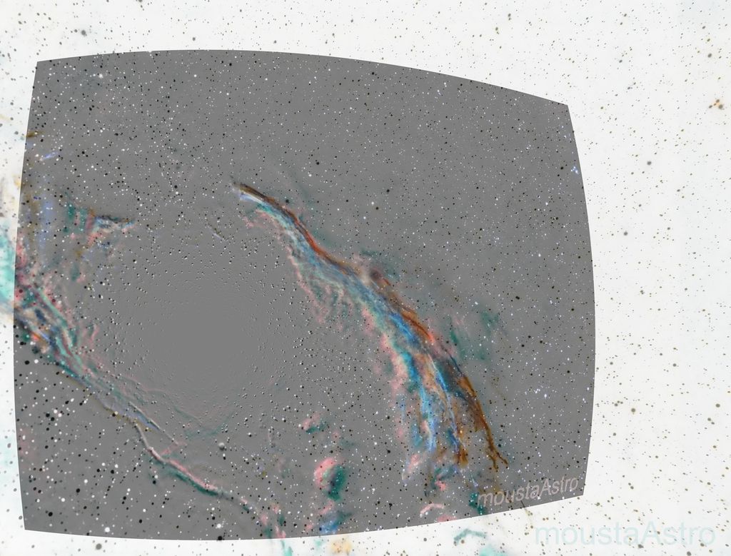

Here's an overlay of the transformed image with the color negated original image to have another idea how much transformation is necessary:
There is indeed one thing @Lynn K had mentioned and, contrary to my previous post (my apologies), deserves indeed some attention if you're going to use a flattener: as one can see, the center of the transformation has quite some offset from the image center. I'm not sure if this is a translatorial displacement or sensor misalignment.
