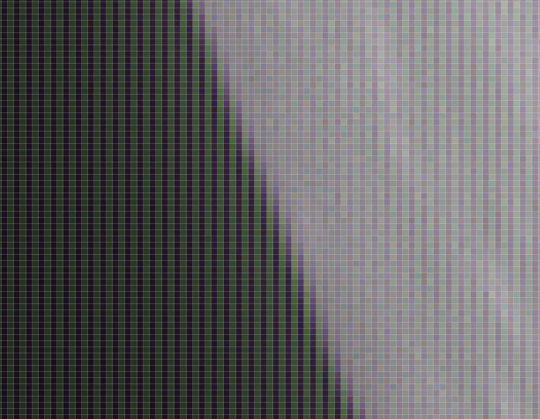

Hi everyone,
I’m trying to process an AVI video of the lunar surface captured with an ASI678MC at 1080p, with a Bayer pattern that should be RGGB. I’m using the classic PIPP -> Autostakkert -> Registax workflow, which usually works perfectly for me with videos captured using DSLRs. However, with the AVI file produced by the ASI678MC (but the same happens with the ASI533MC PRO) , no matter how I handle the debayering parameters both in PIPP and Autostakkert, for some reason the final TIFF image has always a sort of checkerboard pattern and appears "pixelated", as if the Bayer pattern was incorrectly processed at some point in the workflow.
Among the many attempts, I’ve tried telling PIPP either to ignore the debayering, or to apply it, or to force the RGGB pattern and color image detection, and so on. I’ve done the same in Autostakkert, which in many cases interprets the output SER files generated by PIPP as monochromatic, leading me to manually force the pattern there as well.
Regardless of the parameter combinations I try in these two programs, every time I load the resulting images into Registax, I end up with TIFFs that look like the one I’ve attached here.
From my searches online and going through countless tutorials, I’ve seen that this is a fairly common issue, but each thread seems to have its own recipe, and none of them actually seem to work for me. What am I doing wrong, and what is the correct sequence?
Thank you for your kind support!
Carlo

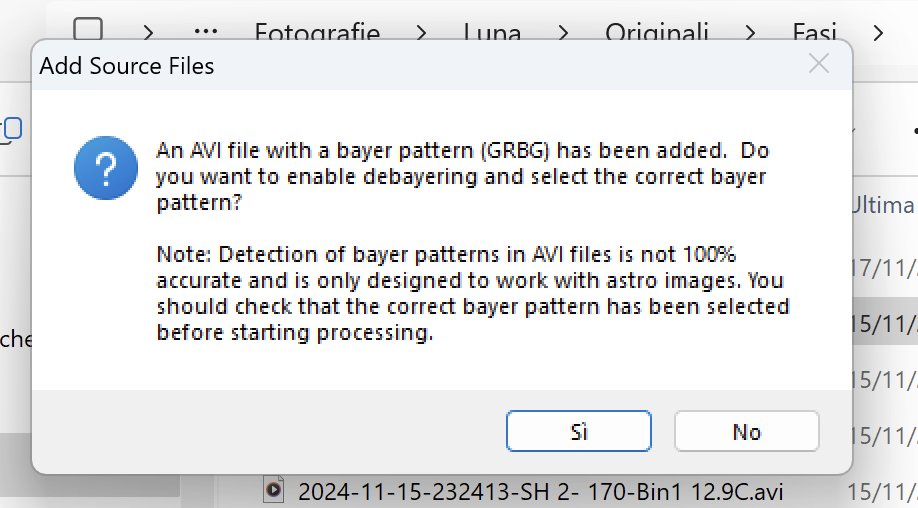

First, every time I load files in PiPP it asks me to choose whether controlling on my own debayering and set the right pattern, or let it to manage automatically. Any of the two method seems working, I guess there is some checkbox or parameter I set wrong in both cases. Depending on the way I process on PiPP, AS4! loads SER files either in gray scale or RGB. Not depending on I set AS4! debayering options or force Bayer pattern, the stacking result is always wrong.
I read in many places that I should not let PiPP manage Debayering, and this is I actually do when process DSLR MOV files, where everything goes fine with default parameters in the entire process from start to end, without any intervention of mine. Clearly there is something different in the ASI AVI files management.

It's visible only in the stacked TIF image after AS4! processed the SER file. To say it all, I realized it in Registax, as the effect is amplified by wavelets (the attached image is from Registax). In the original TIF got out from AS4! is barely visible and I only noticed it after I saw the result of the Registax deconvolution. Source AVIs appear to be perfectly fine, and cannot check SER files. But as I told, browsing the web I found out that this seems to be a known issue due to a wrong Debayering management in the process, but with different approaches suggested, so that I can't figure out which one is the right one.
JanvalFoto 4.51
I use the same camera with the new Asiair, I have not seen this issue before either. The image you posted looks like it hasn't been debayered at all. However I don't force a bayer pattern in software, but I have noticed that Registax doesn't recognize it as RGGB if I simply stack it directly there without using PIPP. I usually don't use PIPP unless I'm using my SLR in order to convert my files.

True, looks like it hasn't been debayered.

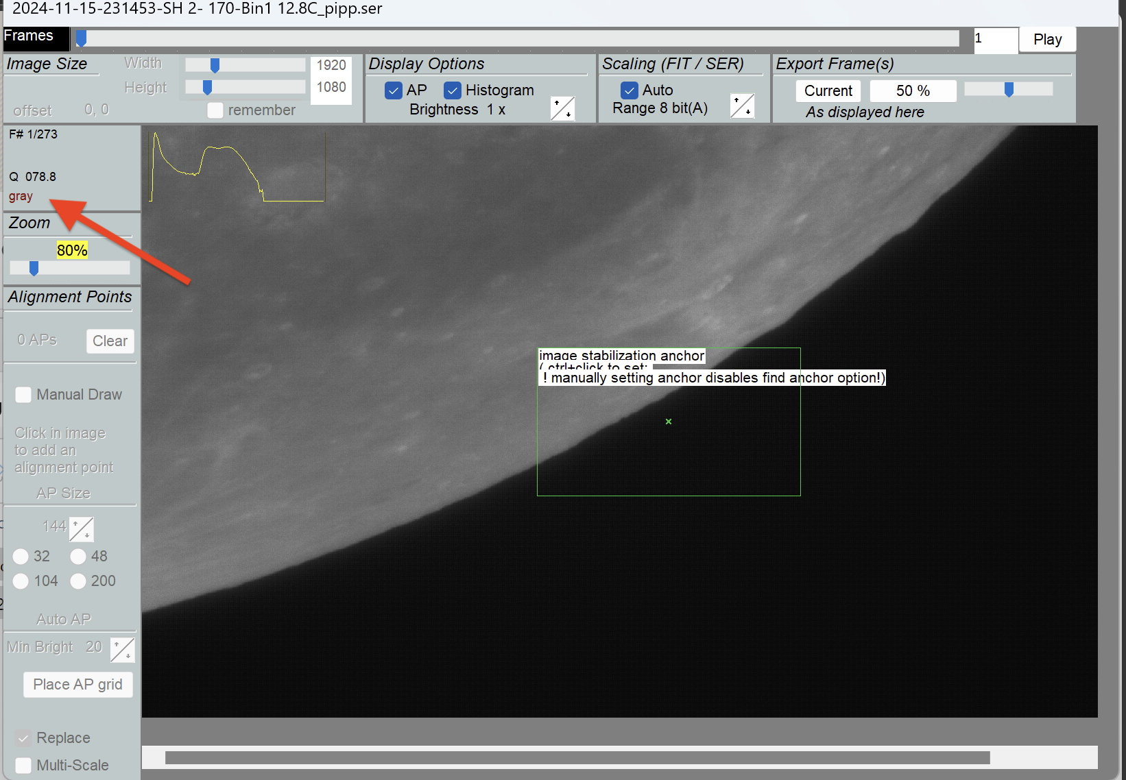

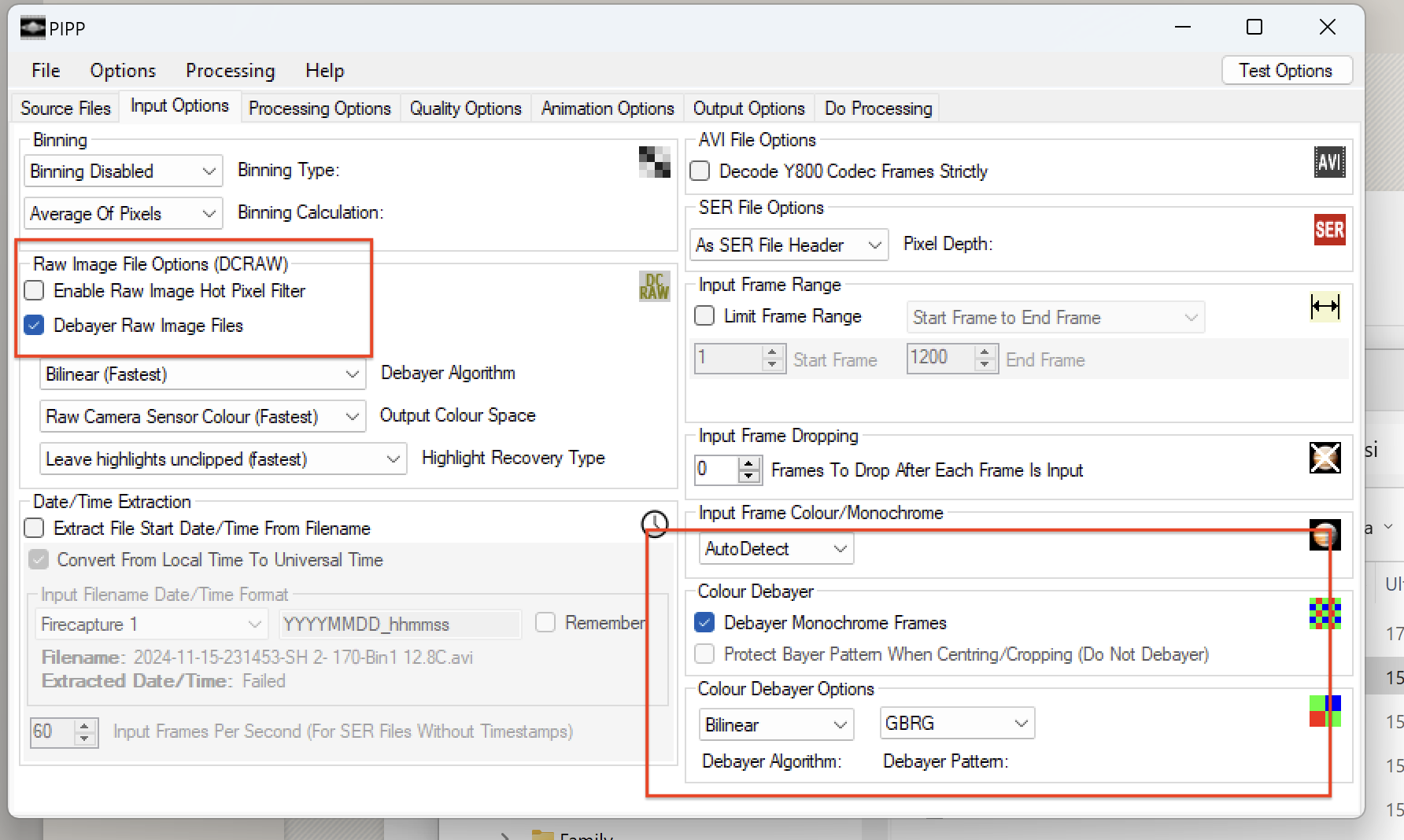

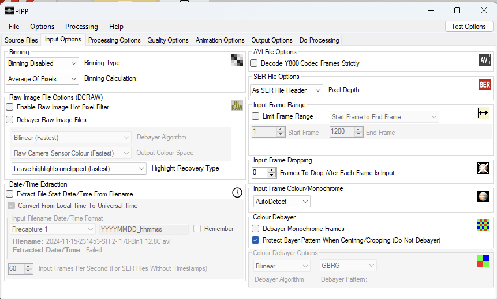

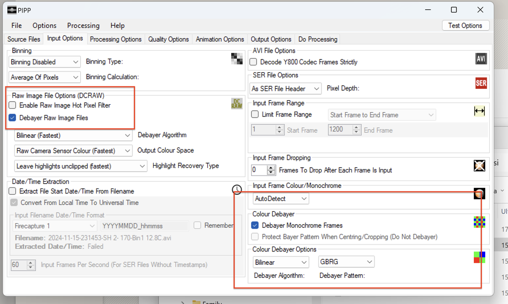

I have tried many combinations of the parameters in the attached PiPP windows. I have read that the default should be to answer "no" to the initial question about enabling debayering (which is interpreted incorrectly by PiPP, because the correct one would be RGGB), no matter the input file, as debayering should be left at AS4! stage.
If I answer "no" to the initial PiPP question, the output SER files look like are always interpreted by AS4! in grayscale, and if I force an RGGB interpretation in AS4! the stacking result is an RGB image with perfectly equal histograms, therefore still in grayscale.
If I answer "yes" to the initial PiPP question, I can set the debayering parameters there and force RGGB, then the output SER files will be seen in color by AS4!, but the stacking result is a TIF image like the one I attached, incorrect, which seems not debayered.
In Registax I usually do nothing, I just apply wavelets for deconvolution.Screenshot 2024-11-17 alle 23.27.23.pngScreenshot 2024-11-17 alle 23.27.43.png

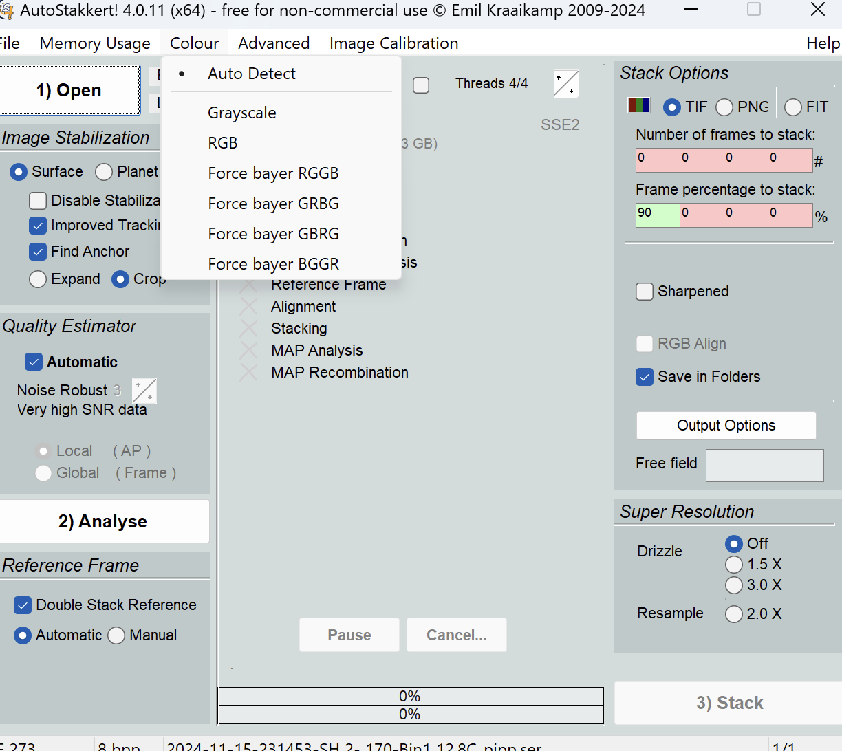

Another thing I've never done is export as .SER from PIPP. Since I don't see any reason to use PIPP at all I would encourage you to test a direct stack in Autostakkert. In my experience forcing a bayer pattern always yield colors that are way off so I've just accepted whatever the software interprets.
Btw: Are you sure that it isn't a result of Autostakkert trying to debayer already debayered data from PIPP?
Edit: Removed some inaccuracies. If you want to let AS! debayer your images make sure you un-check all the debayer options and check the "Protect Bayer Pattern" box.

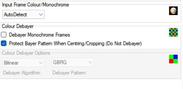

See attached screenshot. This is the situation if I don't let PiPP to manage the debayering, and un-check everything apart from Protect Bayer Pattern. What's happen is that if I let AS4! to autodetect the pattern, it gets gray scale. If I force RGGB , get a TIF image whose histogram are perfectly equal, that's grayscale again.Screenshot 2024-11-18 alle 00.00.27.pngScreenshot 2024-11-18 alle 00.01.48.pngScreenshot 2024-11-18 alle 00.02.00.png

Have you made sure to de-click this option?
Just curious, why do you need to run PIPP before Autostakkert?
AstroHabu 0.00
Yes, de-clicked.
I use PiPP mainly for letting it to reduce the number of frames by ordering them per quality and converting the AVI in SER for an easier processing in AS4! as PiPP is generally very effective and fast in this task, at least with my huge MOV files from the DSLR.
I just noticed that the issue in my workflow seems to be exactly in the way PiPP process the AVI. If I skip the PiPP stage and go directly in processing the original AVI in AS4!, then in Registax there is no problem at all and the TIF stacked image is perfectly aligned.
So now I'm curious to understand what the hell should be the right parameters combination in PiPP for it not doing mess when converting in SER....
