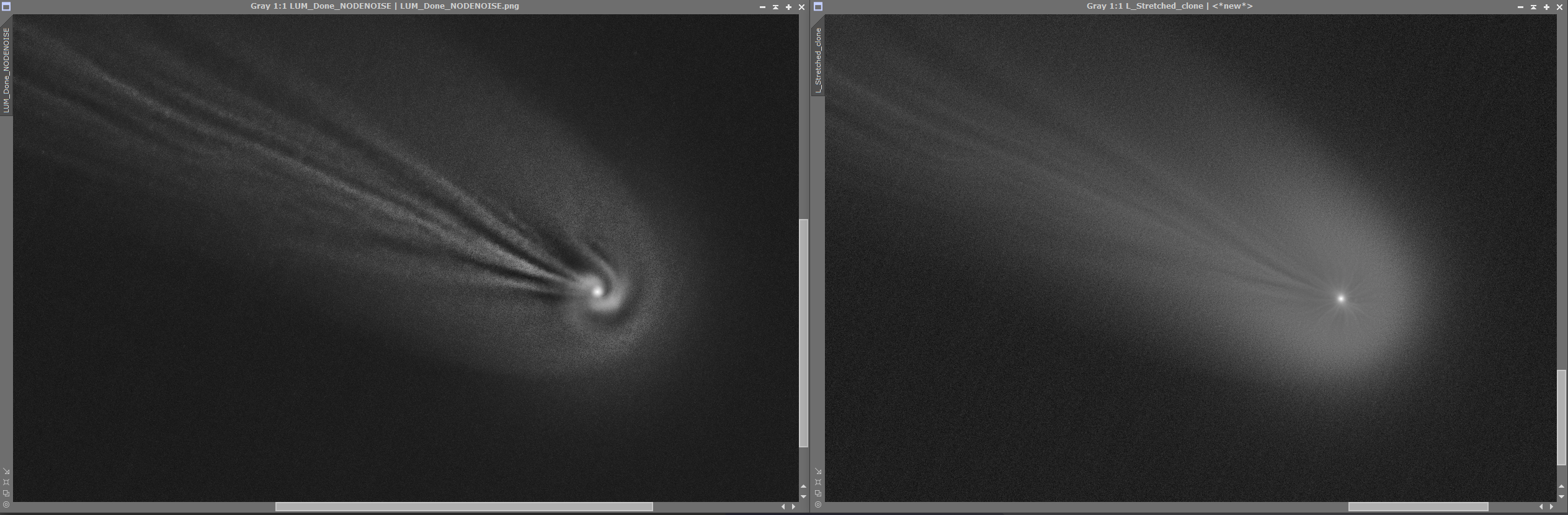

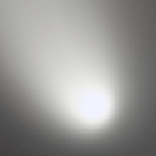

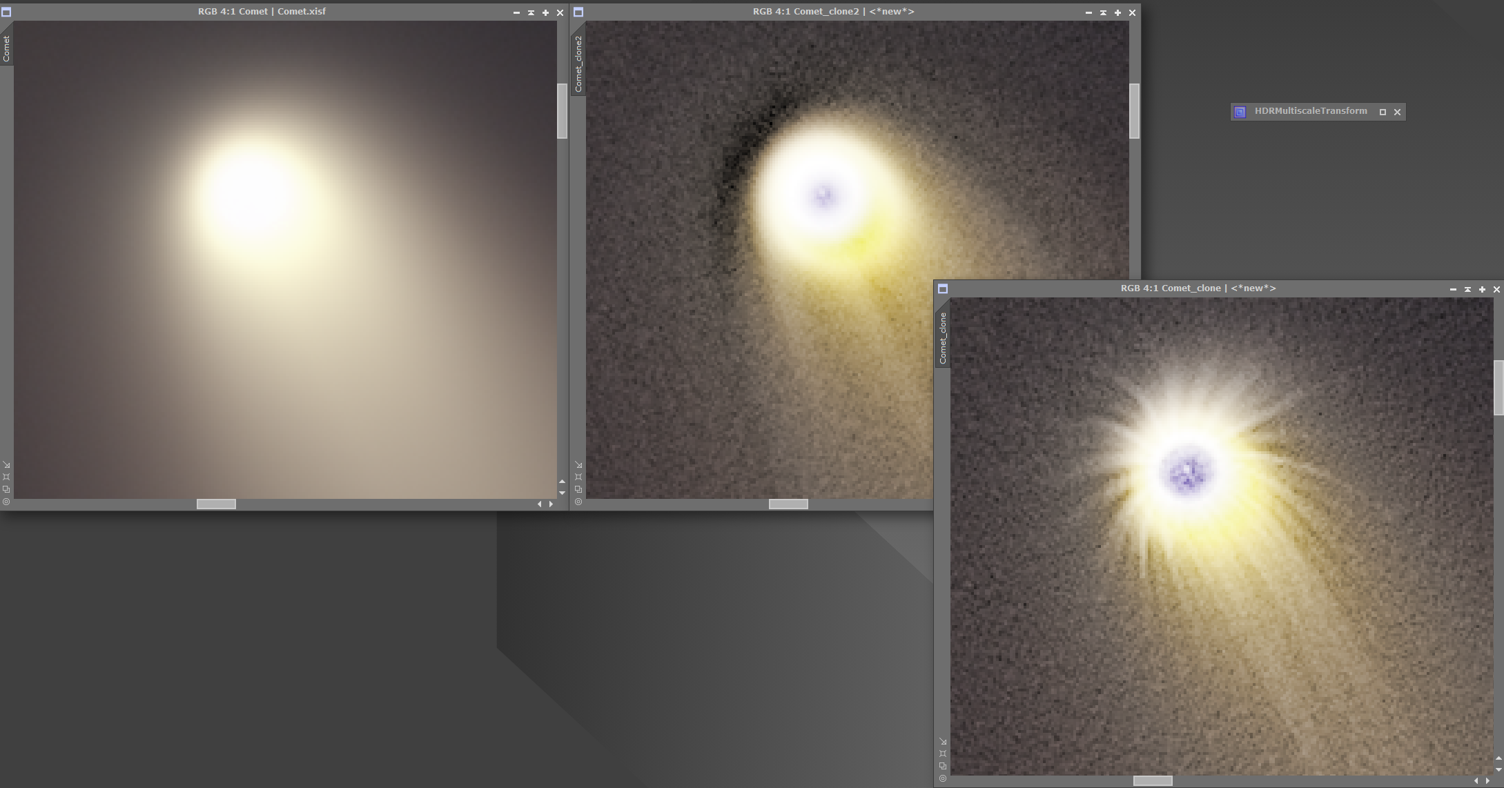

Look above, it's all clipped.
EDIT: This is what happens when you apply wavelets/HDR techniques to clipped areas. None of those details can be attributed as real imho.
I don't know how the HDR script works technically and what kind of artifacts it can generate, but while the center is indeed over-exposed and clipped, the "spikes" show on non-clipped areas, just around the clipped part.
Will HDR still generate artifacts there?

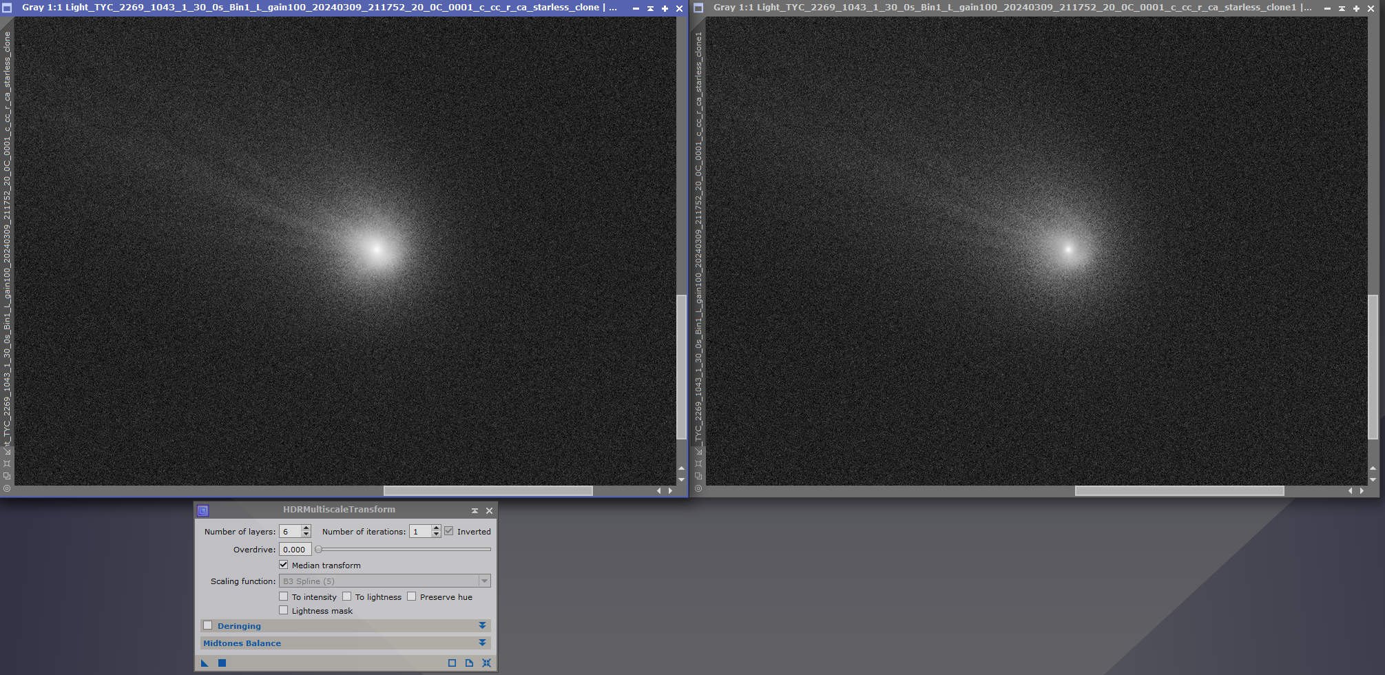

The only way to reproduce this, from my end, is to enable "median transform" within HDRMT in PI, which yield this fireworks look to the outer coma.
Do these median filters guarantee isotropy?
JanvalFoto 4.51

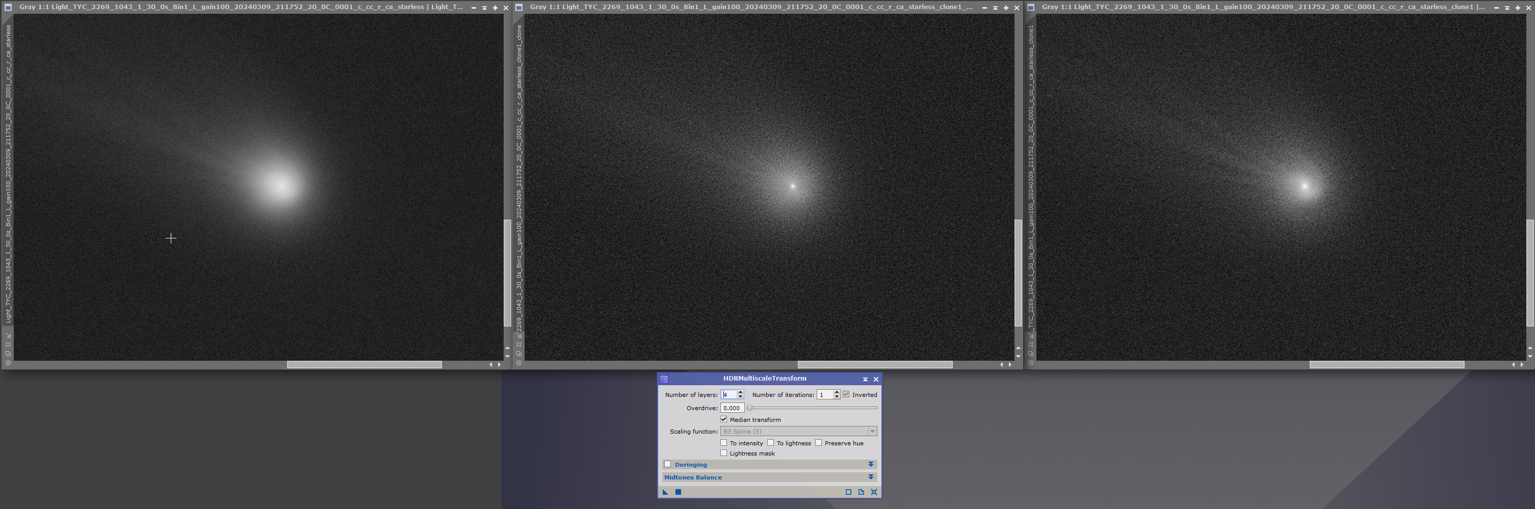

I ran a test on some of my own archived data on 12P, I'm able to produce the same streaks towards the nucleus there. To the left is my method of doing it (without median transform), to the right is a pass of HDRMT with median transform activated + a very high amount of LHE just to make them stand out more.
One thing to note though, is that the lines are much closer to the nucleus in this image vs OP's image
If I apply it to my already processed image I don't get them, in stead they (of course) over-sharpen the already sharpened details of the inner coma. On the other hand, the image treated with median transform lack all the details from the wavelet treated image. Maybe there's an obvious answer to this, but how come that signal is now gone/looks different?
The features I pulled out with originally are also visible in the single exposures in an animation I made, and was confirmed by others as well.
I'm still not quite sure about this. Something definetly pops out by applying median transform, that I haven't dabbled into before myself. As for the isotropic values I'm unable to go any further into validating whether this holds up, I'm not a scientist by any means and unfortunately it does not have any documentation that I can find.

What I take from this is that using median transform might just reproduce structures that may not be isotropic. It seems to be more aggressive at smaller scales and behaves very differently. On the older, written tutorials PI released about mediantransform they claimed that it could produce artifacts around certain structures. For instance eroding/dilating around circular structures, thus generating artifacts when sharpening.
I'm not as sure, but I remain skeptical though. I reckon the best people to answer this would be the PI developers (as there is no documentation of this tool) or one of their ambassadors like Adam Block. I know he went out on HDRMT use on comets during Neowise.

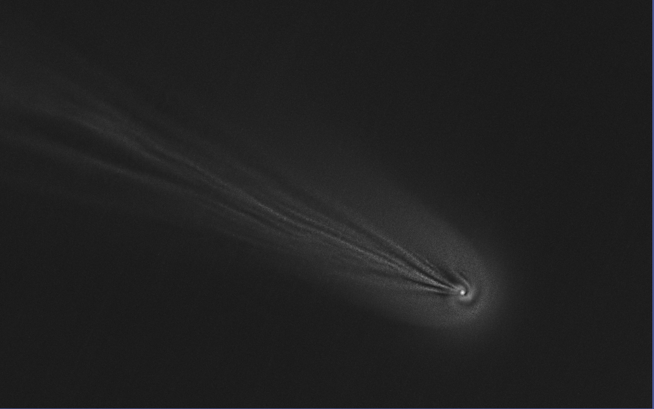

That's a shame but the shape of the "artifacts" really leans me to thinking you actually captured real features of the comet, not diffraction artifacts. Jets are not uncommon and the things showing in your image all curve back towards the tail, in fact merging very nicely with the streams of tail material that are no doubt real. I can't prove it but that's my take on it. The best thing would be for you to image the comet again, being careful not to clip the brightest parts of the nucleus, I'd love to see it.
That's what troubles me the most.
In Jan's reproduction on 12P, the spikes seem to spread more evenly, so I can understand them being the result of artifacts.
But on C2023/A3, as you mention, they seem to bend from the front to the direction of the tail and merge with the more extended tail jets.
Again, I don't know what the median transform algorithm does, but they do look realistic.

That is a good question, I might add that I was unable to reproduce the streaking on single exposures as I only got an eroded coma when applying the median function on them. This adds to the reason why I think it's quite possibly artifacts, I'm not going to be as dismissive as before, but the wildly conflicting results at least point me towards that conclusion. As I mentioned though I was able to see the structures I found in each sub-exposure and make this short video where you can see it moving naturally as well.
An illustration of the use on single subs, just a quick pass with the same settings and a gentle HT stretch to the original. The original is to the left, median transform in the middle and without median transform to the right:
To me the image in the center looks more eroded, especially in the coma where actual details have been wiped. However, when I increase the number of layers on the median transformed image the results start to get more similar, which leads me to think that the tool might just be too aggressive, thus causing eroding/artifacts, when using less layers:

I just posted on PixInsight's forums:
Median Transform on Comets: Artifacts or Data?
Let's see if we can get a definitive answer!
macmade 3.01
All right, folks!

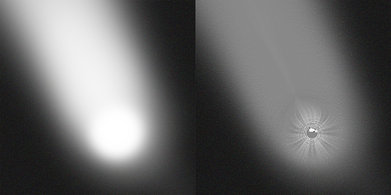

We've got an answer from Juan, who tells us that the Median Transform filter on the saturated core causes the spikes.
This also happens on the other images, although there's still something interesting going on algorithm-wise that could be analyzed.
On my side, I did a simple experiment to confirm these are indeed artifacts.
I created a fake comet image in Photoshop, adding noise, blur, and a saturated core.
Applying a Median Transform filter on it with PixInsight reveals the same kind of structures:
I think we can confidently call it a day.
