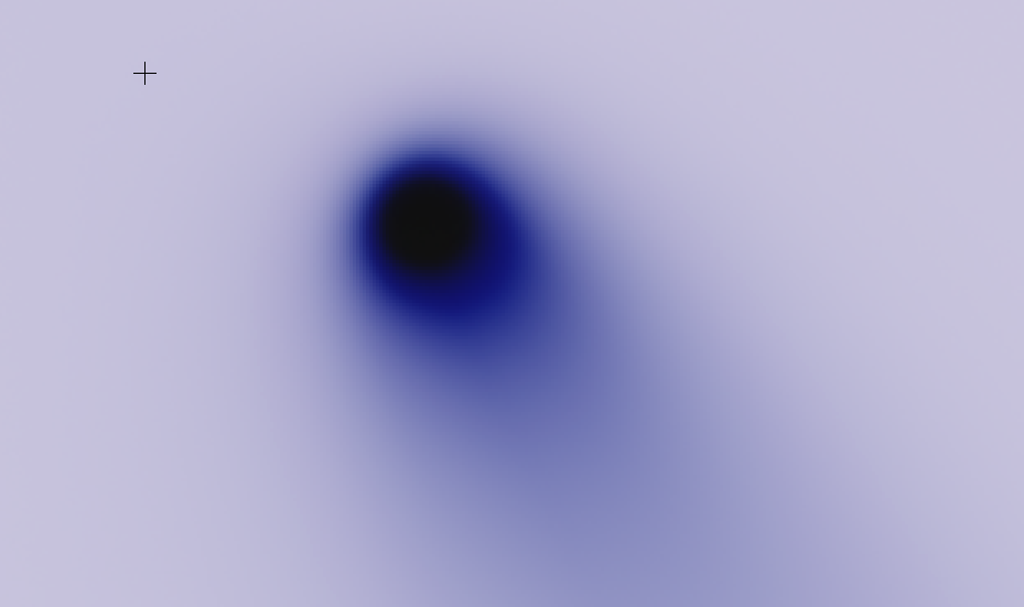

I recently took pictures of the C/2023 A3 - Tsuchinshan–ATLAS comet with my 6’’ Celestron and a HyperStar (300mm, f2).
I processed the stacked image (256 x 15'') in PixInsight and used the CreateHDRImage script to reveal some details on the tail.
This created some interesting structures on the core, as shown below:
I’ve seen many beautiful images of this comet here, but never with such structures, so I guess there are simply artifacts.
What troubles me is that they seem to be in the same direction as the tail.
Does someone have an explanation? Are these structures just artifacts, or do they come from some actual data in the image?
Clear skies!
No artefacts there, those are veritable structures (jets) from the nucleus of the comet. So kudos to you for bringing them out.

Depends on which structures you refer to. The jet streams from the nucleus has been present in most images I've seen so far. Those are real. If you mean the spiked pattern surrounding the blown core, that's probably another story.
Those seem to be the effect of not being careful enough when applying your script. I would encourage you to carefully use something like HDRMT, wavelets and masks to avoid it. The nucleus should be nothing but a bright dot if these are applied correctly, so I reckon you could get a lot more detail from this image )

Yes, I meant the spiked pattern; I should have been clearer.
I've also seen many beautiful pictures with jet streams, and that's precisely why I tried using the HDR script: to see if I could reveal some on my image.
And I was happy to see some, indeed. But then it also revealed or created this spiked structure around the core, which troubled me.
It seems somehow aligned with the stream direction, but also too good to be true.
I'll try to reprocess and give HDRMT a try!

No problem! Also try to gently stretch the image gradually so that the core doesn't get over-saturated. Using masks here can also be beneficial smile
The "spike" are real, I used to get them too (on other comets, not this one as it is still out of reach for me). If I had the raw I can easily enough test it.

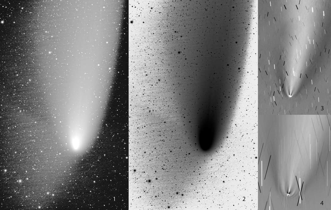

Head over to the ICQ Comet observation group on FB. They log a lot of images on a daily basis. Some of them are processed using the Larson Sekanina method, none that I have seen include any such spikes.
It generally seem to have two main jets on each outer side and a couple more centered (if we use the tail as the main point of focus).

So I still stand by that those spikes are provoked by "mis-using" the HDR tool on an over-saturated core.
The details are surely in the data though, so I'm sure OP can get them out with another go at processing it.

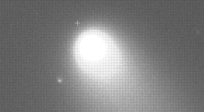

Are these images non-linear? They seem to be according to the history log in PI, but if so it is over-exposed. Probably due to the high gain used, to a certain degree the exposure length but I can't say for sure whether 15s would be to much on a F/2 system or not. The way the comet is looking though I can totally see how you could get a spiked coma by applying HDR techniques, the coma has been saturated too much to get any kind of detail back from the core/nucleus.
If this is the un-stretched (linear) image I'm afraid the nucleus and inner coma is gone:

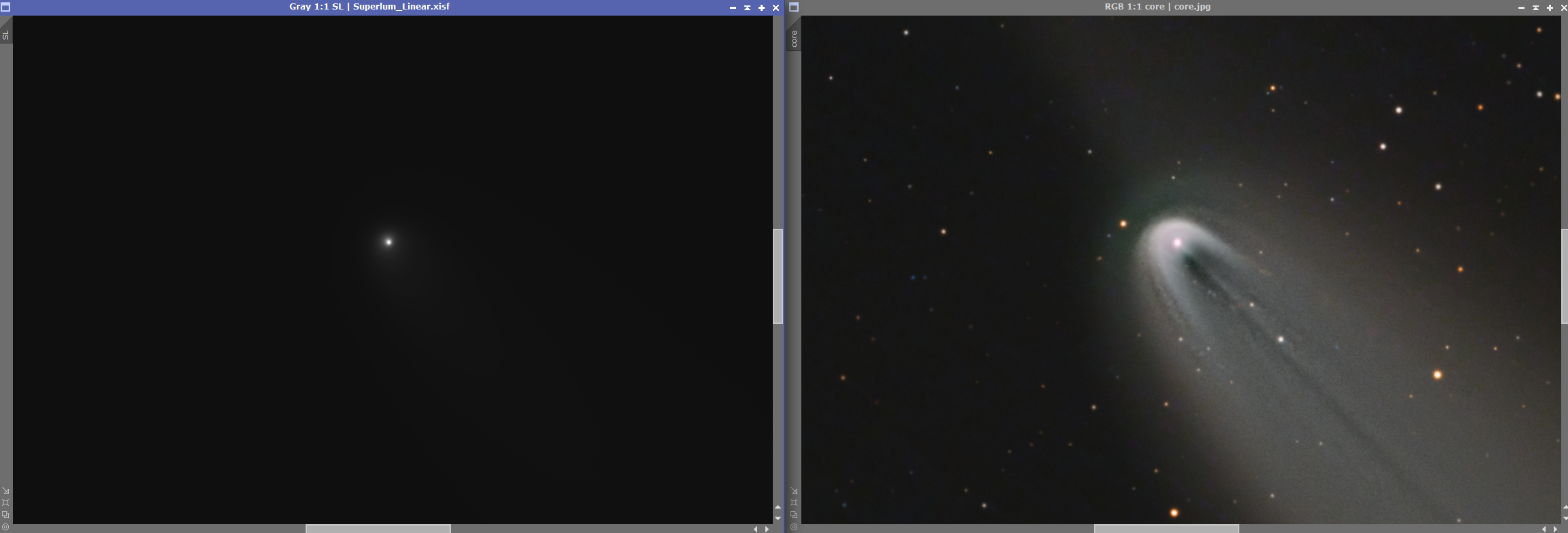

Just as a reference, completely different imaging system aside, here's my linear vs non-linear A3 image from last weekend.
If you notice that the unstretched preview of the individual subs are more stretched than this, while reviewing the histogram on your device, you should probably adjust your gain/exp.length accordingly until only a tiny dot is visible.
I haven't applied any stretch.
This is my second time using the HyperStar and the first comet I try to stack.
I'm still trying to figure out the correct settings. Going from f10 to f2 is quite wild.
I should have reduced the gain - I used 252, as for my other shots at f10.

That's great, single exposures are usually the best when determining certain things. It is definetly blown out:
It will still make a good image, but I would mask off the brightest parts of the comet (coma) if applying the HDR techniques on this image. This way you get the nice jets from the tail section, and can moderately stretch the image so that it looks nice with the anti-tail as well
That is definetly a big change, but using the histogram while imaging can be very helpful in that regard.

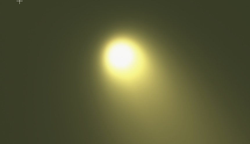

Yes, some mis-collimation is present in the image I would say. Or so it looks like to me at least. But that's not the cause of the issue at hand, nothing more than what BXT can handle somewhat ok. But one cannot repair over exposed stars/cores. You can however work around them a bit, the stars become very white though. Something like this perhaps, a bit of star residue streaking across but not too bad:
Slightly strange looking with that ball of light being very prominent
A bit better IMO with a little less separation of the over-exposed area.
There were some very nasty gradients there though, even after working on the background, especially to the upper left and slightly to the right in the image.

That would explain it, I dealt with the same thing as well and had to discard a lot of frames. I kept some sub-par frames where the clouds didn't interfer with the comet as long as they weren't huge. But WBPP and some careful processing handled it well.
I agree with andrea, these are real details. If the highlights aren't clipped in your subs you might try much less of a stretch to try and bring them out. Much more interesting than the tail in my mind.
JanvalFoto 4.51

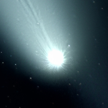

Look above, it's all clipped.
EDIT: This is what happens when you apply wavelets/HDR techniques to clipped areas. None of those details can be attributed as real imho.
