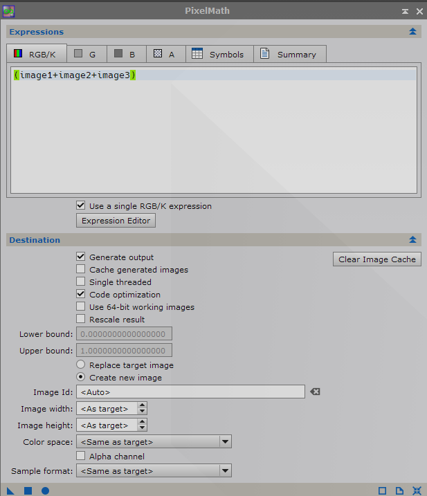

Okay thank you. So use Pixlemath to combine them?
Dave Ek: I think one way you could do that would be to increase the exposure tolerance to a large enough value that all the exposures get lumped together by PI. But I wonder if it's a good idea since their histograms would be quite different. There's probably a better answer that maybe someone else will provide. *** I did increase the tolerance to 200 but still nothing***
Okay thank you. So use Pixlemath to combine them? Yes, that is what you got to do. Use LinearFit on one of them (with the most uniform background) as a reference and apply to the remaining 2 (the must be aligned first, obv). Make sure they are all cropped to the same size so no dark border is exposed.
Okay thank you. So use Pixlemath to combine them? Yes, that is what you got to do. Use LinearFit on one of them (with the most uniform background) as a reference and apply to the remaining 2 (the must be aligned first, obv). Make sure they are all cropped to the same size so no dark border is exposed. *** Can you recommend a YouTube video i can watch to do this? I won't know what I'm doing***

I can't. But I can do it for you if you're willing to share the files. *** I think I know how to do the Linear fit. Just don't know how to add them together as one image in Pixlemath. Like what expression i need to use***
Yeah of course. How do I share the tiff files to you ? I suppose you set up a Google drive and post the link here. Make sure the files are in linear state (no stretching). Also, if you can save the in .xisf format (PI's own) they would have more metadata in them.

*** I think I know how to do the Linear fit. Just don't know how to add them together as one image in Pixlemath. Like what expression i need to use***  |
Yeah of course. How do I share the tiff files to you ? I suppose you set up a Google drive and post the link here. Make sure the files are in linear state (no stretching). Also, if you can save the in .xisf format (PI's own) they would have more metadata in them. *** Thanks again. I have done the Linesr Fit now. I just need to know what expression to write in Pixlemat or what i need to do. If i can't do it I will share files to you. Just want to try first***
 *** Oh thats what i did 😂 because i didn't see any improvement when i added them up together i thought it didn't work***

*** Oh thats what i did 😂 because i didn't see any improvement when i added them up together i thought it didn't work*** Was LinearFit applied before adding them together?

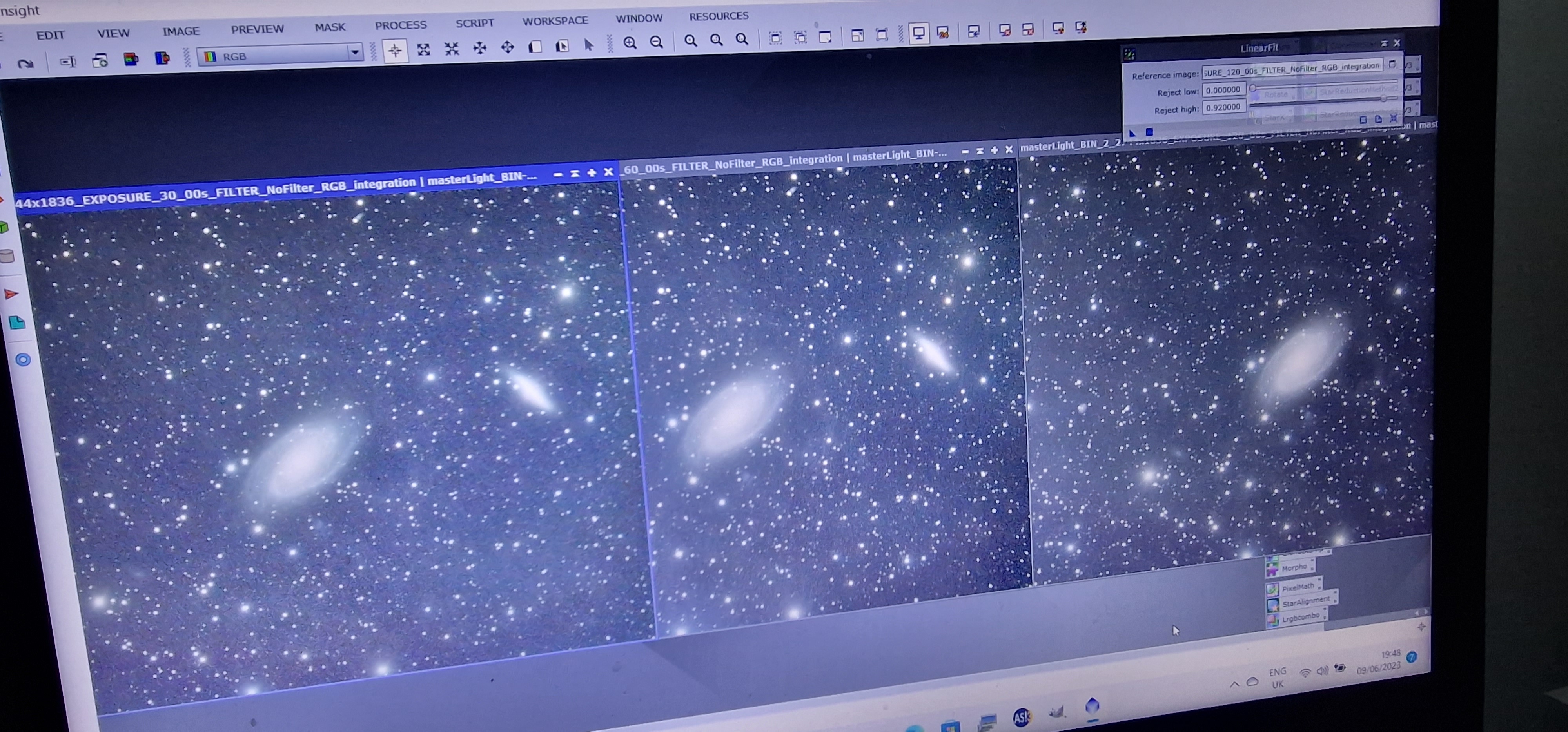

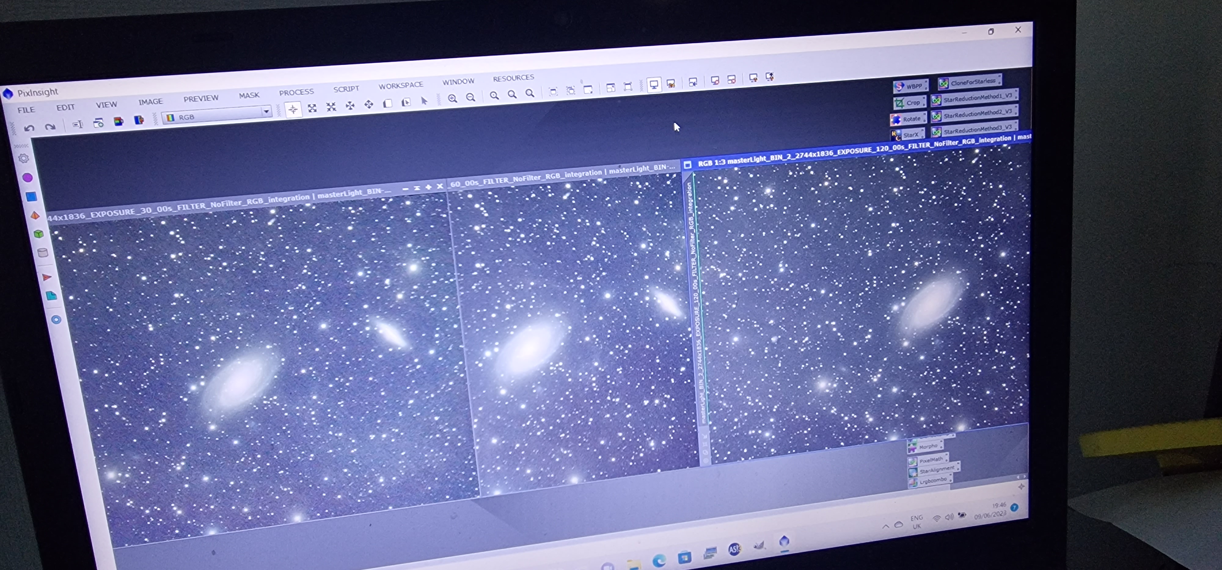

*** Yes it was but I did not see any difference on the images*** That's odd. Can you share snapshots of the relevant images, stretched?
That's odd. Can you share snapshots of the relevant images, stretched? *** Yes,here they are. Only difference is the screen went white on each image and had to use Screentransferfunction. Before and after linear   ***
Unfortunately there isn't much I can see from a screenshot of the screen other that the light frames you're trying to add have quite different backgrounds. What I meant with snapshots is either screen grabs of the 3 actual frames (on at the time) and the resultant sum or the 4 jpeg files of the same, obviously stretched.
