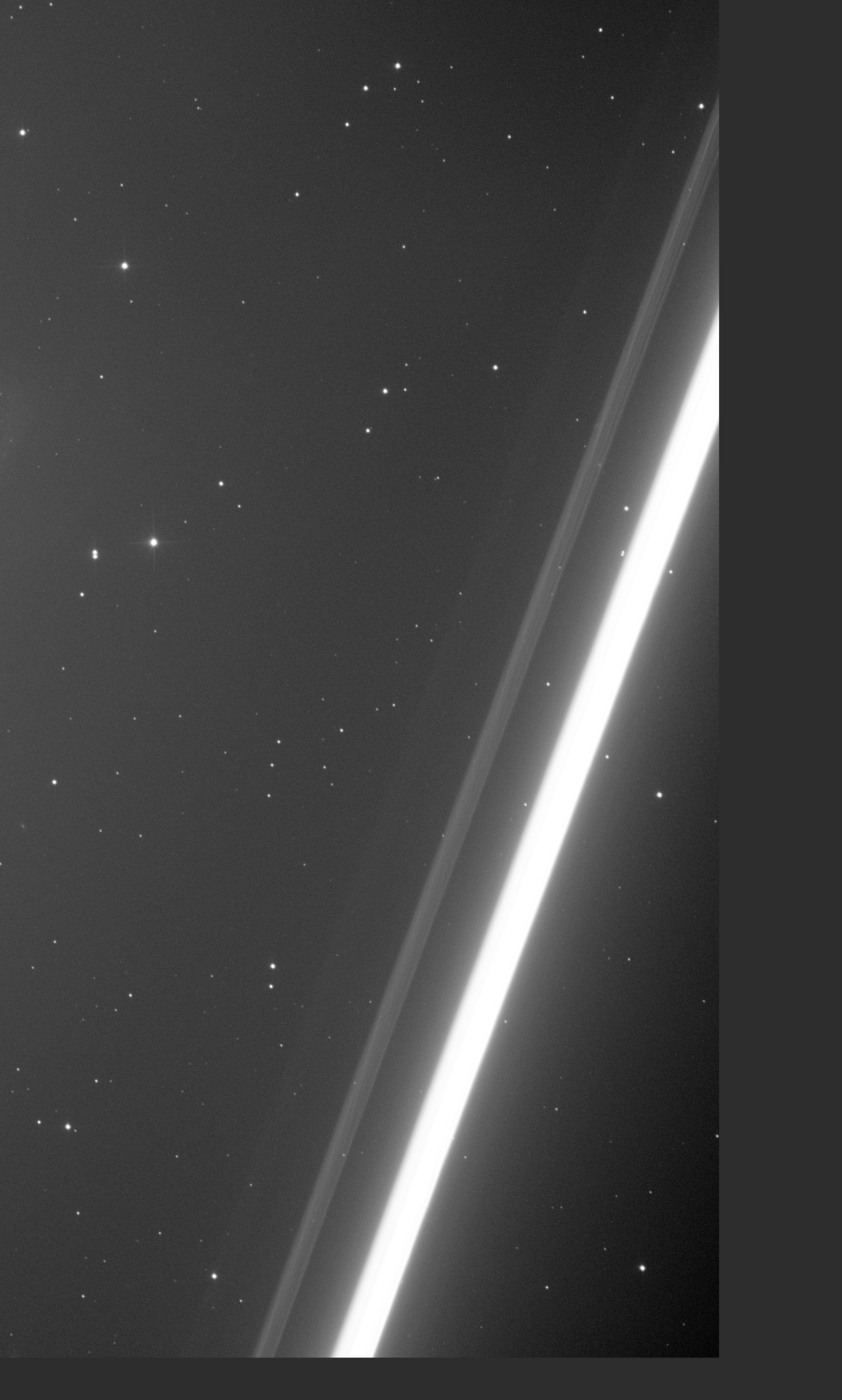

Got this in one of my sub, this is way too wide to be a satelite trail, do you guys think it's a plane? If not what do you think this is?  |
What's your focal length? Looks to me like ISS.
My focal length is 900mm with the reducer, pixel size is 3,76um.
Is there a place a could check the iss position?
Thanks
Médéric Hébert: Is there a place a could check the iss position? Heavens-Above |
Bob Lockwood:
Heavens-Above Thank you, with that I can say for sure it wasn't the ISS
Médéric Hébert:
Bob Lockwood:
Heavens-Above Thank you, with that I can say for sure it wasn't the ISS How about Tiangong? Not sure if there is a tracker for that. Planes always take up more of my FOV at your focal length. Edit: Found a tracker that includes Tiangong. https://www.astroviewer.net/iss/en/observation-css.php |
In short, if it's not the ISS it could be anything. The Goodyear blimp, a plane, a drone, a UAP…
Tony Gondola: In short, if it's not the ISS it could be anything. The Goodyear blimp, a plane, a drone, a UAP... I'll go with the Goodyear blimp XD Ian McIntyre: How about Tiangong? Not sure if there is a tracker for that. Planes always take up more of my FOV at your focal length Too far South to be Tiangong, especially since I was pointing North. There's the local airport not that far away and it's only for smallish planes so maybe on of those Thank you all for the suggestions!

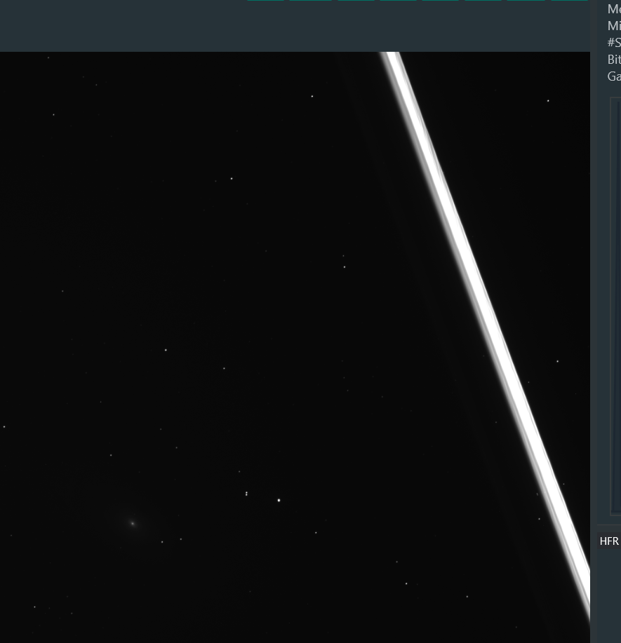

Jon Main: Could be a meteor. Could be, that would explain why it's tapering a little, it heated up on entry. It also doesn't look like the plane in the CN thread posted earlier. Here's what it looks like stretched  |
Here's a meteor that passed through my frame a few months ago: https://www.astrobin.com/dg7cej/ |
Jon Main: Here's a meteor that passed through my frame a few months ago: https://www.astrobin.com/dg7cej/ That's a really interesting sequence. I don't think I've seen anything like that. A truly lucky image!
Jon Main: Here's a meteor that passed through my frame a few months ago: https://www.astrobin.com/dg7cej/ This looks a lot like what I got! Let's found the 'we got a meteor shot in a frame' group  |
Médéric Hébert (sgthebert)
Jon Main:
Here's what it looks like stretched OK, I'm going to have to run through some of my frames that I was certain was one of the large station goin through. You can really get a sense of what is happening in the stretched image with the dimmer trail. There is a filamentary, almost twisted helical appearance to it that would indicate the trailing of multiple small objects than one solid object; as in a piece that is broken from the main object and in a further state of decomposition. Very interesting.
