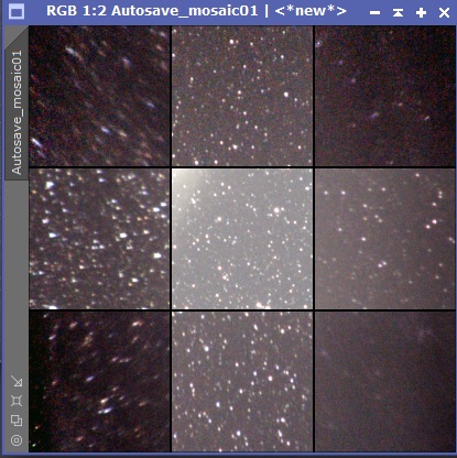

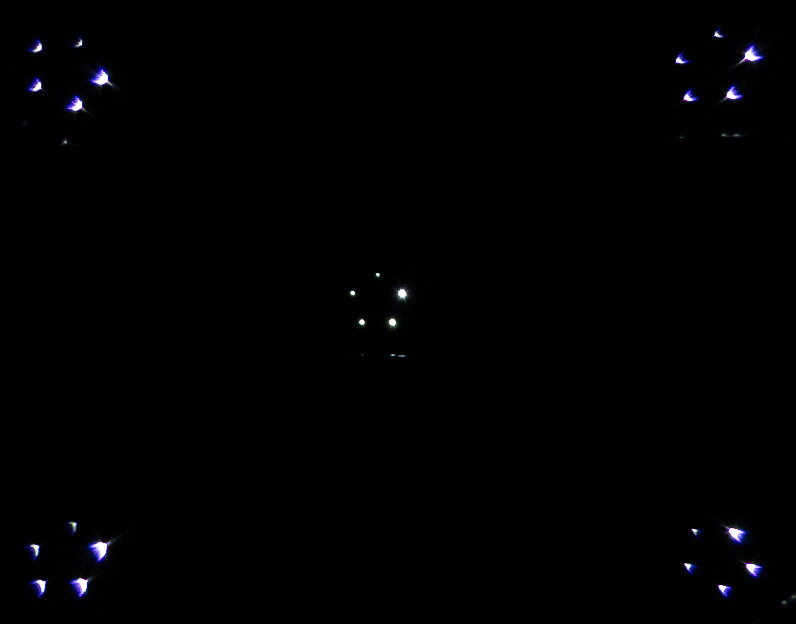

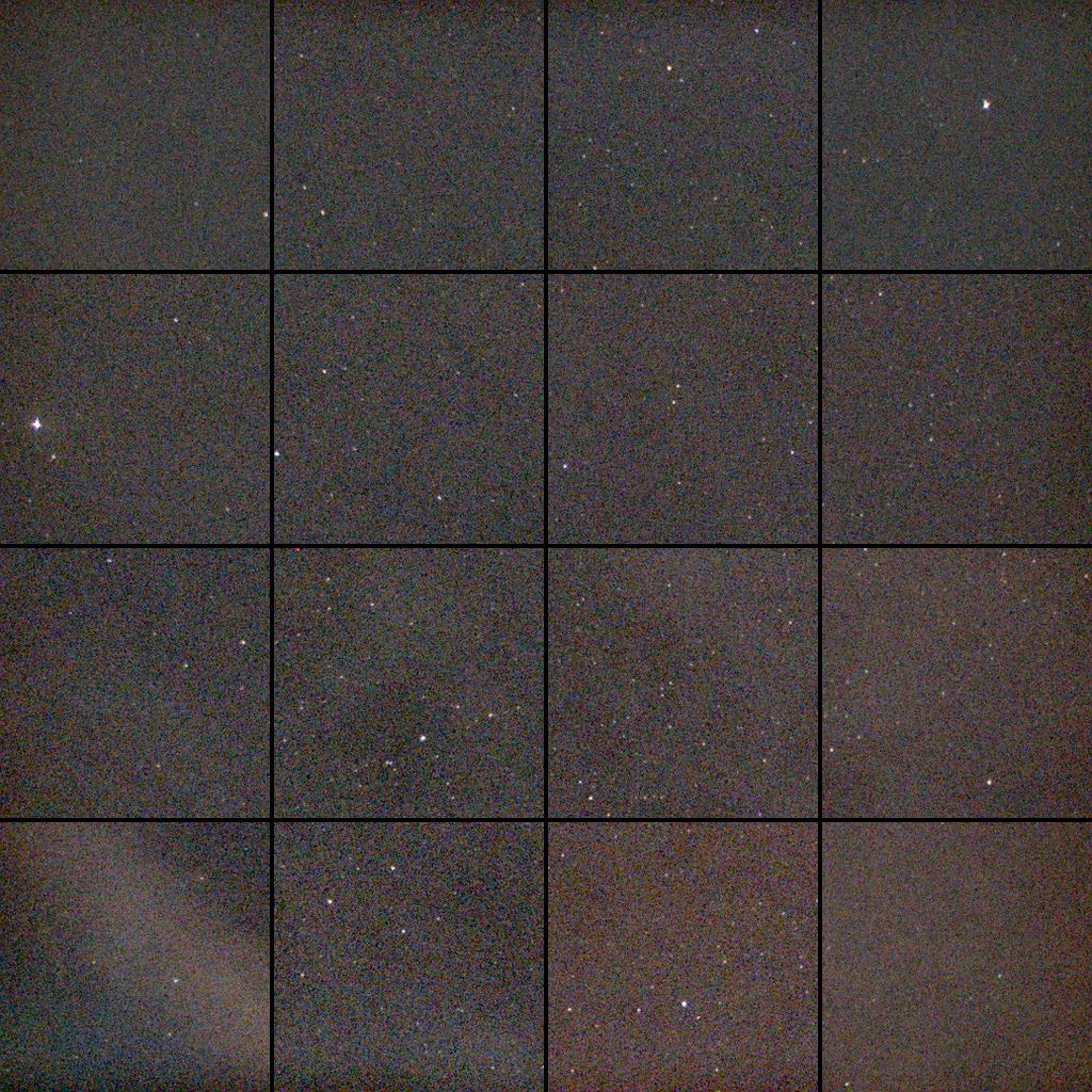

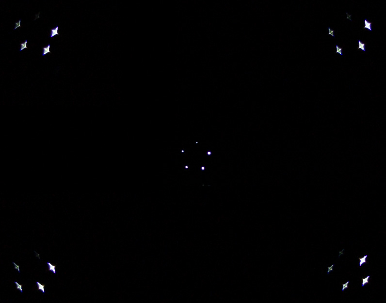

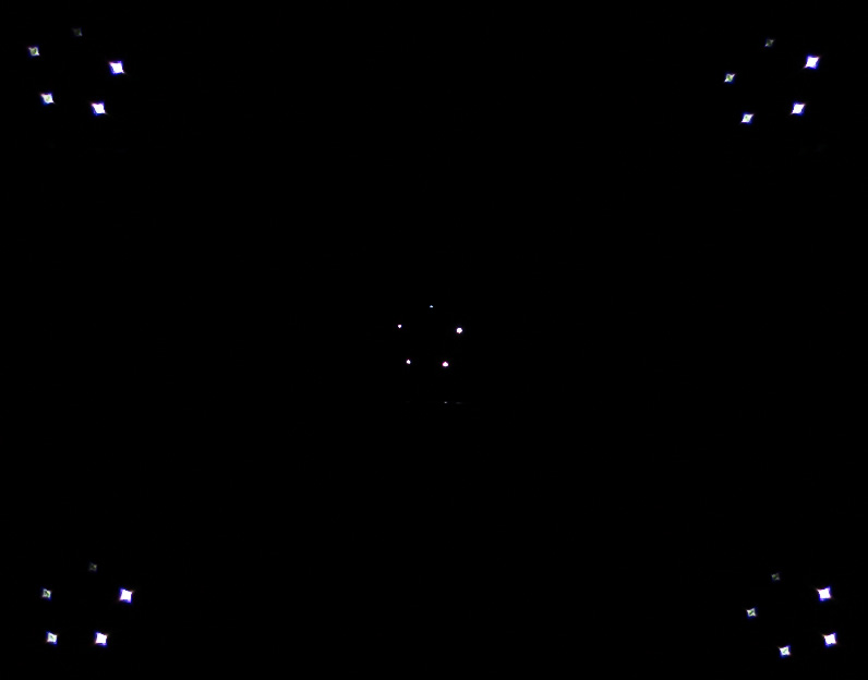

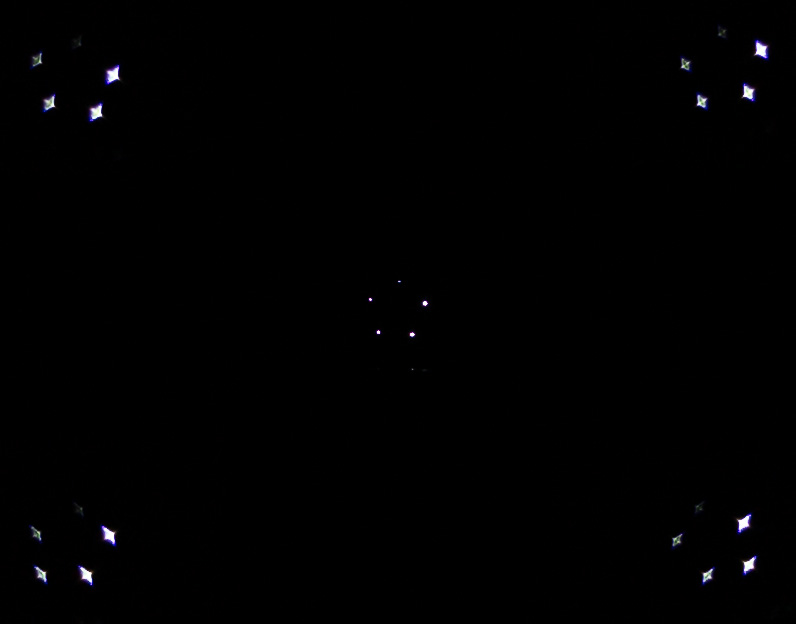

I just got the above lens and have done some artificial star testing and I dont know if the lens has issues.
It is clear my artificial star test is greatly exagerating aberations, but I am concerned the sigma is showing a higher level of aberation than it should?
The below images are of my EF24-105 F4. The first is an actual image followed by an artificial star test. Camera is either a 6D or R8.
Now the Sigma at F1.4, F2 and F2.8

i do not own a Sigma 28mm 1.4 Art. But I own a Canon 24mm 1.4 L and used it last autumn (fall?) for some shots of the milky way while I was in vacation. I can tell, that the stars in the corners looked nearly the same as yours. As you can see in your sample shots, the abberation gets better when stopping down the lens. This is exactly what I experienced back then. So I guess, your lens is behaving quite as usual. Those wide angle lenses usually have their problems at those high aperture settings and are quite soft in the corners as well. I know, the Sigma lens may be newer and maybe even better than the Canon one, but I assume, my lens is not that bad at all.
You have to remember, that you are using your lens with the focus at the infinity setting. But a wide angle lens might be used with some subjects in the foreground with the focus set to some nearer distance. I assume, this is the distance the lens designers optimzed the optics for. The infinity setting might be a compromise here. With telescopes, you have other use cases and optimization might be much easier assuming you only use the lenses at infinity.
I might be wrong on this, but in general there should be some truth in my words.

It looks fairly typical for FF with a fast lens, discouraging as that may be. On the bright side, it doesn’t look like you have decentering.
It should be performing decently at f/5.6 and with an APS-C at around f/4. And yes, there are better lens out there.

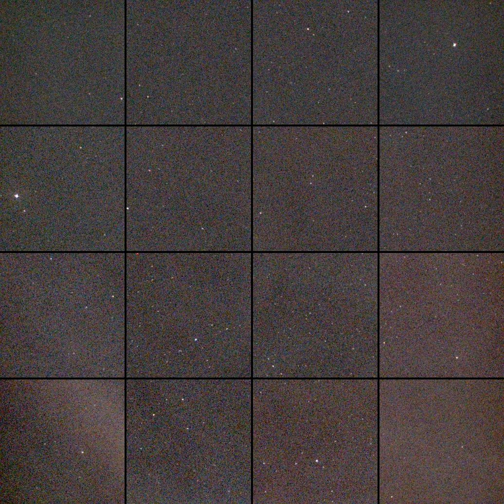

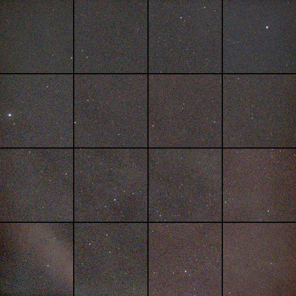

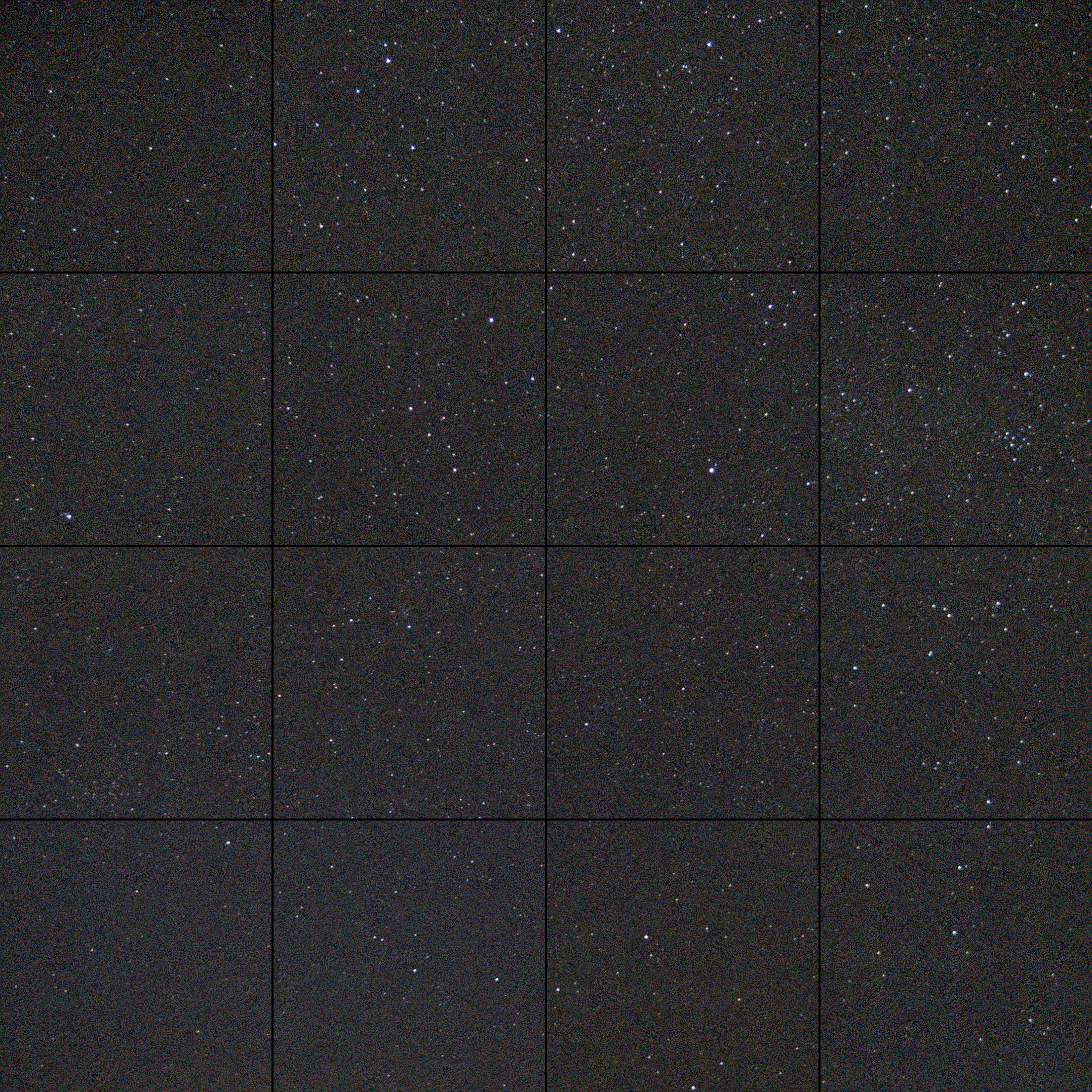

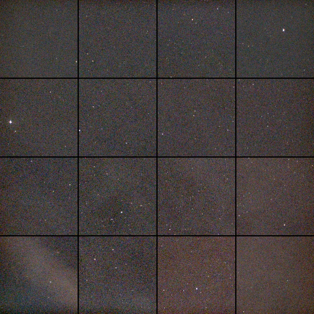

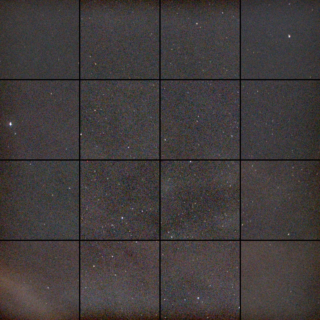

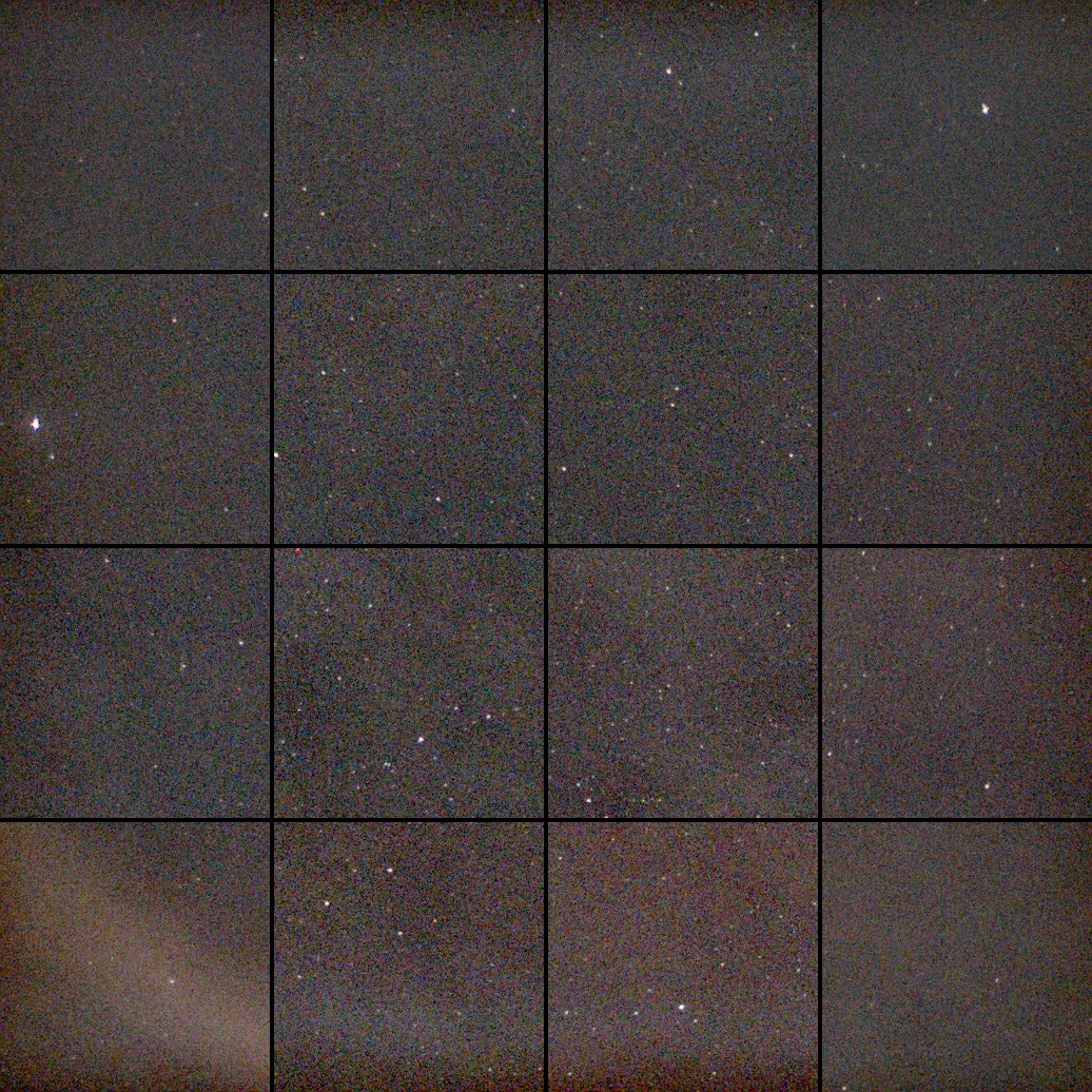

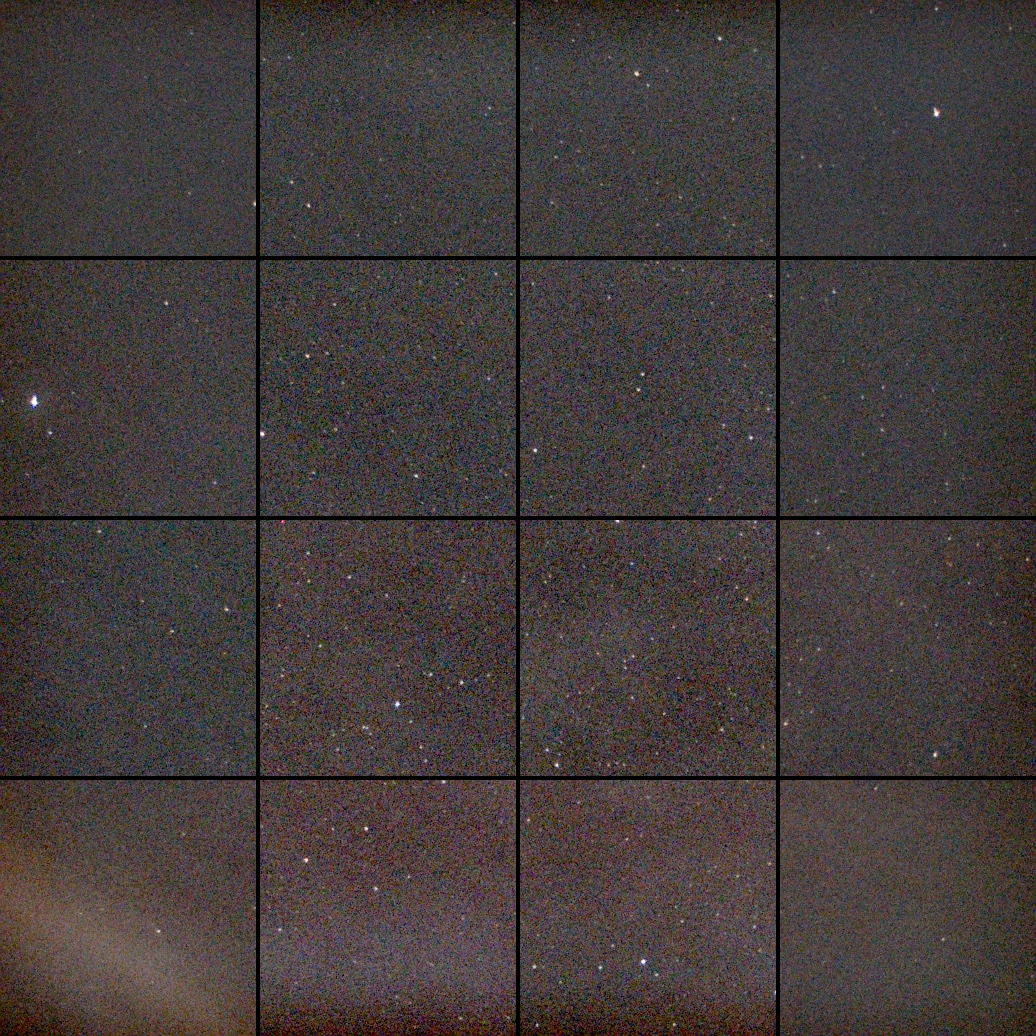

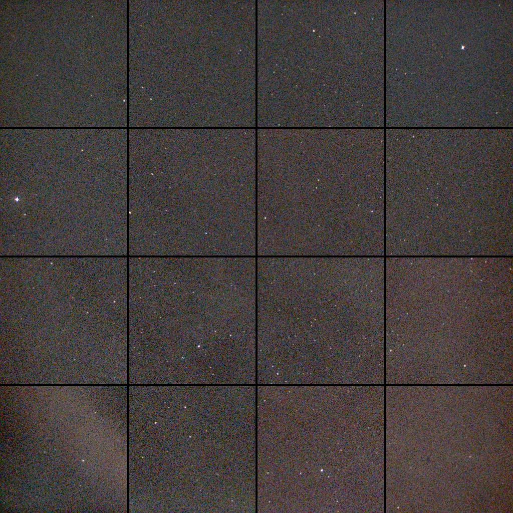

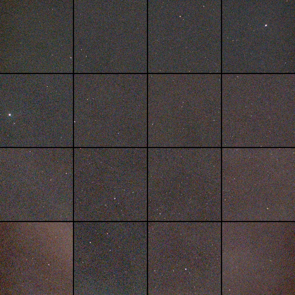

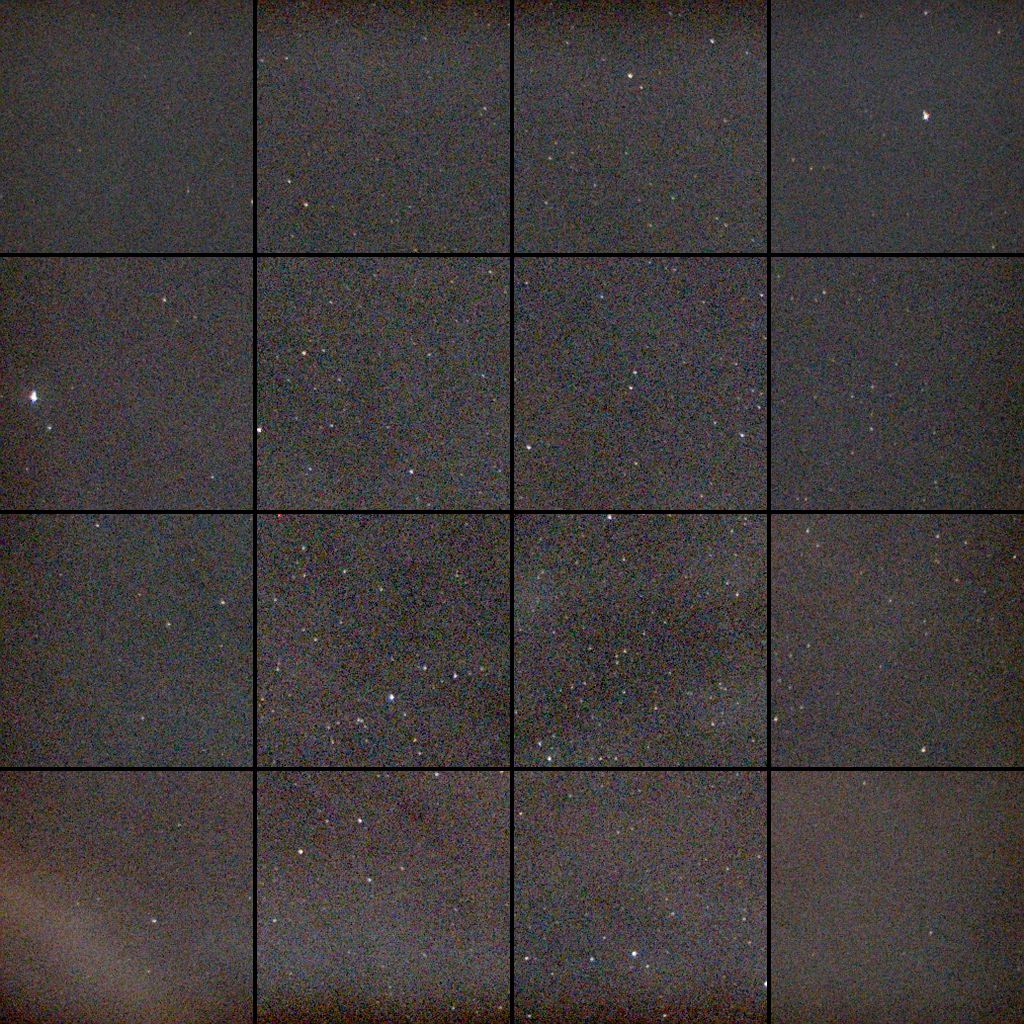

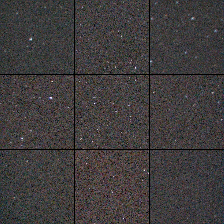

I took some test exposures last night although it wasnt properly dark. It looks much better on real stars. The below range from F1.4 to F2.8
