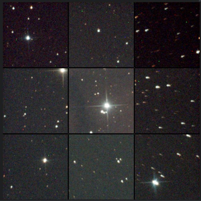

Hello community from Astrobin: I have a question that I hope you can answer. Recently I bought a Newtonian reflector (GSO 200/800 F4) and before that I had a coma corrector Baader MPCC Mark III. I run a test to see if there is any problem with the equipment and the adquisition. I've noticed that in the right side of my lights there is a sort of "coma" but in the left side there is none, or almost nothing. I've attached an image so you can see the problem. I initially thought that it might be pitched optics or bad collimation, but I ask to this community if there is something else that I should consider. Thanks in advance and clear skies!  |
In my experience is this a collimation problem. The Collimation must be very accurate at F4. What do you use for collimation?
CS Haakon
The Baader MPC III isn't terribly good at f/4, am afraid. Tried it and ditched for a Sharpstar CC. What you see in your image is tilt toward the right hand side of the image which needs to be corrected in order to achieve a uniform a field as possible. You'll be still left with some at the edges but maybe you can live with it.
Collimation and/or tilt. Tilt is tricky to diagnose unless the collimation is always spot on. The Baader MPC III isn't great on fast scopes (F5 or slower is preferable) but that's not your problem here.
can confirm andrea's experience with the MPCC, the baader corrector is simply incapable of proper correction below F5. ditched for a ts optics paracorr 0.95x and got much better results.
Ive had a huge problem with tilt causing by the locking screws and the the bracket holing the coma corector. I installed the baader click lock, checked the woring distance mm exact and collimation. It was gone. Ive heard the baader mark 3 is very sensitve to tilt on the focuser
Yeah, if there's coma on side of the image, it could be that something—an accessory on your focuser or your focuser—was tilted a little. Like it was maybe a little wobbly.
Marc Fischer: Ive had a huge problem with tilt causing by the locking screws and the the bracket holing the coma corector. I installed the baader click lock, checked the woring distance mm exact and collimation. It was gone. Ive heard the baader mark 3 is very sensitve to tilt on the focuser Before I switched to a threaded connection (feathertouch 3" focuser), I would also have tilt issues using the locking screws. Coma correctors in general compound errors so the tolerance decreases more that if you didn't have a coma corrector.
Tilt, collimation and probably some backfocus issues. However, even if you fix all these, you will see noticeable "mushroom" shaped stars and spherical aberration at f/4. Try mpcc from SkyWatcher or Paracorr. Even a cheaper Shaprstar 0.95x can provide better stars than baader's mpcc…..
Jingquan Yan: Tilt, collimation and probably some backfocus issues. However, even if you fix all these, you will see noticeable "mushroom" shaped stars and spherical aberration at f/4. Try mpcc from SkyWatcher or Paracorr. Even a cheaper Shaprstar 0.95x can provide better stars than baader's mpcc..... I hope you are not saying the Baader is not good, because I already preordered mine a few weeks ago for my F/5 newt. I don't have any coma corrector yet.
I hope you are not saying the Baader is not good, because I already preordered mine a few weeks ago for my F/5 newt. I don't have any coma corrector yet. It will work at f/5 up to 22-24mm diameter. It will stil introduce spherical but I suspect not as noticeably as at f/4. AFAIK, only the Paracorr type II does not.
