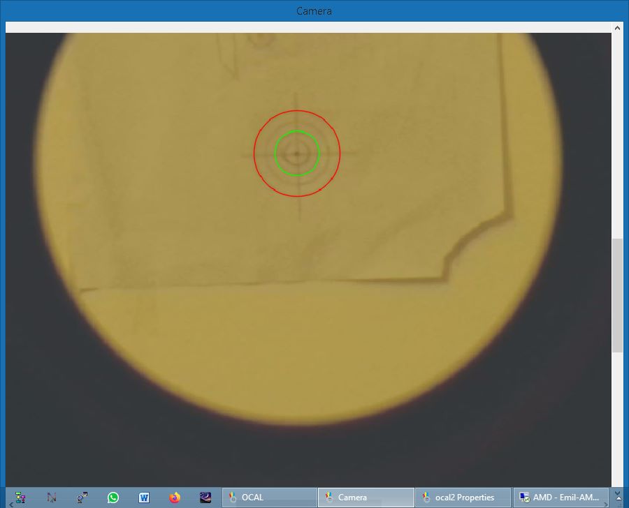

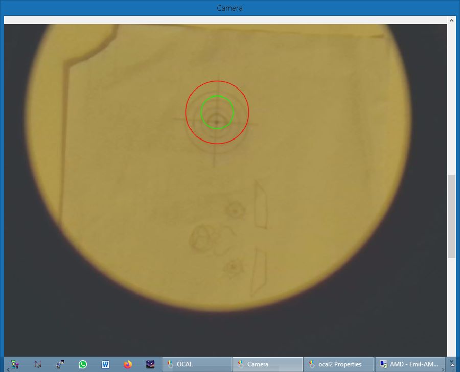

I though I had a problem with the focuser too but I just tested the ocal and there's a massive tilt on the sensor.
Here's how it looks rotated at 180°

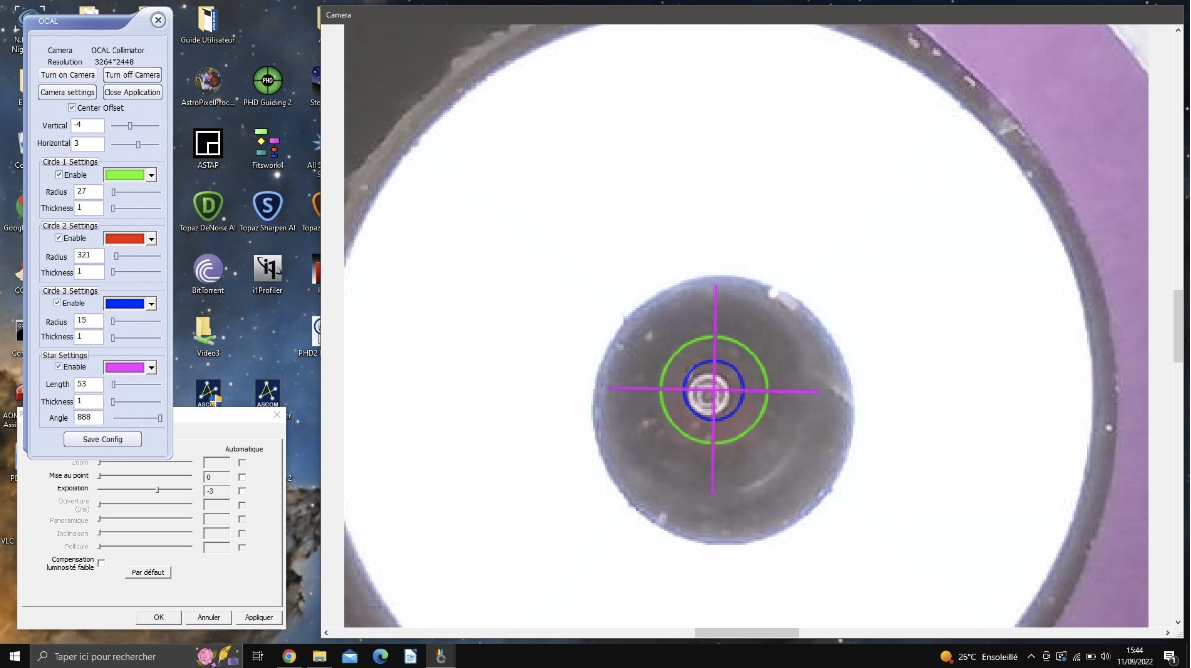

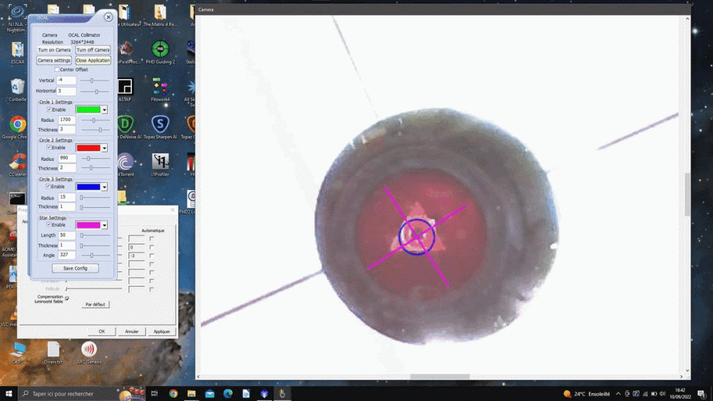

First : the Ocal comes with a serial number that need to be used for getting seetings that are when the software is launched, did you use the right values ?

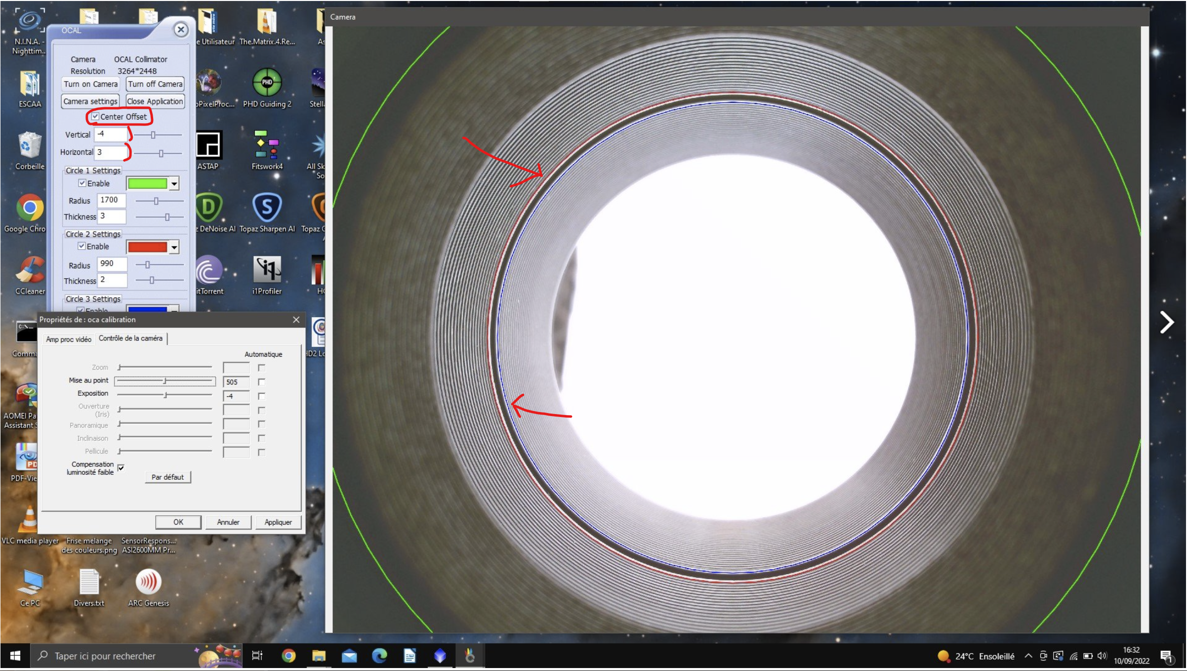

Second: if you want to get a better tuning of the "ocal center" you can use insert a M42 tube end use this a reference for the calibration of the center of the OCAL with the "Center Offset" feature
in the screen shot here under, I found that with -4 Vertical and 3 Horizontal, the rings are properly and better  centered, you can see the internal thread of the M42 tube :
The OCAL is so accurate that you can see the differences that comes when you change something at the focuser level, the main reason for that is the accuracy of the "focuser axis", it is normal to see a difference after a rotation,
