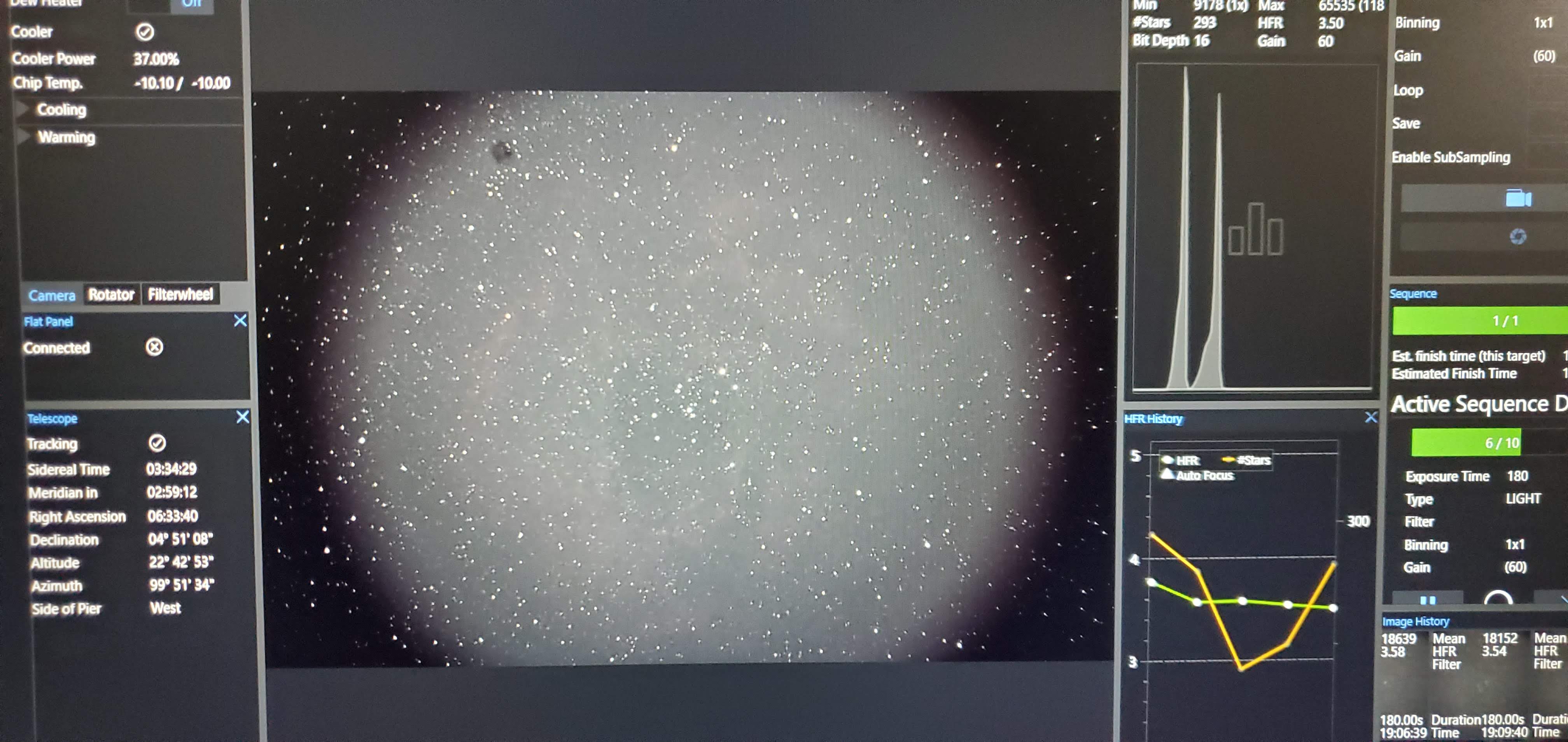

Have a new Rasa 11 v2 with a ASI2600MC pro.
All the images I have taken look like this!
The center is much brighter then the edges. I have adjusted the gain, changed filters, tried different exposure times but nothing!
Any help would be greatly appreciated

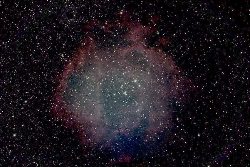

mxpwr 7.29
Say hello to Mr. Vignetting.

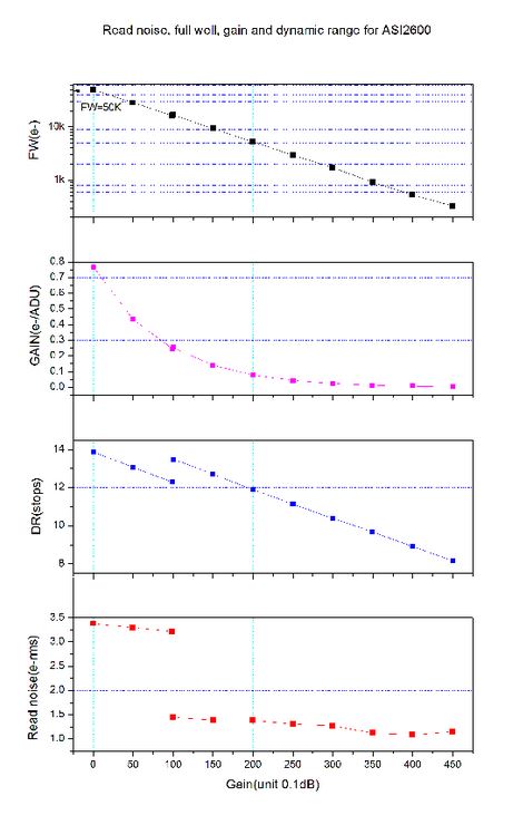

dmsummers 6.80
Sorry...the specs link I gave didn't do what I intended.   Here's the graph of interest showing the gain step:

I see two big problems in the image that you posted.
1) As others have pointed out, you have very significant vignetting.  The RASA 11 is designed to cover a 42 mm image circle and you are using a camera with a APS-C sensor with a significantly smaller sensor so I’m not sure why your image shows so much vignetting.  The RASA may have some vignetting over that sensor, but not like what you are showing.  How do you have the camera attached to the telescope?  It sure looks to me like your adapter may be too small in diameter.  The beam from the RASA is very fast and it sure looks to me like you are seriously clipping the marginal rays at the edge of the field. Remember that to eliminate vignetting, you have to pass the sum of the marginal and chief ray heights throughout the system.
2) I see significant stray reflections that appear to be coming from the inside of the camera adapter.  Stray reflections like this will completely screw up image calibration.  Remember that vignetting modulates (by multiplication) the image irradiance distribution.  Therefore, to remove the effects of vignetting, the calibration process divides out the flat data to calibrate the image.  Any additive signals coming from stray reflections will not be removed during the calibration process and worse, they may disrupt the normalization process needed to properly scale the calibration process.  The best way to look for stray light is to remove the camera and to look backwards through the system.  That’s hard to do with a RASA system so you might just start by pulling things apart and either painting everything on the inside of your adapters with ultra black paint or covering everything with ultra black flock paper.  Strays coming from the inside of an adapters is always aggravated when the adapter diameter is too small, which fits with my feeling that you might be using an adapter that is too small.  I didn't look at how far recessed the sensor is inside of your camera but you should also consider the size of the opening in the camera housing as a potential source of vignetting and/or strays.
I want to add that in general, the problems that I see in your data have nothing to do with the camera settings.

is the image you posted calibrated or not?
The reason why I am asking: plain vignetting (which is to be expected with the 48mm connection) would explain a bright center and getting darker towards the edges
Your image seems to have a ring where the center is bright, the ring is even brighter and then it quickly falls off towards the edges.
So it cannot be just vignetting, probably something is wrong with your calibration routine or your calibration frames.
Do you also see the ring (with the slightly darker center) in the single light frames?

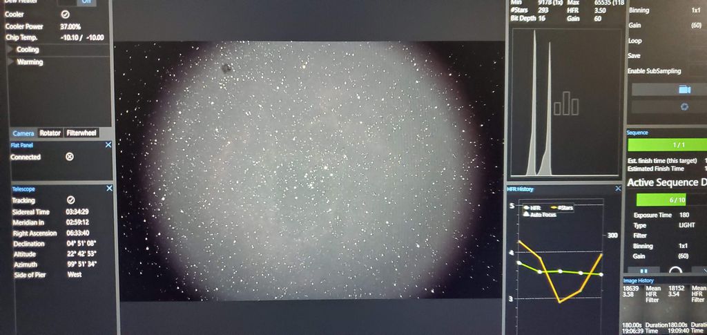

Starlord85
Here is a picture i took with my phone of a single image. The second ring is not there.  The dark spot at the top left was dust on the sensor it self! That was fun clearing off.....
I have the ZWO filter drawer directly on the camera then 48mm all the way to the plate that came with the rasa.

rayp 4.52
Hi Nathan, that frame looks as can be expected with your setup, the ufc system will greatly reduce the vignetting.
So this narrows the problem down to an error in your calbration routine or frames. Did you by any chane take your flats with a significantly changed focus?
