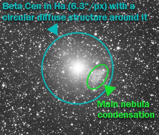

I'm having trouble finding any references in the literature for the structures I'm seeing on the Ha and SII exposures of Beta Cen (Hadar) on the wide angle panorama of the region [1]
[1] https://www.astrobin.com/gcqtmj/

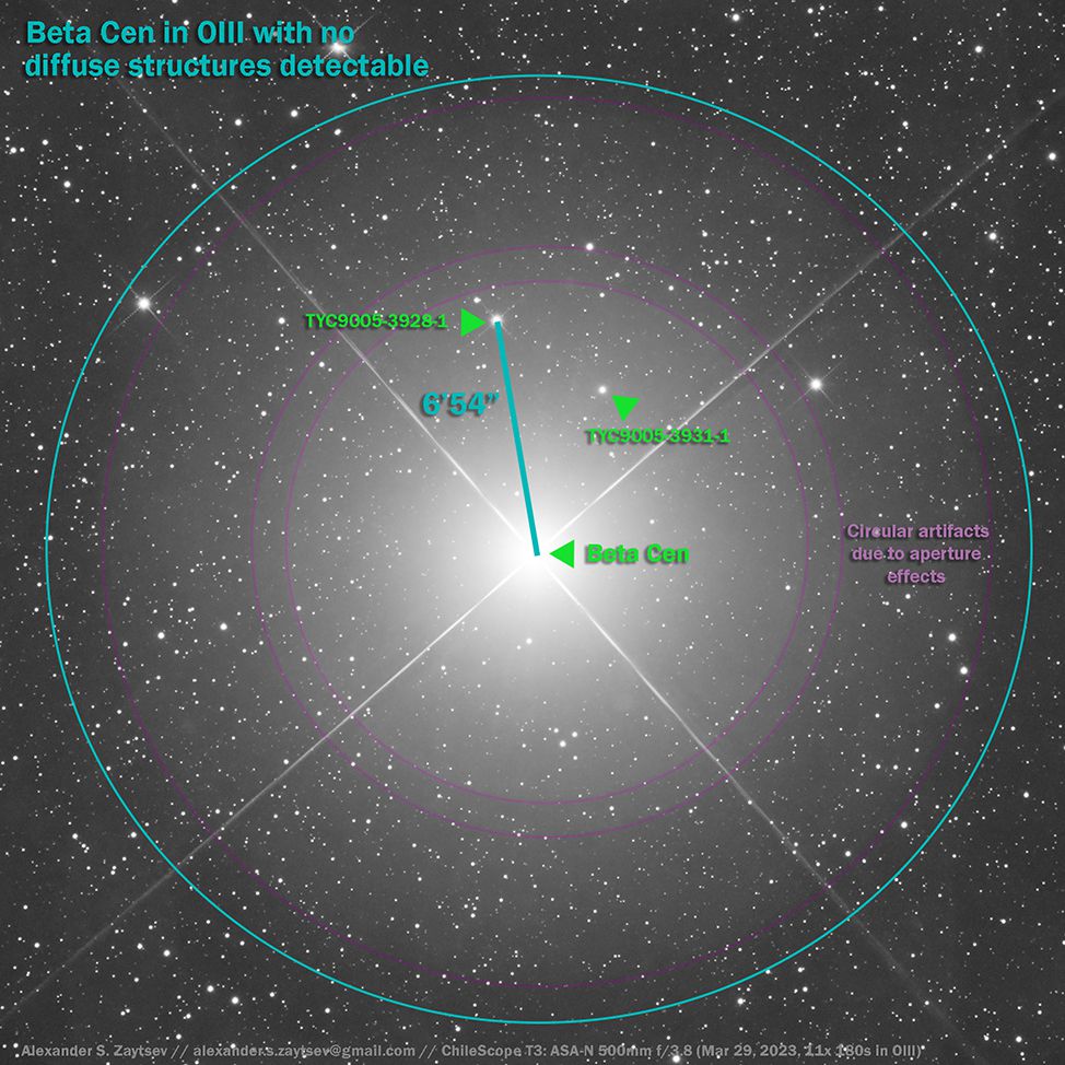

Both features turn out to be complex structures upon a close look in Ha (most prominent) and SII (some parts of the main condensation still visible), but not in OIII (in which the light from the main star getting trough the filter is the strongest) [2, 3]:
[2] https://www.astrobin.com/ojtcmx/C/
[3] https://www.astrobin.com/8gpw0u/
The annotated Ha exposure from [2] is given below:
The annotated SII exposure from [2] is given below:
The annotated OIII exposure from [2] serving the purpose of understanding the light scattering patterns in the scene is given below:
If anyone knows catalog numbers for any of these diffuse structures, or imaged them before, or seen them referenced in some publications, could you please let me know?

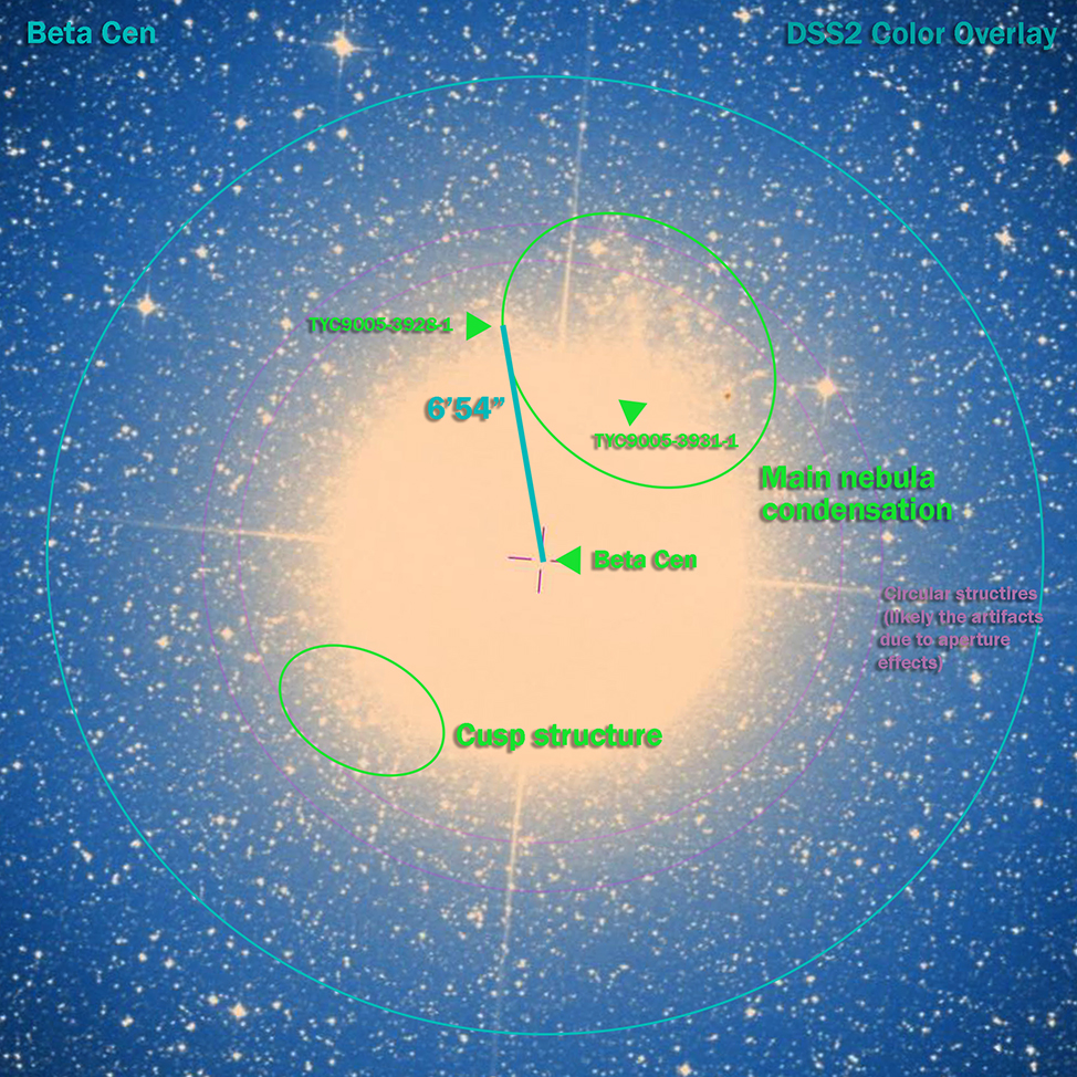

Note that there is a hint of this structure on DSS2 color survey but since the central star is so overexposed there it can be easily mistaken as some sort of optical artifact:
The DSS2 Color image as an aligned overlay for Ha exposure from [2] is give below, it is unmistakably the hint of the same structure:

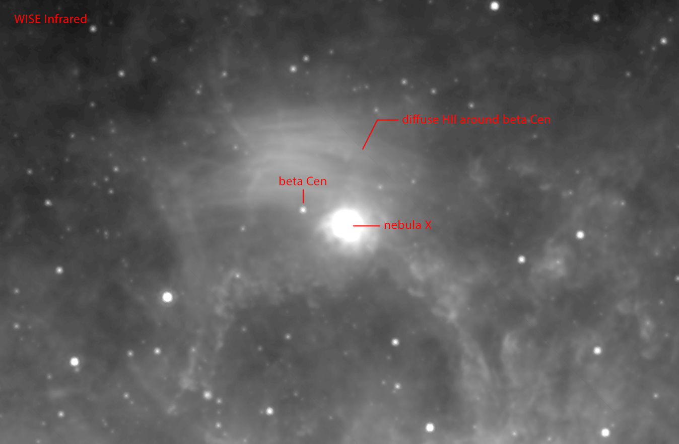

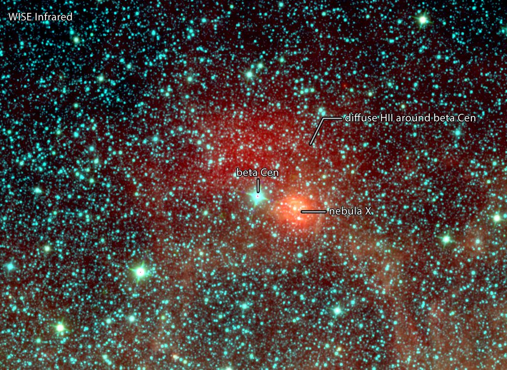

The best representation of this process is provided by the infrared data from the WISE satellite:
Interesting here that there is a very strong, infrared source at about four o'clock of Beta Centauri, which coincides with the position of your "nebula X".

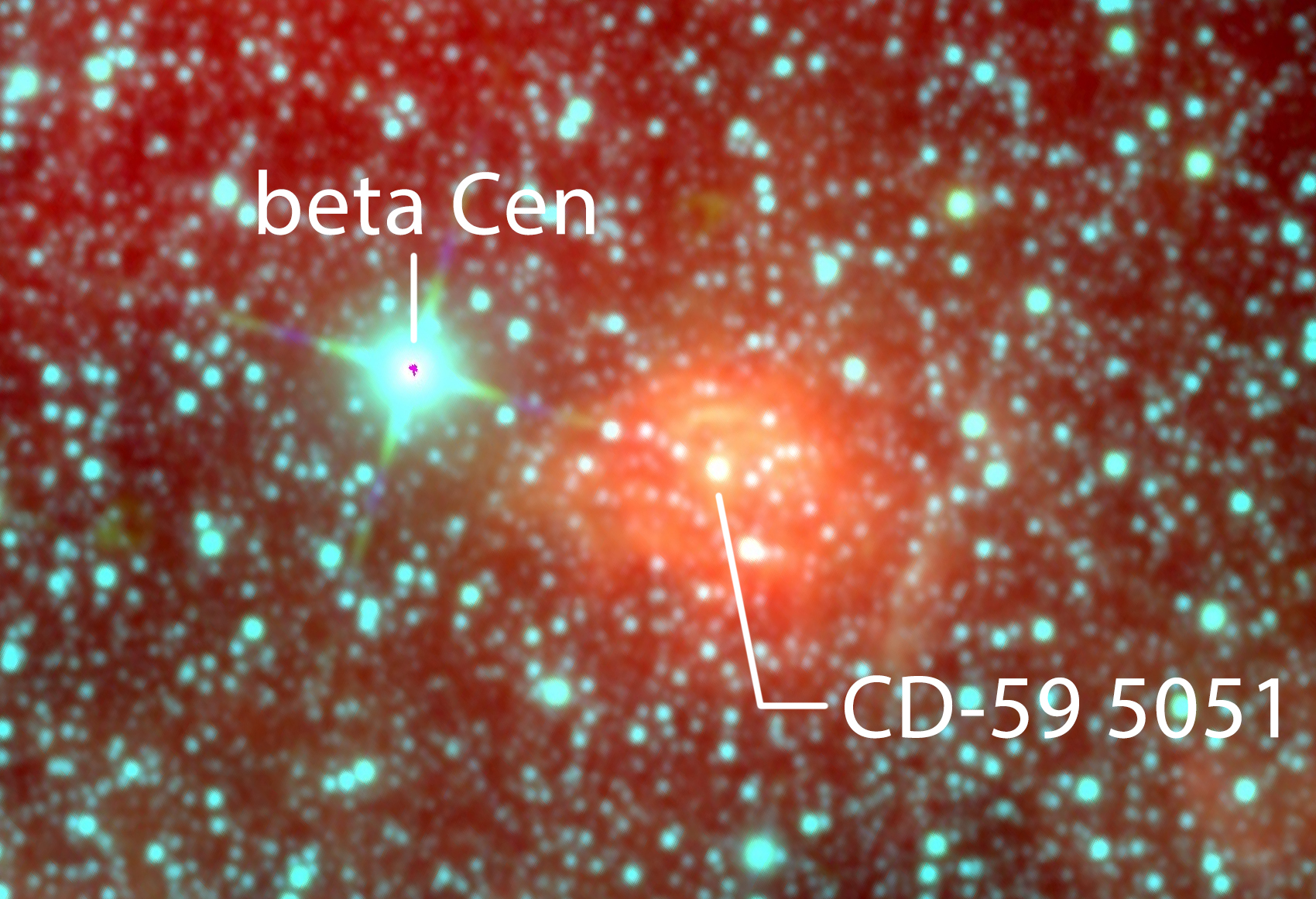

Here is a false-colour representation of various infrared bands:​​​​​​​
If we take a closer look at the small, extremely bright nebula beyond beta Cen, we notice that there is a small star right in its centre, around which fine arc segments also extend. This star is most likely the source of your nebula.
A look at the star's data also reveals why the nebula is so bright and conspicuous. The star is a real monster - a star of the spectral class OB+e and thus much hotter than beta Cen itself with a surface temperature of over 44000 Kelvin.​​​​​​​
Here is a high-resolution image of CD-59 5051 (Vista survey).
The distance data from Gaia to both stars are fairly accurate:
Distance beta Cen: 120 parsecs
Distance CD-59 5051: 2850 parsecs
Your nebula is therefore far behind beta Cen and has no physical connection to it.
But the interesting thing for you should be that I could not find any official reference to this small nebula, which I would call "ionised interstellar material". Also, your H-alpha image is the first to show this nebula in its entirety - congratulations!
Hi @Marcel Drechsler !
Thanks a lot for looking into this, and I knew you would know where to look precisely to find it in the surveys! I had no idea that WISE survey is such a high resolution guide to the Ha structures of all kinds. (I shall be using it regularly from now on "in search of the place where to dig"  Vista survey looks pretty useful too.)
The "main condensation" ("nebula X") sure looks mighty impressive in the infrared especially at 2.9 kpc distance!
I did suspect that the circular structure at about 7'-11' radius from Beta Cen might be actually physically associated with it, but the "nebula X" could be and overlap or something from a distant background, and the CD-59 5051 (TYC9005-3931-1) star might be the host star for that nebula - thanks for confirming it.

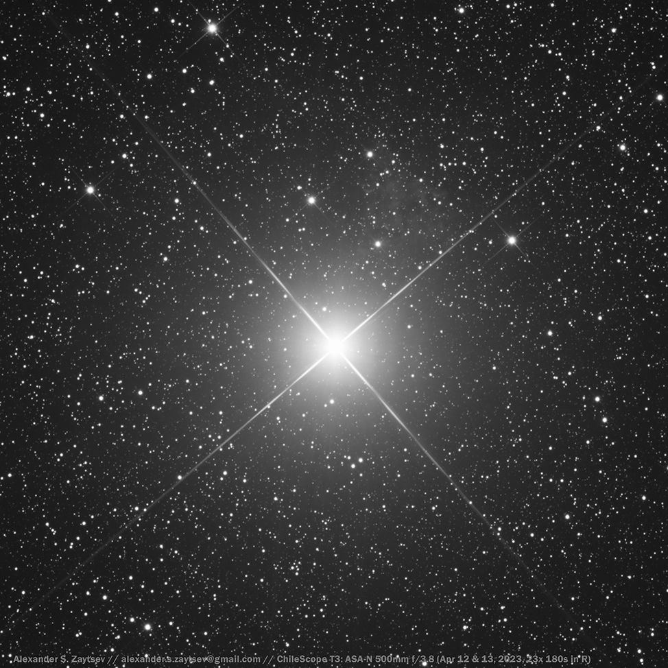

It turns out the traces of these nebulae (at least the main condensation / Nebula X) are actually visible in RGB, but only in the R channel, and with > 1h integral exposure:
Now also published under
[1] https://www.astrobin.com/ojtcmx/L/
[2] https://www.astrobin.com/ojtcmx/M/
So, the potential for performing the meaningful continuum subtraction for Ha increases

Just for the record, more Ha and OIII data was obtained for the Beta Cen and associated "Ghost of Hadar" nebula in April using Riccardi-Honders RH200 D = 200mm f/3 (Telescope #5) of Chilescope, with which a successful redirection of the outer part of scattered light halo was moved away from the main scene by placing it off axis of the FOV [3], [4]:
[3] https://www.astrobin.com/mlnenb/B/
[4] https://www.astrobin.com/mlnenb/F/
[5] https://www.astrobin.com/mlnenb/E/
No additional structure releveled by these wide FOV images, yet a fair amount of details visible on these as well, and even a hint of a "cusp" structure on the opposite side of Beta Cen from the "Ghost" nebula is visible in [5].
