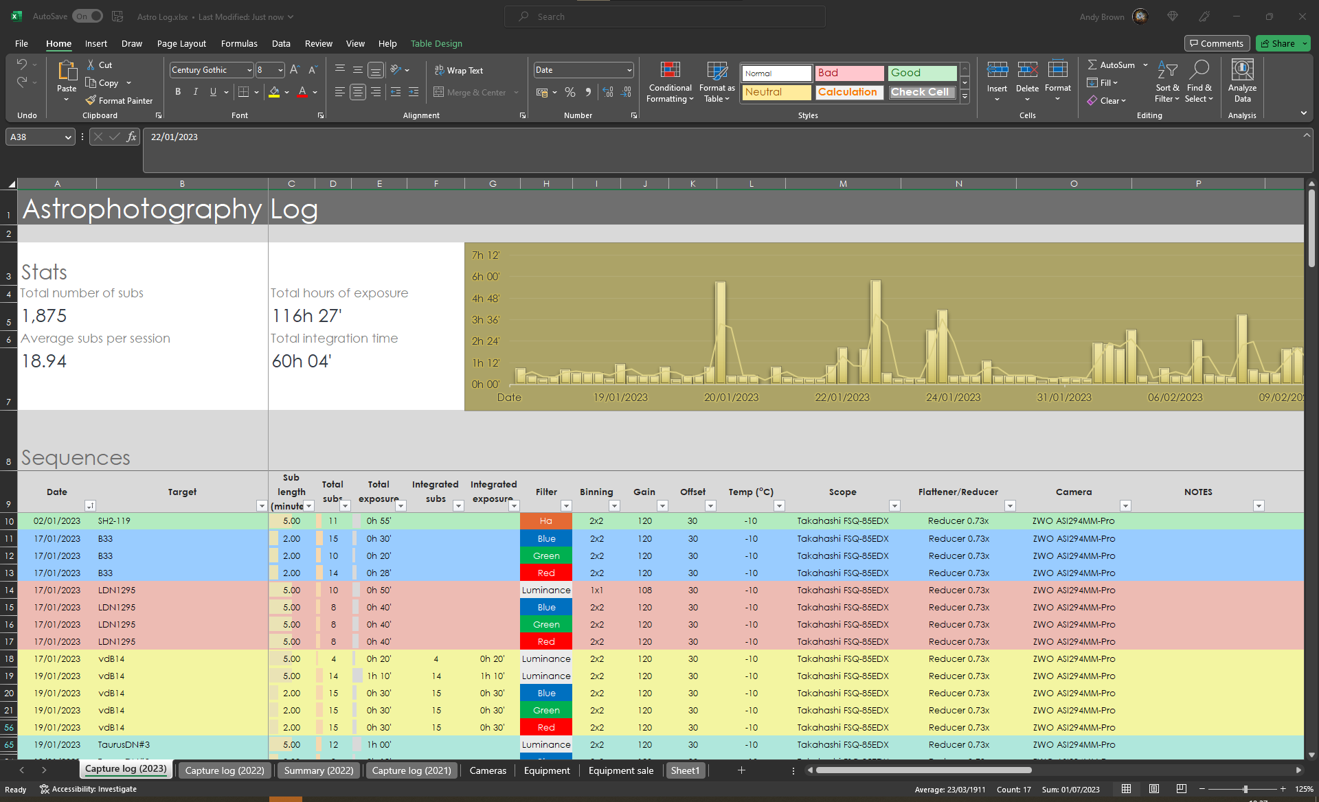

Hi Daniel,
I keep a record of all my sessions in an Excel table (see below). I can filter by each column so, for example, select a specific target and filter to show how many subs and total exposure time. This is indispensible, especially if combining old and new data. I record Darks, Flats and Dark Flats in here too so I can see which sets of calibration frames correspond to which sessions.

Daniel,
This is a great post! After seeing the @Andy Brown spreadsheet I realize that I should start keeping a log. I have a lot of equipment. Lots of clouds and too many days in between imaging sessions.
I hate to ask, Andy would you share this spreadsheet to the Excel challenged members of the Astrobin community?

Hi Tim/Daniel,
I'm more than happy to share this, no problem. I'll create an example template version and upload it to my OneDrive and post the link on here. I create a new sheet each year, just by copying the current year and clearing the data. I'm sure it could be improved with separate lists for the equipment as lookup tables, just haven't got round to doing that yet.

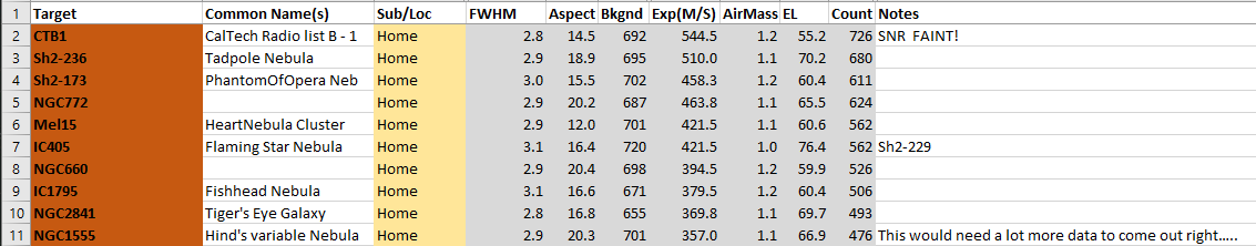

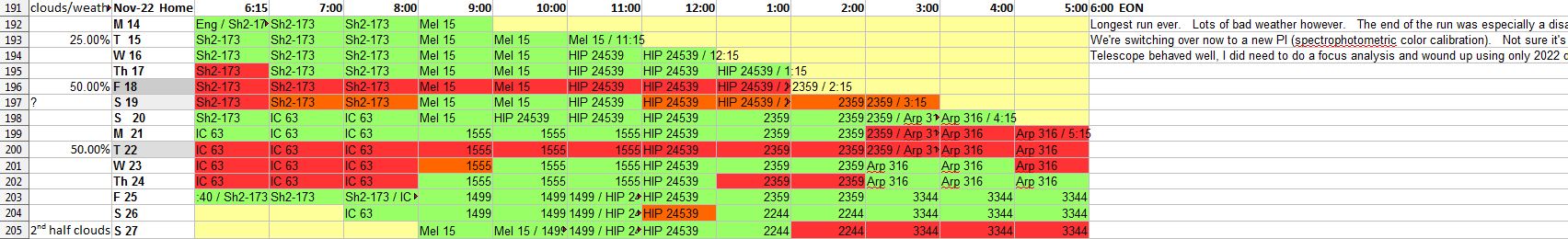

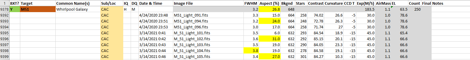

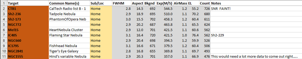

As others have suggested, Excel (and/or Open Office) spreadsheets are extremely helpful as logs and characterization aids.   I keep two main spreadsheets with several tabs in them.   One I call "the planning worksheet" and the other "the archive".
The planning worksheet is a record of what targets I intended to image by date & time.  I then color code what was actually observed.   Moon obscuration is factored.  I learned from scuba diving; plan your run and run your plan!  After the run is over, I transfer those cells to a history tab for a running permanent record.   The planning worksheet also contains tabs for setup and travel checklists.   These setup/travel checklists are indispensable for avoiding mistakes.   I always maintain and follow my checklists (or I'll definitely screw up)!

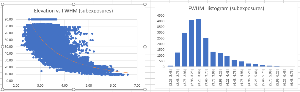

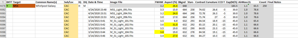

The main feature of the archive spreadsheet is one row for every kept subexposure of each target.  Each row contains quality metrics (in my case from CCD_Inspector, but PixInsight SFS CSV output could do equally well).  This is invaluable when wanting to sort or combine old data with new data.   Roll-up/Summary data is kept for each target (avg FWHM, airmass, elevation, total exposure time, etc).  I keep the main tab sorted by object (for object location ease), and another tab sorted by integration time (to know which objects are good and which need more time).  Yet another tab defines metrics charts from roll-up data.   C3.png
I think there's no end to the value that keeping a log/archive gives.   Yes, it takes time to organize, but in the end it's a habit that pays huge dividends.  You'll have a permanent record of all you've done, make fewer mistakes, and be able to characterize your data and progress over time.   Now, even after 40K kept subs and all the work to keep it up, I can't imagine not having the logs & metrics.   It's part of the habits in the hobby I enjoy (among all the other stuff).   Gear and data.. oh my!     CS  Doug

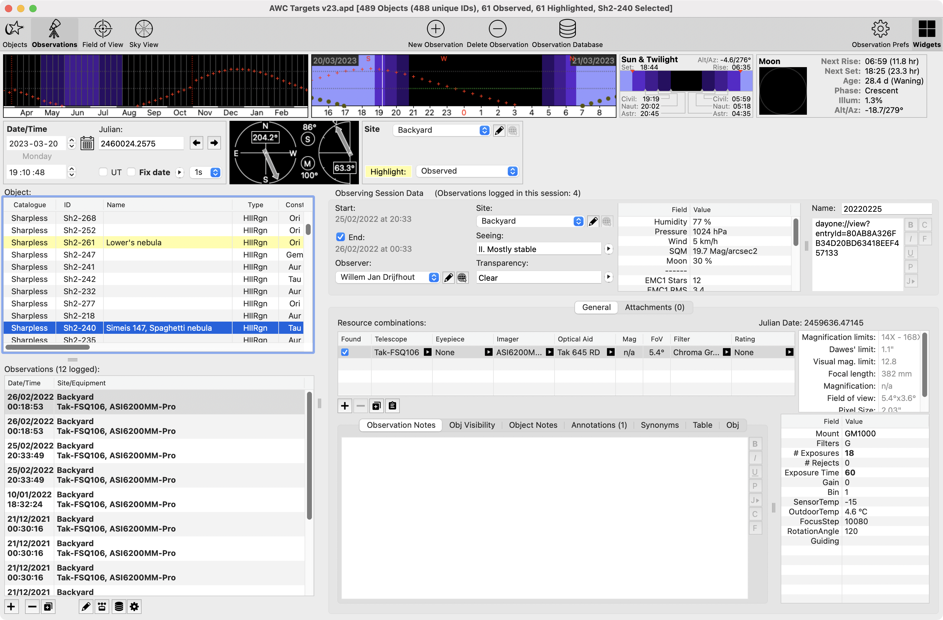

Great post! I log all images in AstroPlanner from Paul Rodman. At first it is a bit intimidating, and it is originally written with visual in mind. But it is completely configurable and you can define custom fields throughout the application. As the name suggests, at the core is a planning tool, with access to any catalogue of objects thinkable. Next level of organisation is the sessions where you can store info on location, conditions etc. Within each session you can record observations. There is a resource manager where you can build a library of equipment (scopes, cameras, filters, etc). The way I work is that I make an observation for each combination of target/rig/filter and just enter the number of frames with that combo. As output I export an excel file that I can use in a data visualisation application. This way the tables and graphs for my website are automatically created.
There are a ton more capabilities, and I'm probably using less than a few percentage of all the options. But for planning and documenting I've found it very practical. There is also a very active community on which also the developer is active and responds very quickly on questions/bugs, etc. It's not free, I believe around $50 or so, but worth every penny.

Hi guys,
I've just published a template for my Astro Log Excel spreadsheet here.
I've added a simple equipment database in the Equipment sheet which can be modified for your own setup. These tables are used as lists on the main sheet to select available equipment  from a drop-down list or just type in the name which will be matched against the appropriate list.
The main sheet is setup as a table which automatically expands when you enter a new date (you should see the row change colour to green) and then all the fields can be populated. Note that the Total Exposure and Integrated Exposure fields are calculated automatically so make sure you don't overwrite the formula (I tried protecting these cells but it stops the table from auto-expanding).
Please feel free to download it and start using it. The first thing to do is populate the lists in the Equipment sheet (be careful not to insert rows, just overwrite what's there). Once you've entered some data each column in the table can be filtered using the little arrow next to the column name eg. Filter on a specific target and filter.
I hope this all makes sense, any questions or problems please let me know.
Clear skies,
Andy
