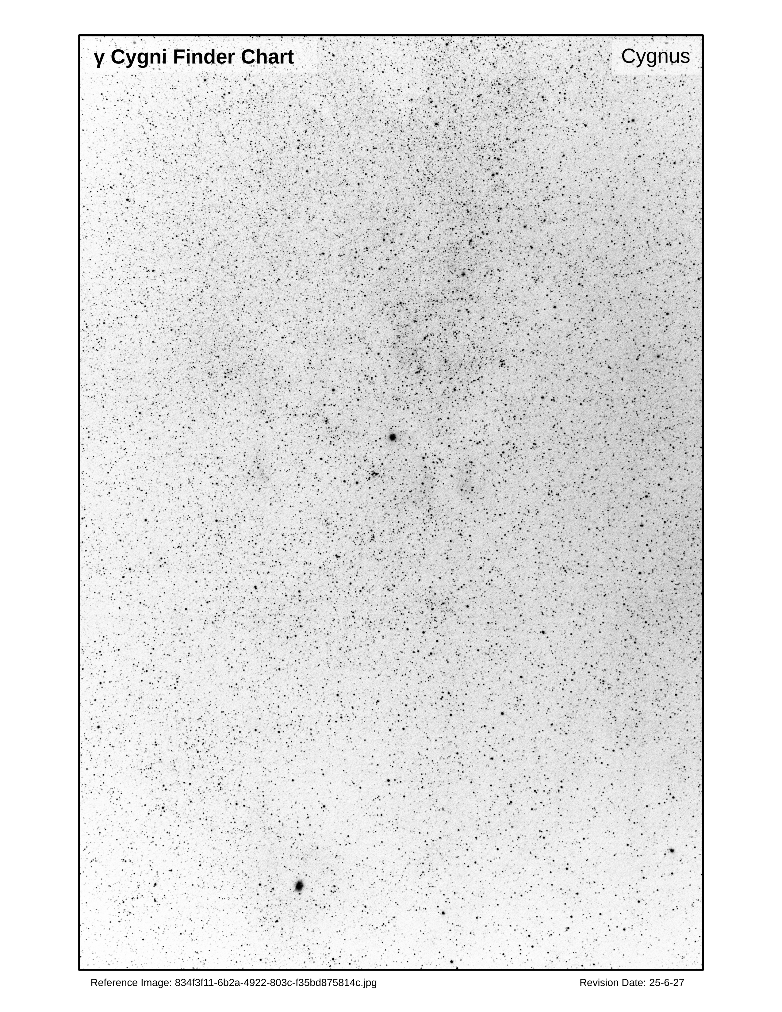

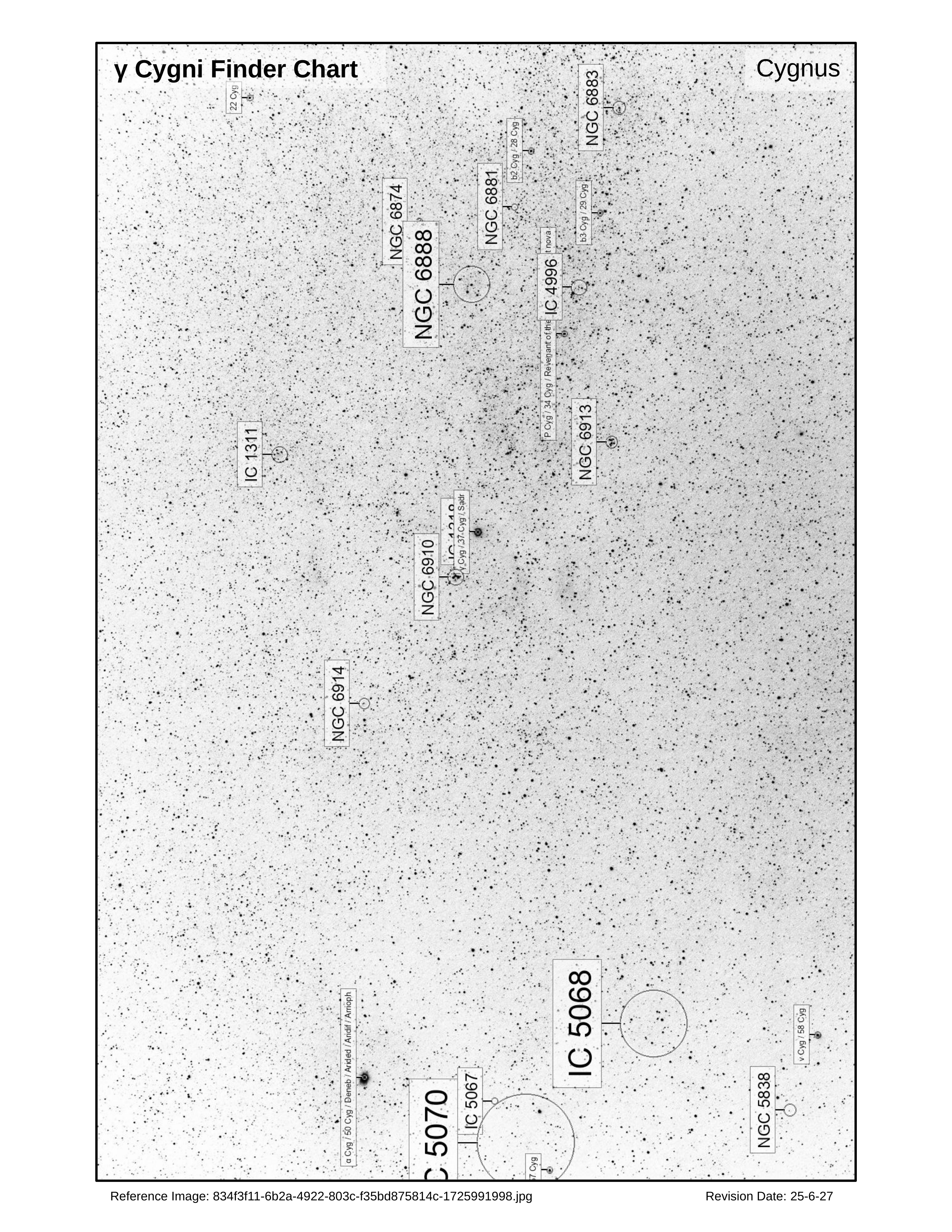

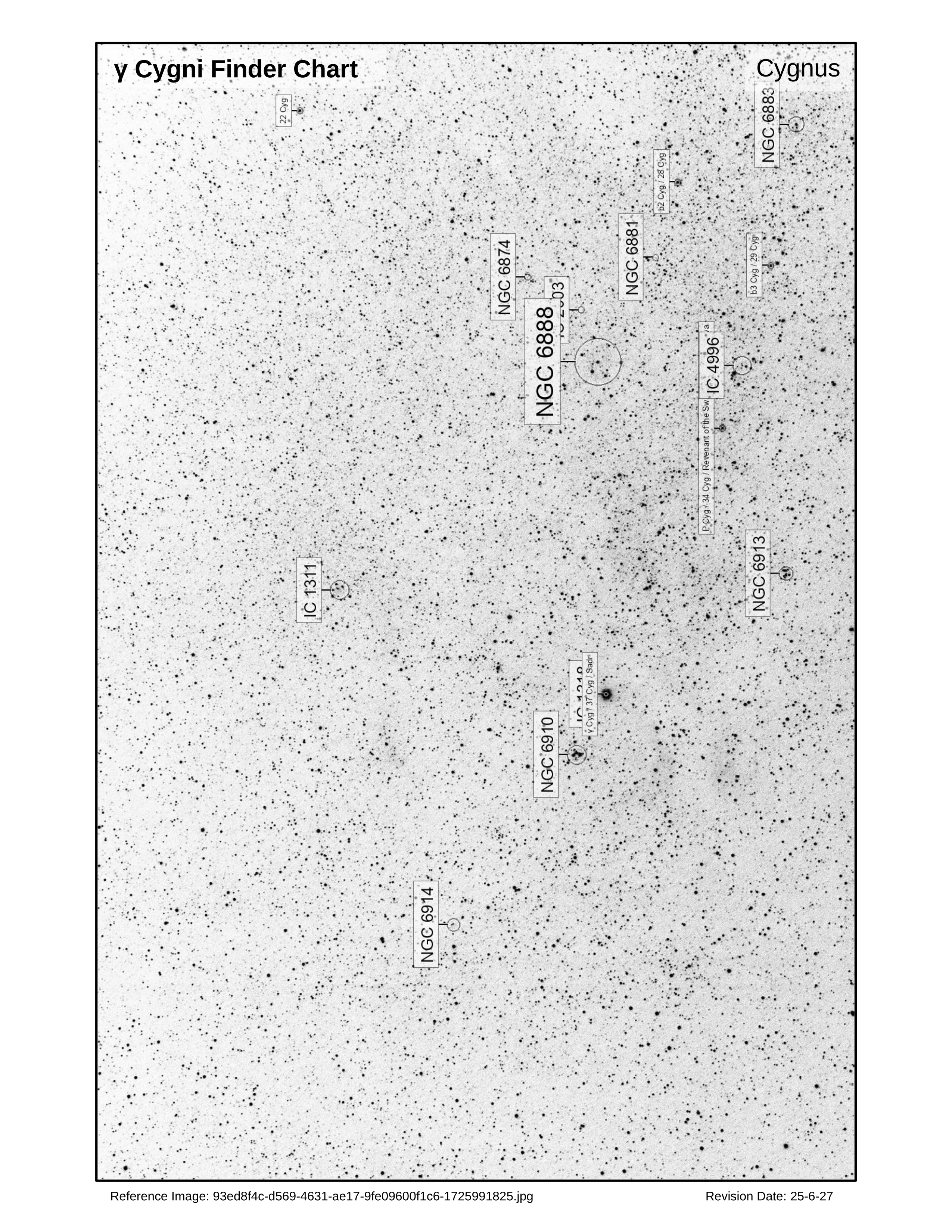

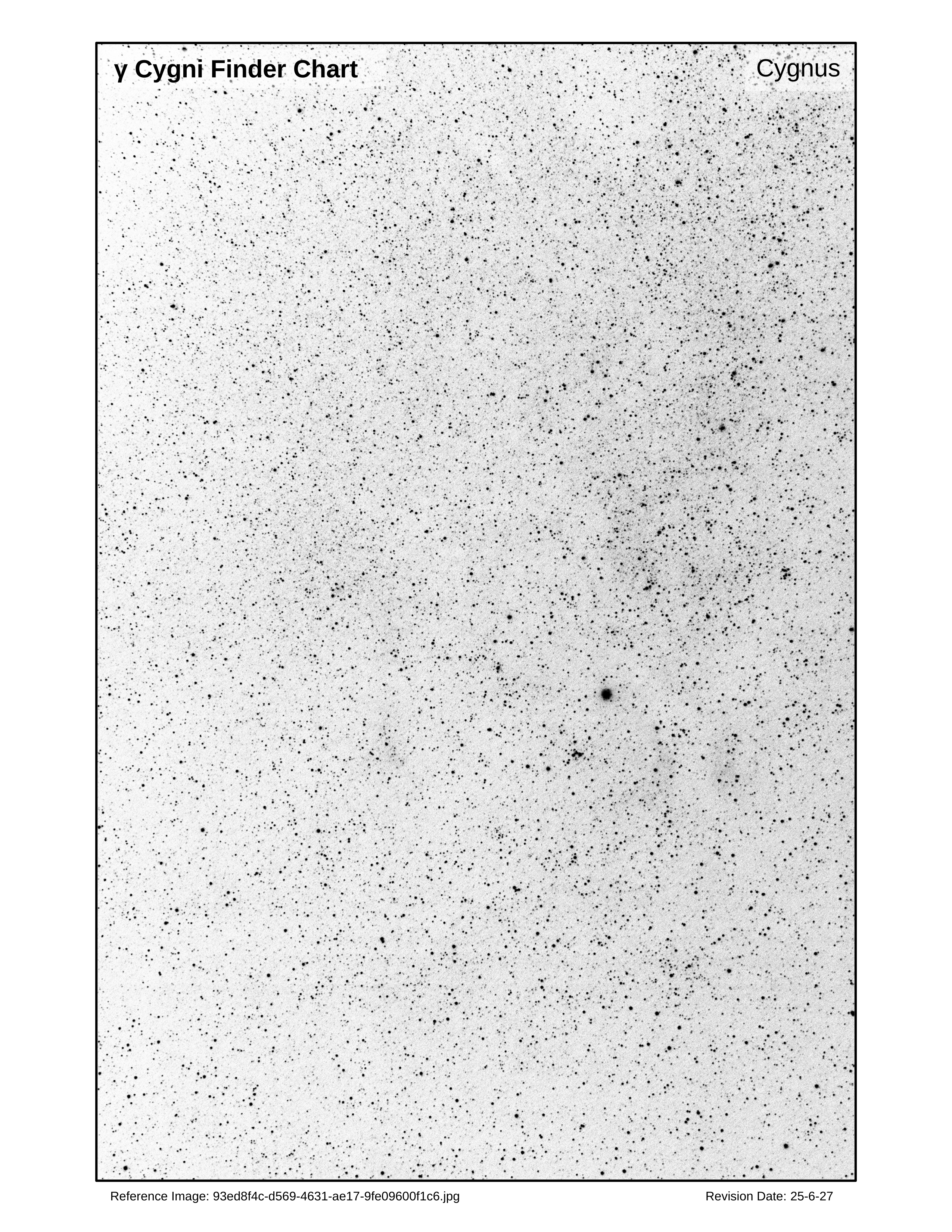

UPDATE:  Here are my latest additions:
Eta Cygni Finder Chart (2).pdf
M81 and M82 Finder Chart.pdf
M81 and M82 Finder Chart (2).pdf
M57 Finder Chart.pdf
