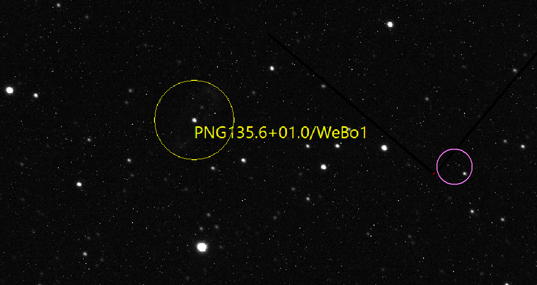

I recommend ASTAP. Fast and free and a lot of different catalogues. Just tested on WeBo1 in one of my RAWs. Works like charm. It solves and annotates DS objects in fraction of a second. My absolute favorite. It also identifies quickly asteroids or comets.
Alternative. PixInsight (solver and annotator). But expensive.
ASTAP: one of the Ha subs of the final image here: https://www.astrobin.com/hqvtlh/
Also tested on a wider field (https://www.astrobin.com/emw527/) WeBo1 is always clearly identified via ASTAP.
Hello Ruediger,
Thanks for your detailed answer, as I already own Pixinsight, i'll give it a try, your WeBo1 is insane

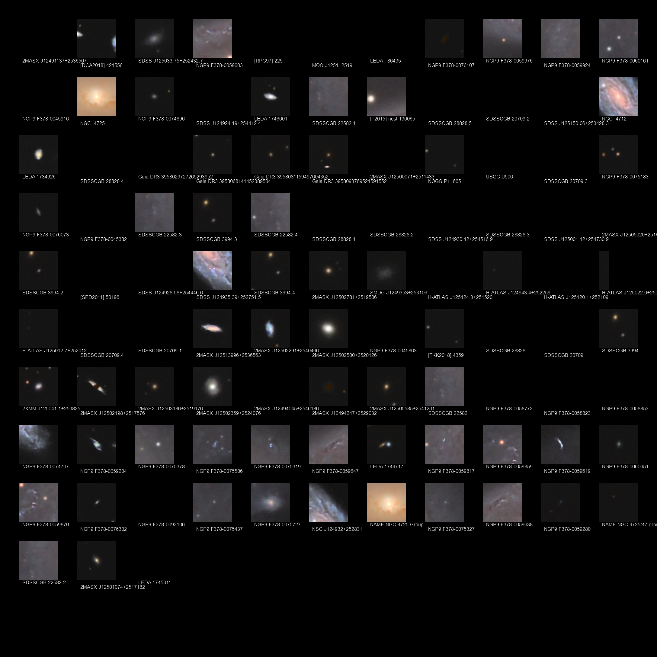

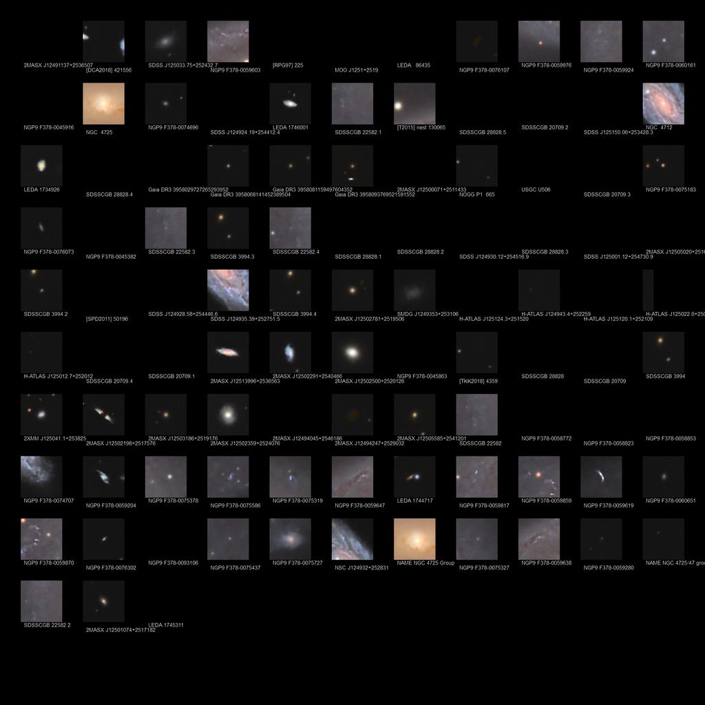

Here's an example of the collage that the SA script created from my image of NGC 4725. I think the blank ones can be filtered out, but need to play with it more.
Cheers,
Scott
Cheers,
Scott
This is insane, my week end is now fully booked xD I'll check every image i own
