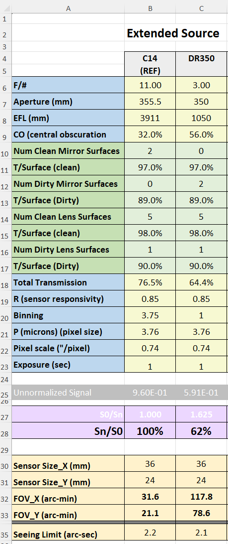

I'm looking at  the attached spreadsheet and I'm a little confused about the numbers used counting the lens surfaces between the GTX130 and the DR350 / DR500.
The Delta Rho 350 has two exposed mirrors and a lens group with 3 elements (https://astronomytechnologytoday.com/2022/09/02/planewave-delta-rho-350/) so it's entry in the spreadsheet of 2 dirty  mirrors, 5 clean lenses and 1 dirty lens seems correct.  (I'm guessing the dirty lens to be the one facing the secondary mirror).
The GTX130 is listed as having one clean lens surface and one dirty lens surface, but this is a triplet refractor with a field flattener.   Wouldn't that be 6 lens surfaces in the telescope (3 lenses / 2 surfaces per lens) and then another 4-6 surfaces in the flattener (4 for a 2 element flattener, 6 for a 3 element flattener)?  i.e. 1 dirty lens surface, 11 clean surfaces (presuming a 3-element flattener).
I'm using the spreadsheet to help me pick a new telescope by comparing it to a telescope I own and looking at the difference in performance so it's important to me that the calculations be accurate as possible.

Here's a comparison between a C14 Edge and a DR350.  I've (software) binned the edge to give it the same pixel scale as the DR350.
Using the Edge in (software) BIN 3.75 mode shows the RH350 to be 38% less efficient on extended sources but gives FOV that is 13.8x smaller.  (117.8 * 78.6) / (31.6 * 21.1).
So depending on the size of the objects you want to image one telescope will be nearly 1.6x more (or less depending on your viewpoint) efficient.
With the Edge you can lower your (software) BIN mode to take advantage of nights with better seeing at the expense of signal per unit time.   Conversely you can drizzle the DR350 to get more resolution (again at need to take 2x the number of exposures).  [Don't forget to take the extra read-noise in binning mode into account when calculating sub-exposure times for the Edge]
(note:  I don't recall a study looking at the efficiencies of Binning a longer focal length scope vs drizzling a shorter one, so it's hard to know which is more efficient.)
In the end I think the real difference between them will be determined by row 18:  Total Transmission and that's why I was asking about how to accurately enter the number of lens/mirror surfaces.
jhayes_tucson 26.84
John Stone:
You have to be a little careful to understand the design of the lens.  Maybe I goofed on how many air-glass interfaces are in the GTX130 but a triplet doesn't necessary have 6 surfaces.  It's possible to have cemented surfaces as well.  The GTX130 is an apochromatic objective and I'm not very familiar with the actual design, the number of elements, or the number of air-glass interfaces.  Either way, the spreadsheet gives you a reasonable tool for dealing with it if you can get the input right.
jhayes_tucson 26.84
John Stone:
Agreed!  But that's not the whole story.
Sure, you can do that, but you've got to be happy with pretty poorly sampled images from your C14.  Under good seeing conditions a well sampled C14 should use pixels in the range of 7 - 9 microns.  By "binning" at 3.75, you are increasing the effective pixel size to about 14 pixels, and (as you've shown) that's sampling at a rate of 0.74", which isn't very good for that scope.
