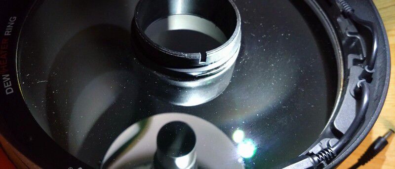

I really appreciate your responses here. You have answered many of my own questions in a good way. I'm on my phone replying now and forgot to check if I included an image of my corrector plate. This is how it looked after drying off inside. It's only visible when I shine a light towards it so it may not be a problem at all.  |

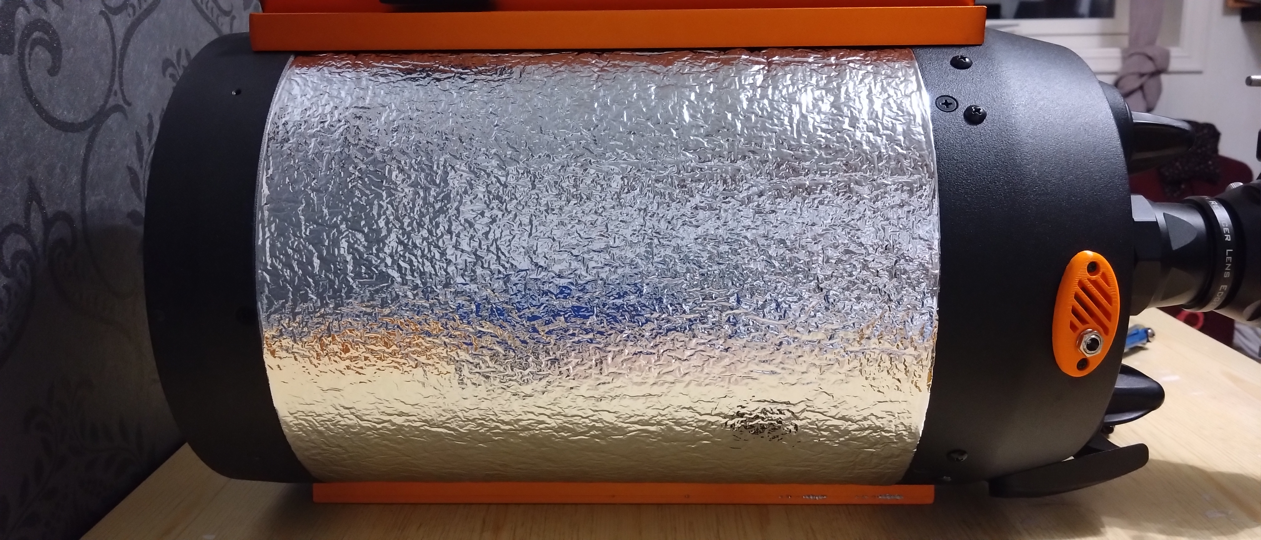

Question about insulation which I've started to work on now. How should it be placed? I did one covering the white tube itself, but should it cover the cast black metal as well? That would involve cutouts for the fans, losmandy bars, finder scope etc.
andrea tasselli: Just the tube will do. Thanks, Andrea!
Small update, I've got my telescope insulated (double layered) around the tube. I've also installed the fans tonight. I will be insulating the dew shield as well but I'm still unsure whether I need to clean the corrector or not. Might get it outside to do some planetary tomorrow if I get a break from the clouds.  |

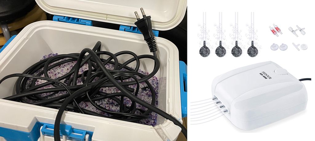

I installed two dry air delivery devices on the hood of my C11, configured so that heavy, dry air flows from the top to the bottom. As a result, it no longer fogs up. Since the area near the secondary mirror, which is not visible during imaging, tends to fog up, it’s better to operate the Dew Heater Ring simultaneously. However, if used carelessly, it may cause the image to blur. This is based on my experience at a mountain altitude of 900 meters and about -5°C. The device is simple and uses a case typically designed to keep canned drinks cool in summer. First, place a 10W aquarium air pump inside the case. Then, drill two holes in the case's lid for the delivery and intake tubes. Inside the case, fill it with a large amount of silica gel to bury the pump. Finally, attach the air tubes to the appropriate parts of your setup. If you test it on a foggy area, you’ll see the fog clear within 2–3 seconds. This device has a small airflow, but it delivers an effect similar to that of a hot hairdryer. It has proven effective not only in cold regions but also near lakes, dams, and coastal areas. One point to note is that silica gel contains fine particles, so if you don’t use an air pump with a filter, you might experience something like a “diamond dust” phenomenon. Therefore, depending on the situation, I recommend cleaning your mirrors on a roughly three-month cycle. Silica gel can be restored from pink to purple by heating it in a frying pan or microwave every two to three nights.For Newtonian telescopes, it’s helpful to drill a hole near the primary mirror at the bottom and attach a tube near the focuser as well.I hope you find this helpful.  |

Arny: thats weird - are you sure its fog and have you tried to turn the fans on to exchange the air in the tube? Can't say for sure exactly what it was, but it looked like a hazy layer on the glass. I removed the corrector this afternoon and gave it a good cleaning, unfortunately I noticed some spots that I should have worked some more on after I re-installed it. I didn't manage to get it out again but it looks much better than it did before though:  No more haziness but as you can see by the light there are some minor cleaning spots left. I was unable to loosen the two lower screws holding the corrector, but I managed to get the two upper ones just enough to get it out and back again once. Not sure why it was so hard to get them. I didn't think I had to do anything but loosen the grub screws.
