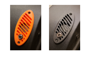

EdgeHD has vents to speed up temps equalizing to the outside. That can be good for cooldown, but bad if you are trying to avoid dew formation on the primary.
Cover the vents, and insulate the OTA with reflextix or other similar double layered reflective insulators. This slows down the temprature changes inside the OTA significantly, which prevents tube currents and also keeps the inside temp always a step higher than your dew point.

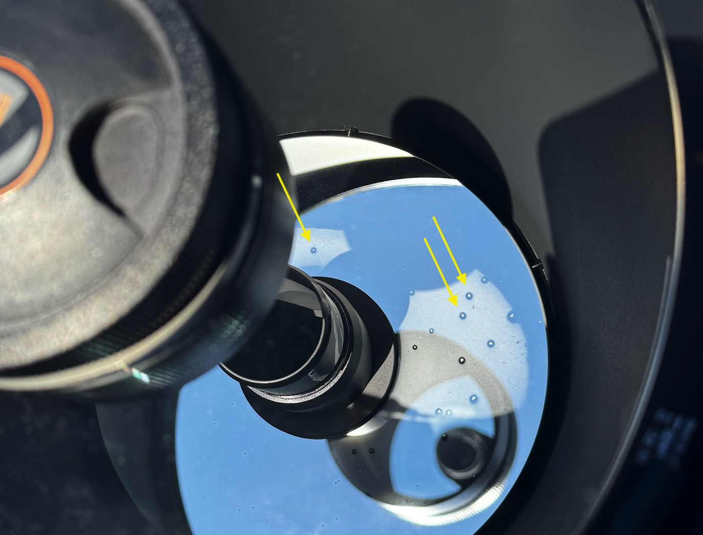

I was noticing the same thing on my Edge HD11.   Leaving it out during a series of clear days/nights, I noticed not only some fog, but some ice crystals on the primary.  The temperature was in the single digits (F), with a similar dew point.  I have a dew heater on the corrector plate, and so that is fine.  Does anybody put dew heaters on the primary mirror?
Also, what sort of image artifacts, if any would you expect from these crystals?  Spikey stars?
I took a picture of it in the morning.  The next morning, under similar conditions, there was no sign of dew/fog/ice on the primary.
Extra scattered light unless it is fully covered (with ice crystals, that is).

Don't seal the vents, not only will that not work to prevent dew (and/or frost) but you will lose the opportunity to fix two things at once.  Instead, order a set of Tempest fans
I did get these, but actually hesitated to use them, as I expect more moist air to be blown into the tube and thus creating more fog rather than blowing it way.
But I take from your comment that you have successfully tried it :-)
