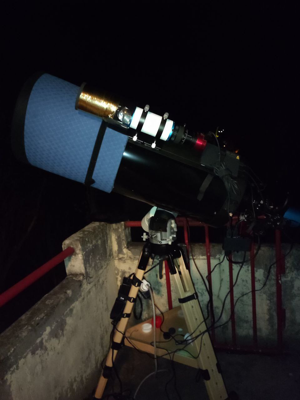

Personnally I use  piece of sport carpet  to extend the tube. I have never experimented dew  with that even when I have 95% humidity in the air winter and early spring time. So no need of a complex expensive  heater.
below my RC10 tube version with the extension (it is black inside face ). At the end of nigth the metal tube and external carpet are all wett but nothing on the mirrors. Best solution against dew  in my opinion.

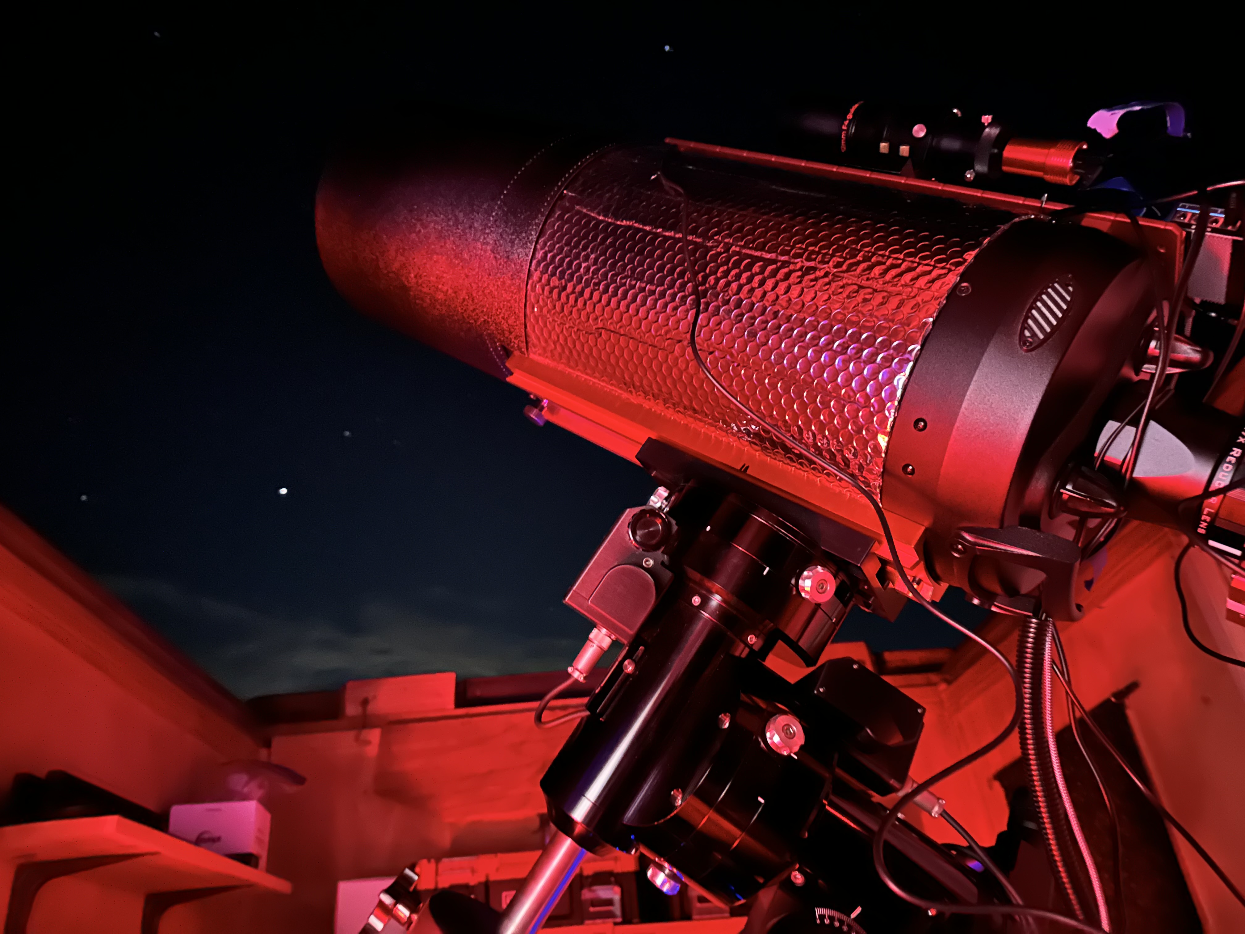

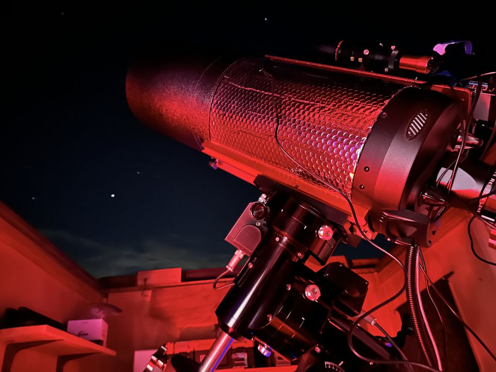

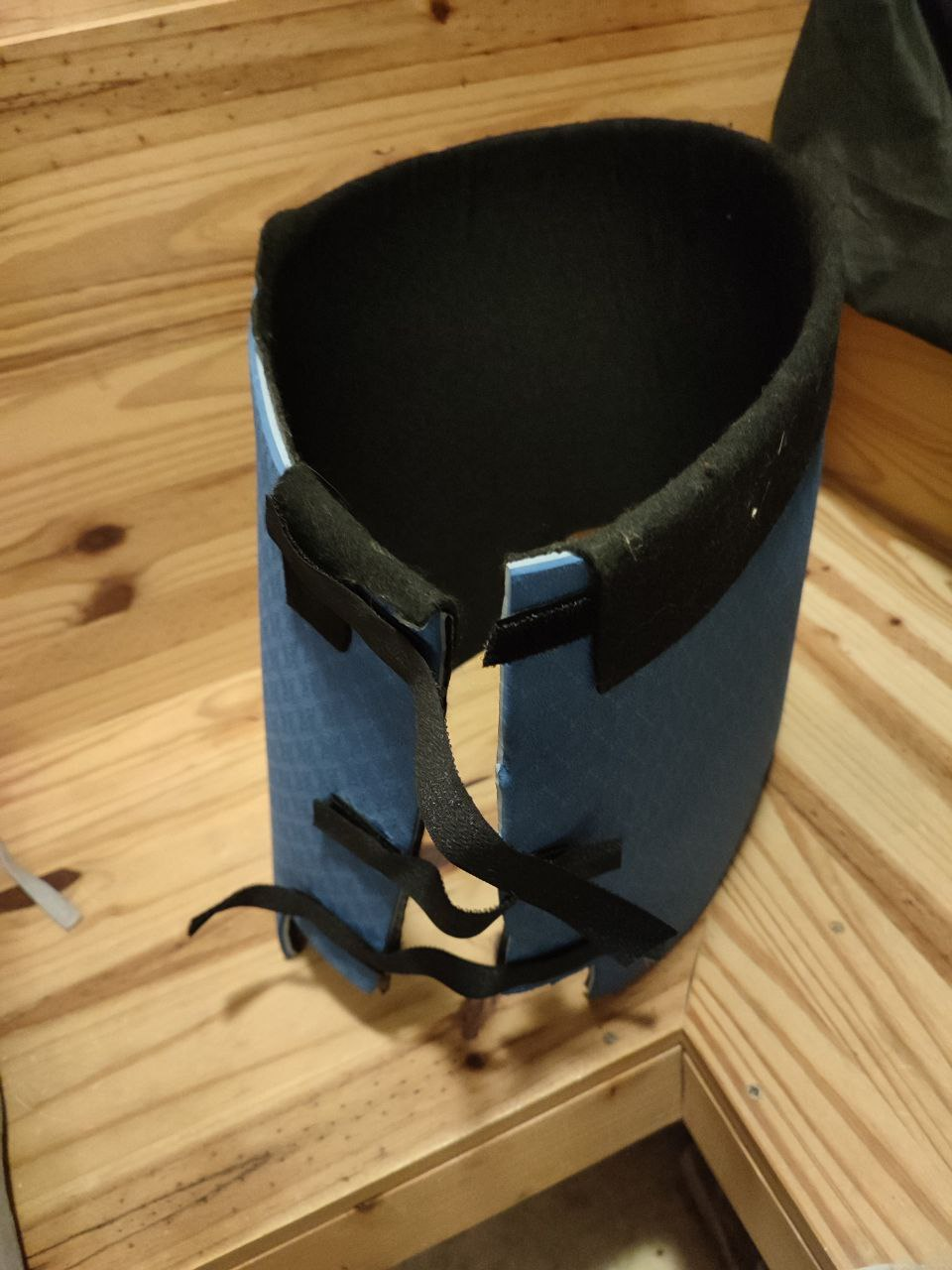

Emission 2.11
I did use an Astrozap dew shield on my RC10s which did not help in the slightest unfortunately, still dewed up (pretty fast actually). And my scope acted as a sail which was a dealbreaker for me as an mobile astrophotographer. Once I went the heater route I never went back.

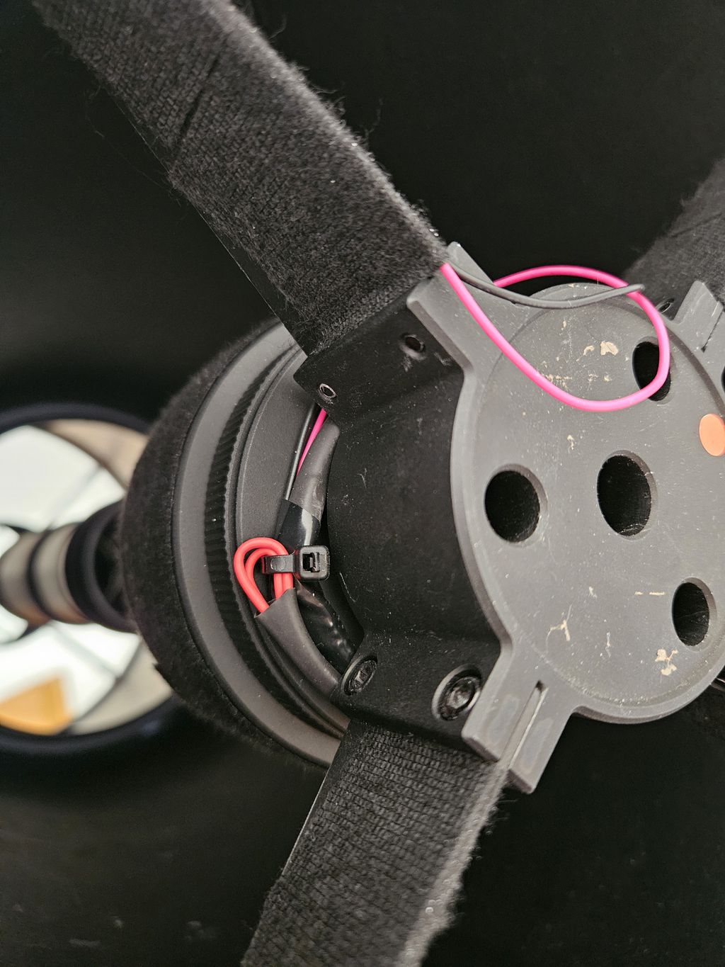

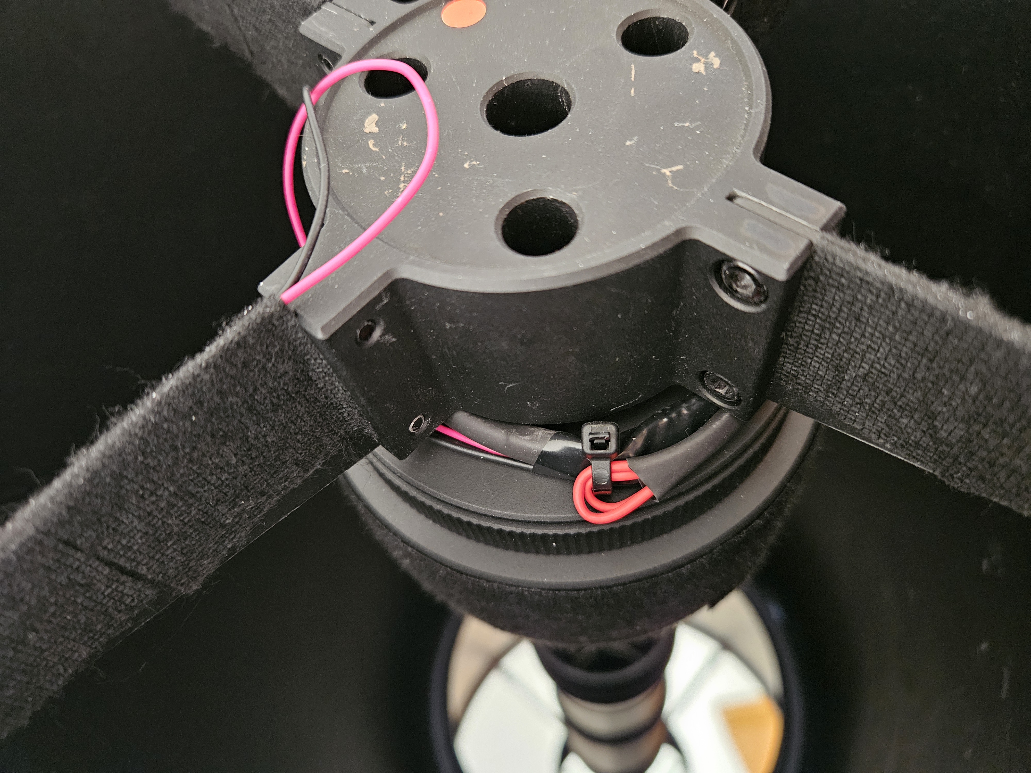

My whole setup can be covered in ice/dew but my mirrors don't care. For the primary I use a heater band on the focuser which transmits the heat via the primary mirror cell. And yes my primary suffered from dew also, especially in zenith.
I attached some images of how my secondary mirror is set up. It holds with one cable tie and some fabric tape (reducing stray light). I would not call this complex.

This is the same,  I will take a picture end this week , I don't have one  at that moment. The difference is the one of the tube was closed and attached to form a tube , the one of the RC10 can be opened . I have small area not totally closed but it works well, new dew.  I use some scratch ribon (velcro) I bougth on amazon so it can be done at the correct size.

This is how is made my  anti dew extension that works also for the RC10 truss. I have never got any dew on the secondary with this. I can easily adapt to the tube or truss with the way I have done it.
