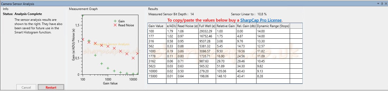

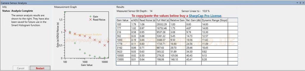

I must admit that I am a bit disappointed about the camera or the communication of Touptek. They had HDR mode problems and released a firmware to fix that (which it does). What they don't tell you right away (you have to ask Karas the technical engineer from Touptek) is that the new firmware locks out your camera at 14bit with a maximum of 14 Stops dynamic range with almost double the read noise (1,1 - 1,2 Electrons). It's not bad but not what they advertise on their website.
Karas told me they had to do that to guarantee stable performance of the sensor. They are working on another HDR sensor right now (I guess the SC2110) and made some improvements. They hope (lol) they can migrate those improvements to the IMX585 sensor, too.
I did a sharpcap sensor analysis of my camera and found out, then I wrote Karas.
Still thinking about refunding the camera, in this firmware state you get same or better performance (with a bigger FOV) with the IMX533 or IMX571.
Just my 2 cents
Just my 2 cents

Edit: AstroShed it would be very kind of you if you do a sensor analysis of your camera too and post the results.
You can do it with sharpcap. Settings are HDR, RAW16 format and -10°C. If you have the newest fw version 4.35 you should get similiar results as me.  good to know i should take touptek off my list. really a shame that more astro companies seem to be very shady  |

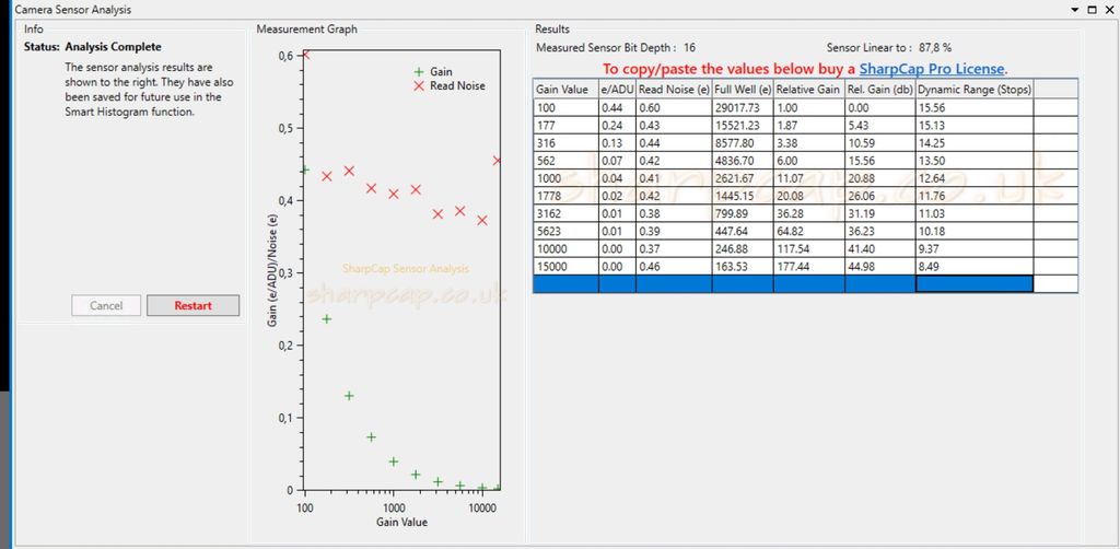

I have been in touch with Touptek again and now have the very latest firmware to try, dated 2 days ago, it’s not released to the public as of yet, and I need to test and send feedback to them, they also say it now solves the issues with the HDR setting and should work as intended…. will be running some sensor analysis before and after the new update…
Same for me, they send me the newest firmware and Touptek ASCOM driver. It is important that you use the .dll they sent the FW with. Only then tools like sharpcap can properly utilise the HDR mode, which is absolutely fantastic after the newest tests with SharpCap Sensor Analysis.
Gentlemen and Gentlewomen, we have 16Bit and almost 16 Stops of dynamic range, which is unbelievable.
My result with Sharpcap was Gain: 100 e/ADU: 0.44 Read Noise: 0.6e (much better than before) Full well: 29000e (also much better) Rel. Gain: 1 Rel Gain (db): 0 Dynamic Range (Stops) 15.56 (!!!)
Will post the Sharpcap Screenshot later.
Regards
Absolute fantastic results.  |
Dream that comes true. This camera is finally a winner as it was supposed to be when advertised. It has them all !!!!!! Thank you for following up with Touptek. Actually just today they sent me the same message since I have been asking them fur updates several time. They kept their word and recovered a negative situation. I placed the order and can't wait to get my hands on it  Seba
With those breathtaking specs one could think about doing lucky imaging. Used Noise Analysis in Stacked Exposures Version 1.16 (smallstarspot.com) and typed in normal rural darkness 20mag/arc/s paired with a F/3 system (e.g. F/4 Newton with Nexus Reducer) and Gain 177 (0,43e). Read Noise would be overwhelmed tenfold within 0,8 seconds (!) If you have enough disk space, you could shoot deep sky with extremely sharp details and still have good SNR, wow. Seeing won't be much of a factor with 0,1-0,5s exposures  Very excited about the new generation of HDR sensors.

Very excited about the new generation of HDR sensors. I imaged for about 3 hours last night and used about 5gb storage If I was lucky imagining with 0.5sec subs instead of my usual 60 seconds... That would be about 700gb lol I'd love to try lucky imaging but I'd need to buy a lot of ssds  |
Would love to see some test results in the night sky and a comparison HDR on/off. But looks promising!
