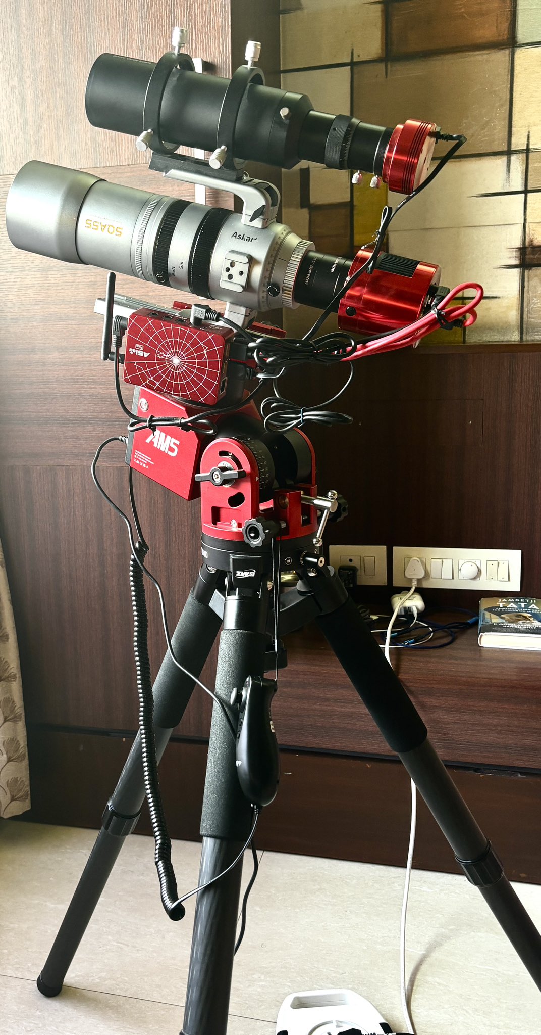

I have a Askar SQA 55 since last 6+ months and am using this along with ZWO ASI 533 MC and ZWO AM5N mount.  The performance has been good so far and have not much complaints. Agree to the above advantages listed but the only issue is mounting of my Guide Scope on the top handle causes some flex and hence sometimes guiding is not proper.  Have to ensure the assembly is tight and in place with no movement each time.
Am now planning to go for OAG and EAF in coming weeks .  Have already got the Askar EAF Kit as part of the scope but yet to install it
Else no complaints as yet

To be honest I would go for a smaller guide scope first. One of those cheap 30mm ones would be plenty.

My Omegon 60 mm Guide scope is working fine and good.  Instead I plan to have a separate Dovetail Plate assembly for Mounting of the scope on the side
