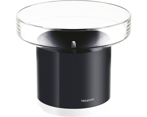

Since I wanted a easy quick solution to my problem and I already had a Netatmo weatherstation, I bought a rain gauge which I'm planning to modify to push me a warning at least shortly after it began to rain.
I disassambled it and will frankenstein it to detect a few drops which should be pretty easy.
I know not exactly the best solution and certainly not the fastest but I can just implement it into my weatherstation.
A few drops won't hurt my rig (I had it in light rain for 45min.) and nothing was damaged.
So I guess it's way better than no notifaction at all.
