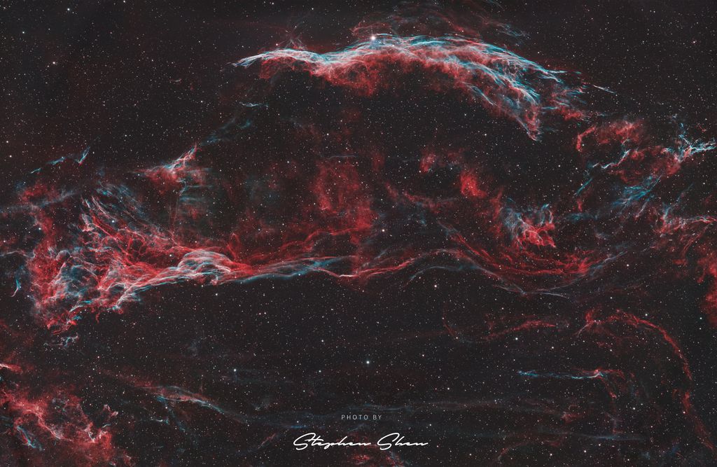

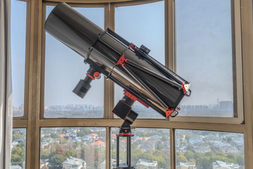

I have finished all my tests on this Clearsky Alpha 200mm F/4 Newtonian reflector. The redesigned structure for supporting the secondary mirror is stable and easy to adjust. Clearsky offers two options for purchasing this telescope, you can either get a kit and install Skywatcher primary mirror & secondary mirror, or buy the kit with Clearsky's quartz mirror preinstalled. I myself got the Skywatcher version. I don't know if they have any plans to sell this telescope outside China yet, but you may leave a comment if you are interested. Sample image was taken with Touptek Skyeye62ac camera and Clearsky St17 mount   |
The model I'm using is not the final version. Final version that they sell on the market has shorter dew shield

This looks like an interesting design for a 8" newtonian. I guess the tube serves only as a light shroud for the truss design? I would be interested to see the primary cell and the secondary holder.
Christian Andres: This looks like an interesting design for a 8" newtonian. I guess the tube serves only as a light shroud for the truss design? I would be interested to see the primary cell and the secondary holder. Yes you can actually just remove the tube, and that makes the system more wind-resistant

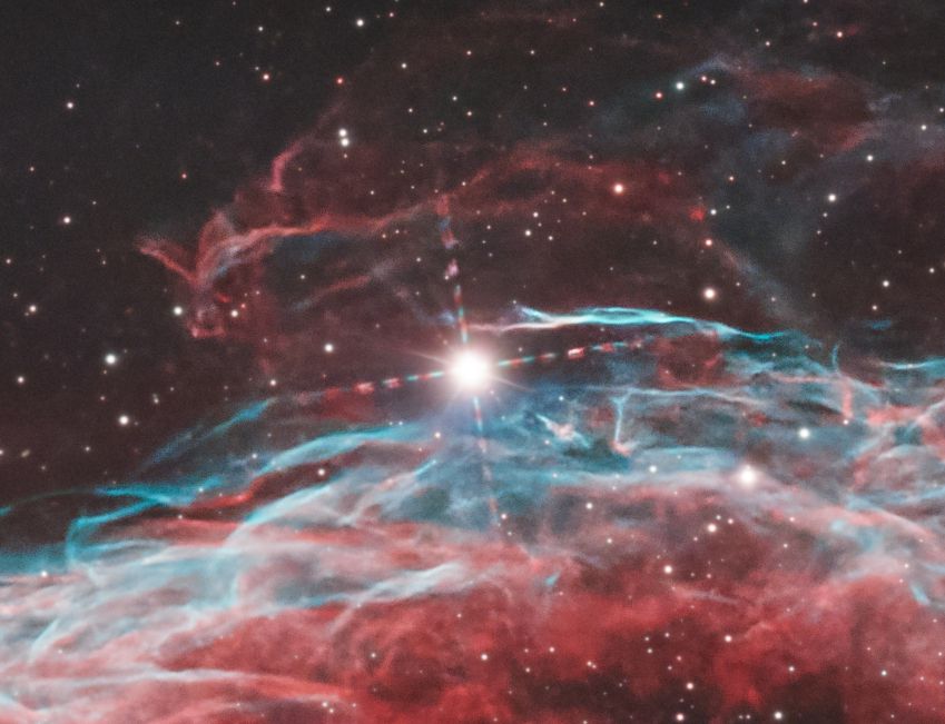

Can you share any images of the primary mirror cell and secondary spider? I'm curious how their cell designs differ from the rather poor designs available from most of the mass manufacturers. Can you share any single subs? These stars are pretty rough looking but it could be artifacts from processing.  |
From the diffraction spikes it looks like the spider vanes are not colinear. Is the spider CNC machined?
I wouldn't say so. Mayhap there is a slight cone error and the scope flipped during the imaging run. To judge that you need a single frame.
You're right, with those three sticks holding up everything it is very possible.
 I accidentally dropped screws on the primary mirror, resulting in some scratches. I think that's where these spikes come from

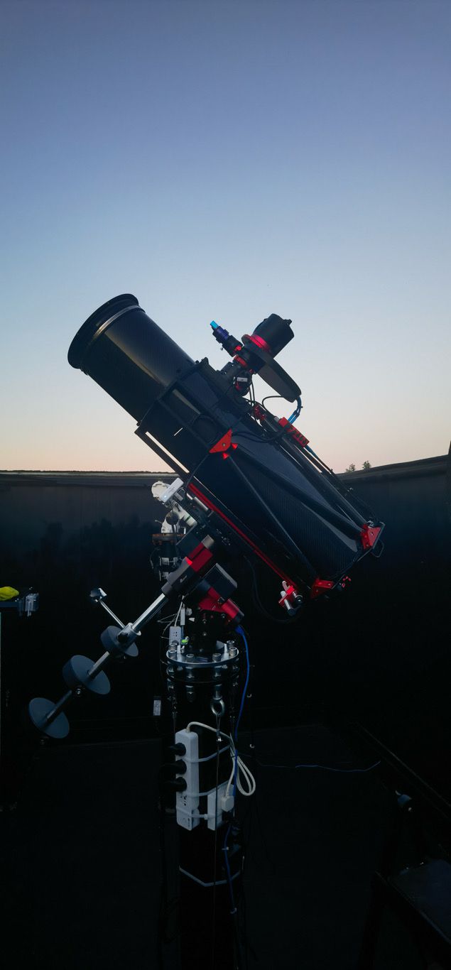

what is the cost? How can I order? 8-inch version costs USD 1499 (with sky-watcher mirrors), quartz mirror version would cost USD 2299. 8-inch version uses 70mm secondary mirror. 10-inch version version costs USD 2499, which uses 80mm secondary mirror. There is a variant that is optimized for full-frame imaging, and it would be USD 2899 USD. The variant uses a larger focuser and 90mm secondary mirror. Estimated price for 12-inch version would be USD 3599. As for the CAA issue, a friend of mine which also uses the same telescope in Australia uses wanderer CAA in the way shown in the picture attached. You may contact the manufacturer: [email] [email protected][/email]
Jordan Morley: Looks very heavy Indeed! Although they used a lot of carbon fiber, but it is still over 10kg
Ouch. If an 8 inch weighs more than 10kg, then I can't imagine how heavy a 12 inch is going to be. (I am interested in a 12" Newt.)
A standard CF-tubed 8" Newt with rings and plate (and standard 2" focuser) weighs between 7 and 8 kilos. This one looks more like an exercise in design rather than practicality.
andrea tasselli: A standard CF-tubed 8" Newt with rings and plate (and standard 2" focuser) weighs between 7 and 8 kilos. This one looks more like an exercise in design rather than practicality. Yeah a quick count shows 50+ individual parts instead of a single monolithic tube. And on top of that there IS a CF tube in the middle as a shroud so it's not like they lack the ability to make CF tubes. If this was a 16" or larger scope, sure but for an 8' this is a crazy amount of extra junk.
The designer clealy isn't a mechanical engineer. the whole structure from the top to the ground should be assessed for flexure to identify the weak points and deal with those, and avoid over-building where it’s unnecessary.
The tripod and three sticks it is perched on are the first issue.
And CF tube is stiffer than the truss - keep the rings and delete the rest of the truss. Newtonians do need the tube to keep stray light out.
The designer of this is unaware of the real purpose of a Serrurier truss - on large telescopes it allows the top and bottom ends to sag (which is inevitable on a large observatory scope) on either side of the connection to the Dec axis, whilst relying on the geometry of two parallelograms to maintain the collimation of the top and bottom.
MaksPower: The designer clealy isn't a mechanical engineer. the whole structure from the top to the ground should be assessed for flexure to identify the weak points and deal with those, and avoid over-building where it’s unnecessary.
The designer of this is unaware of the real purpose of a Serrurier truss - on large telescopes it allows the top and bottom ends to sag (which is inevitable on a large observatory scope) on either side of the connection to the Dec axis, whilst relying on the geometry of two parallelograms to maintain the collimation of the top and bottom. Hey, man, the tripod and three connecting rods you mentioned are Stephen's own equipment. He was probably using them temporarily mounted on the equatorial mount for shooting. This has nothing to do with the design of the telescope; it's purely the user's own doing. This is my own equipment, and we usually use it this way.  |
Sure the quality of the machining of the parts is evident, but you haven't used Finite Element Analysis (FEA) to work out where you needed strength, and where you didn't. It's quite obvious just looking at it.
If FEA had been used I would expect you would find your truss serves no mechanical purpose and could have been omitted, making it lighter, many fewer parts, lower cost, and quicker to assemble.
The difference is this:
When you're building a one-off for yourself you don't really care much about the material cost, or your time. Once you have something that works well, you stop. I've "been there done that" many times in my telescope-making days.
But if you are aspiring to build a product that will go into volume production, this is where the product has to be optimized - fewer parts, less weight, less labour, and lower input cost. If this is done well it's quite usual for the result to be better quality, lighter and lower cost than the first prototype you started with. This is what I run in my day job in a large engineering enterprise.
If it is done poorly (Meade and Synta being examples) the product will forever be compromised.
PS like the mirror cell, except that I would not use springs - I always opt for push-pull screws (two smaller M4 screws pushing either side of an M5 bolt pulling). That way collimation stays put, forever.
