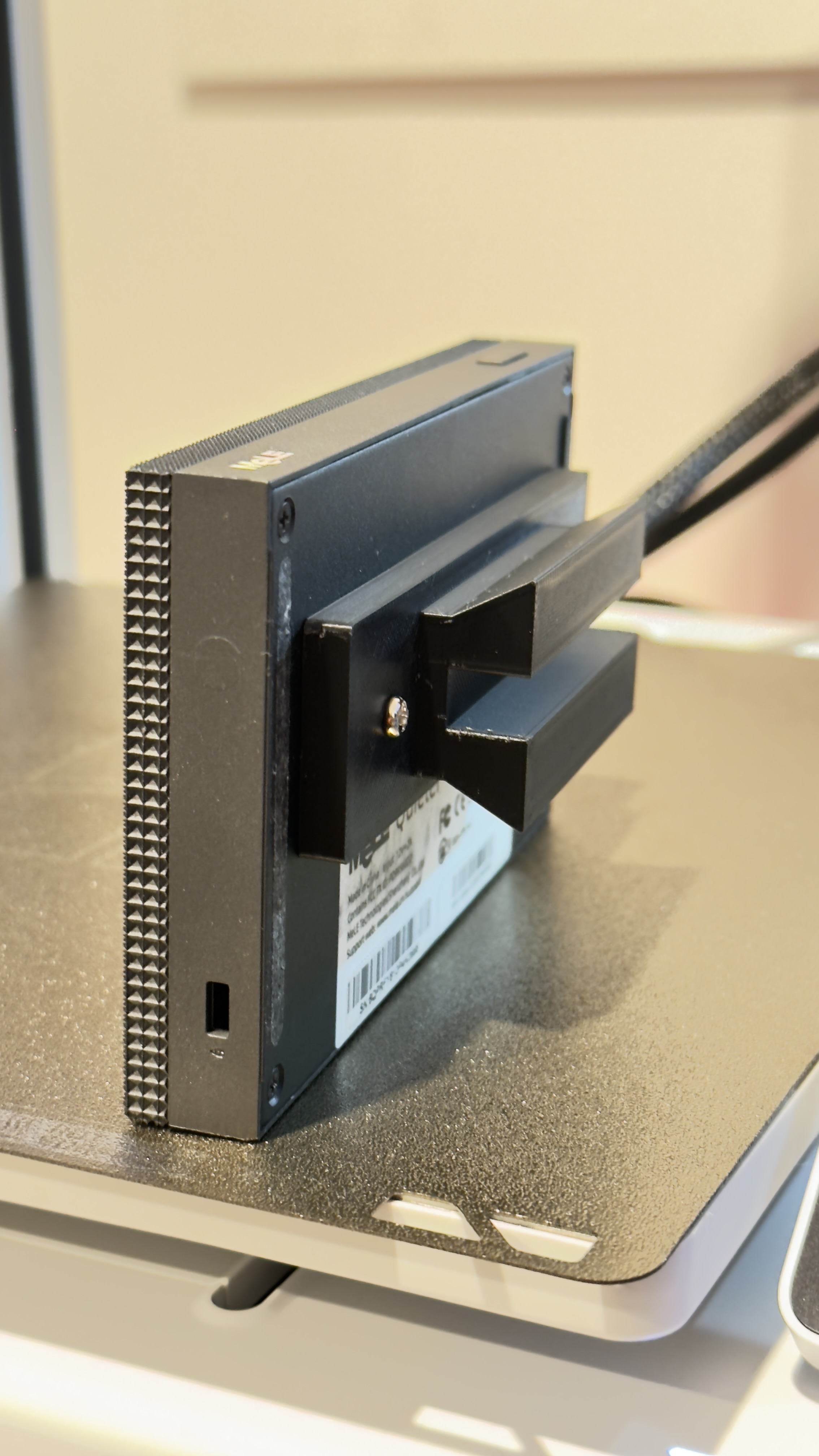

Hi all, fingers crossed this post is in the correct part of the forums!!
I’ve recently purchased a 3D printer because I wanted to solve an issue regarding placement of the MeLe 4C on both my imaging rigs!!
I came up with this design the used the two M3 screw holes on the back of the MeLe 4C and in turn allows you to fix it in to your common finder scope bases
3D print files are up on makerworld (https://makerworld.com/models/1501356)

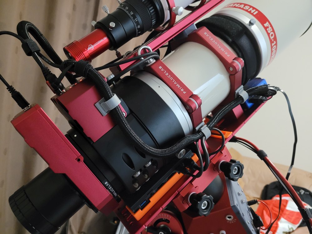

If you ever want to mount your Mele on a plate or dovetail, then you can use this little quick mount system i created. It keeps the slim profile of the miniPC and make sit easy to removes if needed.
While listed for the 3Q, it also works really well with the 4C.

I really like that design!! Nice snug compact fit
If my idea does end up being more hassle than it’s worth …. I’ll be giving yours a crack!!

It's been a fantastic design for me.
I've got my Takahashi sitting up on 30mm spacers and the MeLE 4C tucked in neatly underneath.

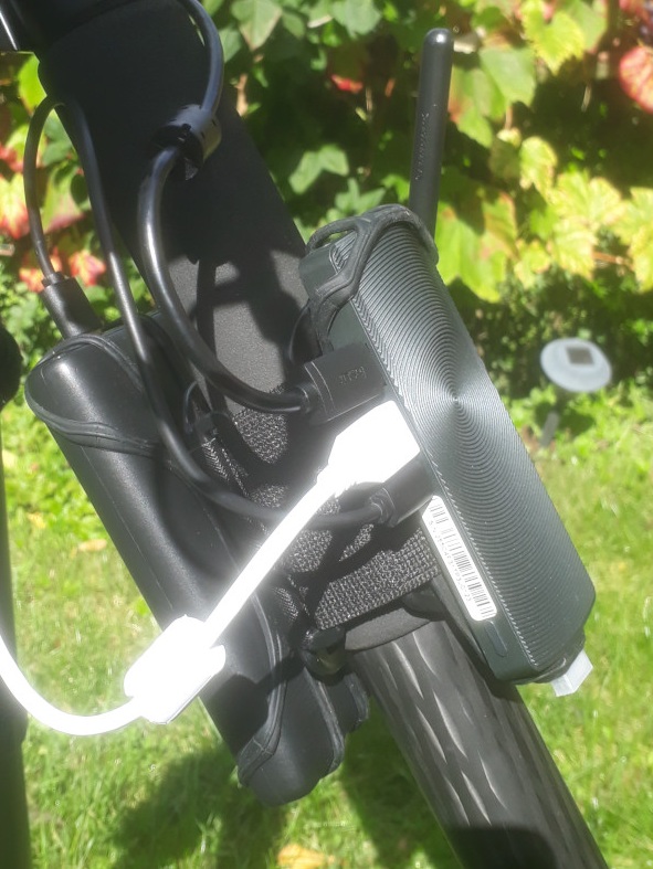

I went for a simpler solution: a running armband for smartphones (something like this: https://www.amazon.com/MoKo-Running-360%C2%B0Rotatable-Smartphones-Detachable/dp/B0DS26WHGB/ref=sr_1_10)
It's true that my MeLE PCG02 is smaller than the 4C and it is mounted on the tripod. I actually used two such armbands: one for the MeLE and one for its power pack.

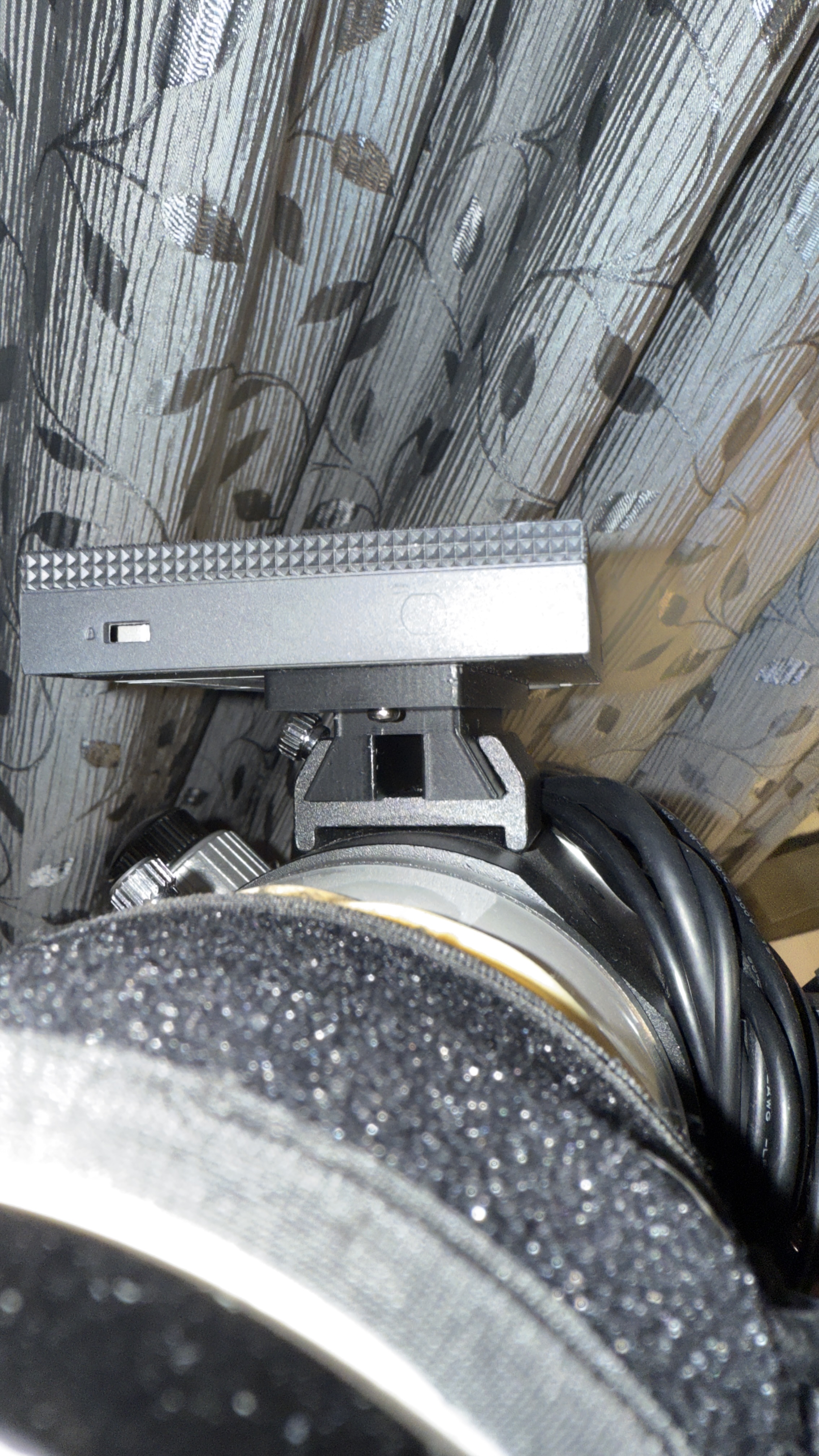

I love this solution that, due to the plastic (or so) material contributes to termically isolate the Mele from the tube. The Mele 4C really reaches high temperatures (over 70-80º in a regular use even using heatsinks). I would never attach it directly to the tube using velcros or so. I initielly used a metalic dovetail and it became so hot trasmiting this heat to the tube. Now I use a resin 3D printed dovetail attached to an extender in order to creat enough "air" space between the Mele and the tube.

Oooooh now that’s given me an idea!! I think I might refine my design a place raised dots about 1mm high so that there’s “air space” between the plastic and the MeLe!!
I have only really found the MeLe gets super hot when it’s inside!! The low temperatures through the night…. Atleast now for me being in winter, seems like they help with cooling
I originally had it velcroed to the EAF and honestly that worked fine
SVI 0.00
Yes, it’s true that the winter weather decreases the Melé temperature but it’s always irradiating heat so much better to not to attach it directly to the tube.
