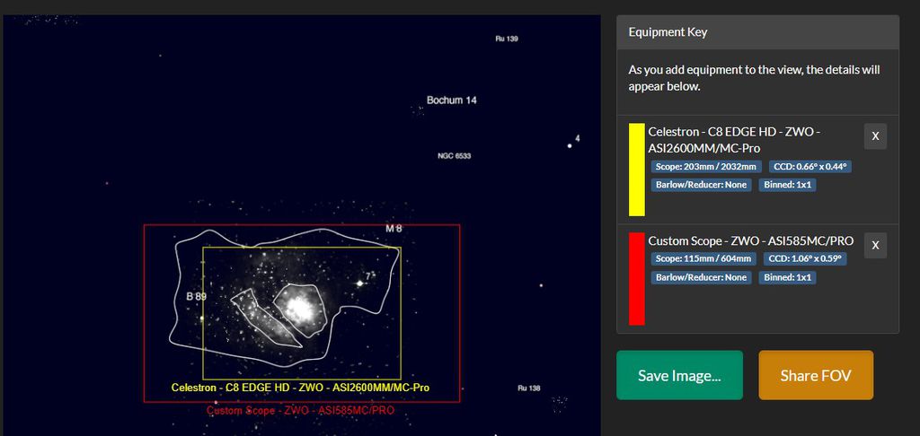

Hello, I'm currently considering buying a used 8" Edge HD. I would like to use it at its native focal length of f/10 with an IMX571 color camera. However, I'm wondering if it's really worth it for me. I currently also have a 115/805 LZOS, which I use with a Riccardi Reducer at 600mm focal length and an IMX585 camera. You can see the two fields of view in the image. Red represents the LZOS with the IMX585, and yellow represents the Edge HD with the IMX571. The object is M8.  My main question is whether the telescope would really take me much further when imaging smaller objects. For planets, I have a 180/1800 Intes Mak, so I wouldn't be using the Edge HD for that. It would be purely for DS astrophotography. What do you think?

"the better deal" in a figurative sense, I wasn't meaning a purchase option between the two. In other words, which one gives the best SNR for unit integration time.
The LZOS has a Dawes limit of 1.01 arc sec and the edge 8 has a Dawes limit of .57 arc sec. You’d theoretically be giving yourself the opportunity for twice the resolution. Seeing is going to be a big deal for imaging at that focal length. You’ll be limited to imaging only on nights with good seeing. I think it would be a nice upgrade especially for galaxy season.

Go for it. Larger aperture + apsc sensor, the gain (tiny objects) in fov may not look much from the comparison above, but the details and resolution will be amazing.
