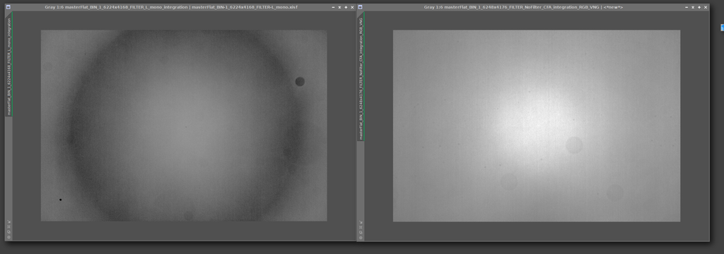

Hello everyone, I'm reviving this topic because I'm having issues with my Ogma filter wheel. I'm having very strong reflections in my optical train. The more I think about it, the more I think it's due to the filter wheel. Here are 2 different flats I took with the same scope. Left is with an Ogma filter wheel and camera (IMX571 mono), the right is with an ASI2600MC and no filter wheel.  The flats on the left do not calibrate the ring issue I have in my pictures taken with the mono setup (which is sadly located 8000 km away from me at the moment). Here is a simple stack of light frames, without any calibration applied:  I am using 36mm, 3mm thick Astrodon filters, secured by the metal holders that came with the EFW.  Are these the kind of patterns you guys saw when you had these reflection issues? Second question, if I were to keep the camera but add a new filter wheel, which one would be compatible with my Touptek/Ogma camera (with tilter)? I believe someone mentioned the ZWO one Thanks for your help! Konzy
Have you closed/taped over the threaded holes on the front and rear?
Yes, I have put extra screws to prevent light leaks. The other side is covered by the tilt plate  |

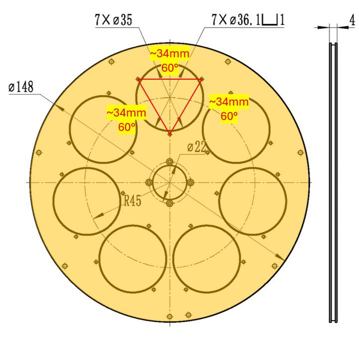

What's the diameter of the filter holders (I'm using threaded filters so I don't have them) and what is the distance between the front of the filter holder (toward the scope side) and the sensor and what is your focal ratio?
Unfortunately I can't measure the filter holders myself, since the scope is now in a remote observatory 8000km away from me What I can say is that the Astrodon filters are 3mm thick, and the holders are made of metal, so they're thicker than the usual plastic ones you see in most filter wheels I am using a ZWO FF80 @ f/7.5 Here are some measurements I found / made. I'm using a tilter.   The tilter is attached to the EFW with 4 screws as per the instructions. The sensor and the filters are as close as they can be. The 6 unused tapped holes on the telescope side are covered with screws, so no light leak is possible from these. No hole on the camera side. I found some pictures I made before sending out the scope.   |
I guess, with a bit of extrapolation and based on the numbers I have for the AFW, you are just free of vignetting the clear aperture of the filters. So that is out of the table. Then a possible culprit are the filter holders themselves, which appear quite gray in the picture and should really be deep matte black. Other things can also be in the optical train that could give the sort of issues and taking a sky flat (at dusk) might highlight where the issue is (by difference between sky flats and panel flats).
Thanks Andrea. My thoughts exactly. I have a Takahashi telescope at home, and the pricey adapters they sell are very well painted inside, with a black, mat effect. The cheaper adapters from other brands are often very shiny. The M45/M54 adapters in the imaging train might also contribute to some extent. You can see one of them is quite reflective... I should have painted everything before sending it. I contacted Ogma and Touptek, asked if they could provide some pointers. In the meantime someone from the observatory suggested I get these filter masks: Buckeyestargazer ShopI asked the owner if he makes masks that are compatible with my system. Let's see! In the meantime, I suppose I'll use the scope on small targets and crop everything out. That should be easier to remove in post than these complex circular gradients! I'll try to update this thread, in case it helps someone in this situation. Thanks for your help !
