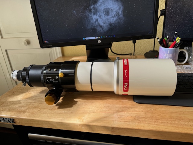

Best decision to permanently fix the problem.....  Removed the flawed stock focuser and replaced it with the Feather Touch® 3.0" Dia Dual Speed Focuser--1.5" DTT, Brake
Bruce Donzanti: Best decision to permanently fix the problem.....
Removed the flawed stock focuser and replaced it with the Feather Touch® 3.0" Dia Dual Speed Focuser--1.5" DTT, Brake and now you are selling..? Still not happy?
Removed the flawed stock focuser and replaced it with the Feather Touch® 3.0" Dia Dual Speed Focuser--1.5" DTT, Brake and now you are selling..? Still not happy? Very happy- the FT focuser is amazing but I decided to piggyback a RedCat 91 WIFD on top of my C11" in my observatory instead of the Baby Q. The reason for this is that the RedCat has an internalized draw tube, so no sagging or tilt is possible when adding heavy accessories. This is what caused my issue in the first place with the FSQ85 EDX. While I have no doubt that the FT will not suffer from this, I prefer the internal design as it also prevents dust and dirt, which accumulates on the draw tube during an entire evening of imaging, from potentially causing movement issues when using an autofocuser motor. If no one is interested in buying it, I will gladly keep it as a travel scope since it is an excellent scope.
