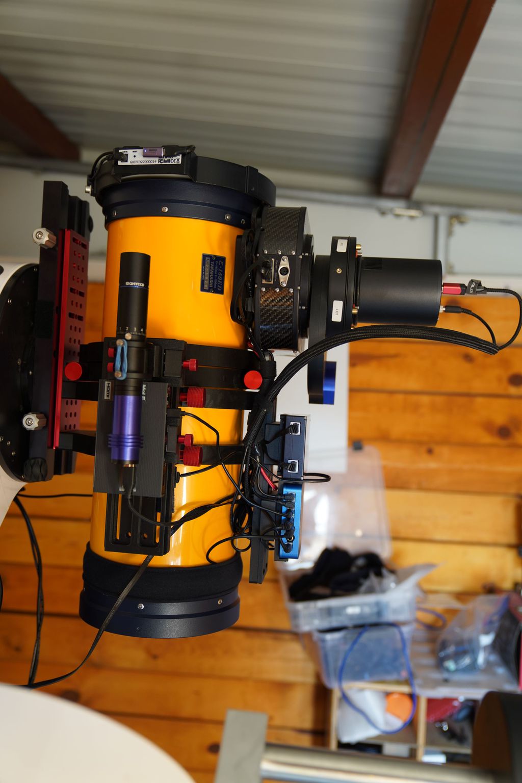

Replaced the bottom dovetail with a lightweight CNC one.
Aux plates to carbon with the carbon composite FDM rings.
Total of 3x aux. carbon plates - 4x rings.
Dumped 16lbs of weight.

Rouz Astro:
Questions:
1)  Do you know what the total weight of the system with everything shown is (male dove plate and everything "above it")?
2)  How well does the little guide scope work with it? I have never been a fan of guide scopes. Too flaky with differential flexure.
FYI, I have a lathe and mill so can do my own custom aluminum mounting parts with minimal weight but would use carbon where available.

Hi Bill,
Not sure about the reason for the little guider.
The initial  setup was  52lbs - that was with 2x dovetails.
We added carbon composite brackets for the Pegasus UPBV2, PPADV box and Mele.
2x extra rings to be at 90 degrees offset for the extra dovetails.
Also added 4 Losmandy sized carbon clamps.
And 2x extra Losmandy type dovetails to get.
After the extra bits, weight was 40lbs.
In terms of weight, its hard to beat.

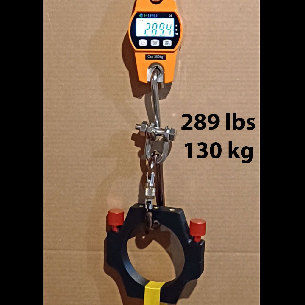

This was the most I could load -  tested on a small 4inch ring:

OK, I will have to stick with the 130. I am already at max weight with my present secondary system at 22 pounds -  40 would put me well over.

16lbs! That's a serious reduction.

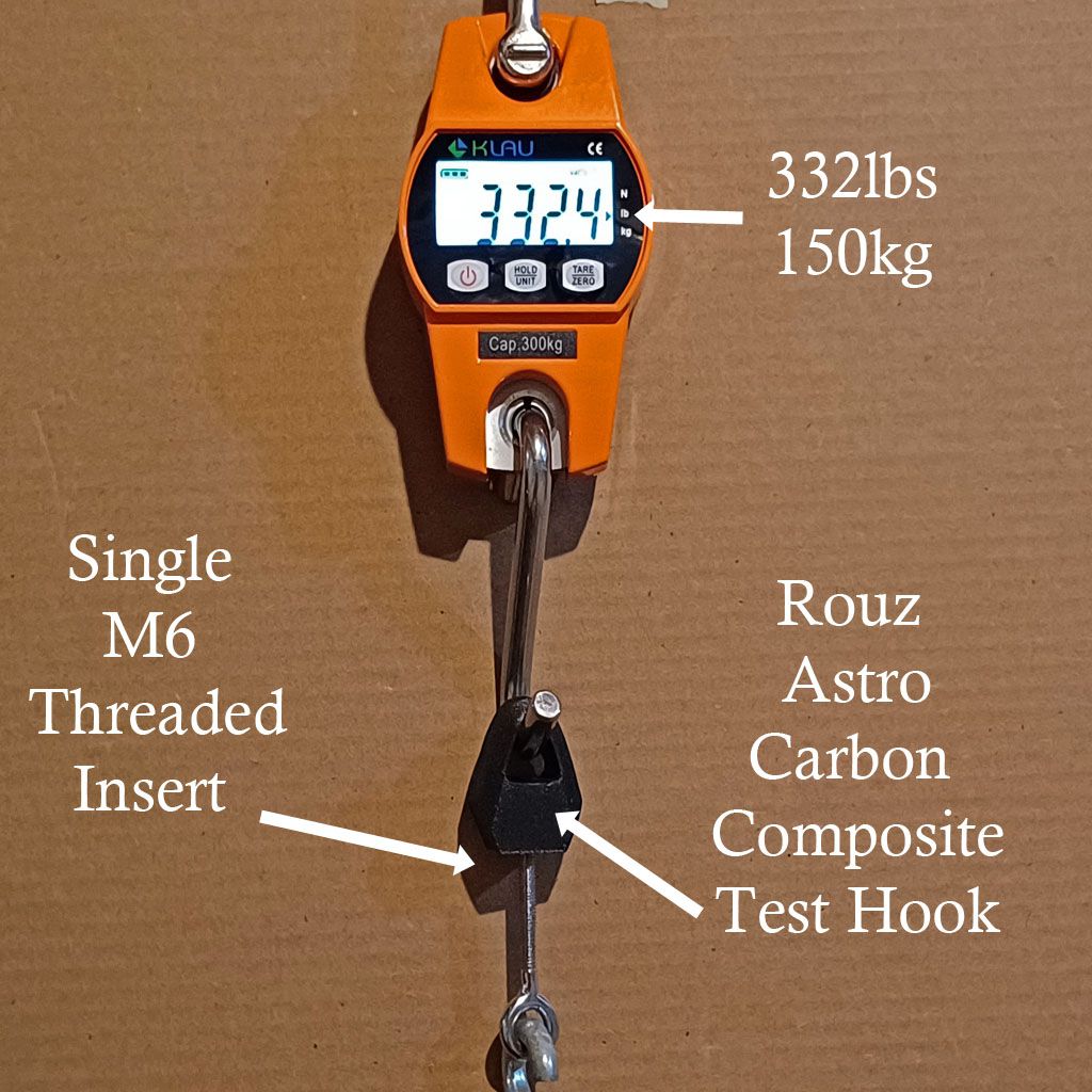

Was the test done to include the withdrawal force for the brass threaded inserts (I assume they are heat pressed into place)? If not, what was that number?
Rouzbeh 8.95
Bill McLaughlin:
Rouz Astro:
*Yes sir, another good question:
Rouzbeh 8.95
Here are videos on youtube for:
Tension Tests:
https://youtube.com/shorts/9IqkutjlHps?si=dmlJ--X83nVqXab8
Pullout Tests:
https://youtu.be/mIFxhEg7jpU?si=vGNB0c4jB41rTB4j
Impact Tests:
Perpendicular/Shear tests:
https://youtube.com/shorts/-qisC8mkPzo?si=kARSlZMkMtR-yXal

*Thank you Nick, your collaboration has been instrumental!
Much appreciated!

Thanks! That is way strong! I will put those on my list of items to buy. The scope is still several months out so I will probably wait until I know when it is going to show up.
