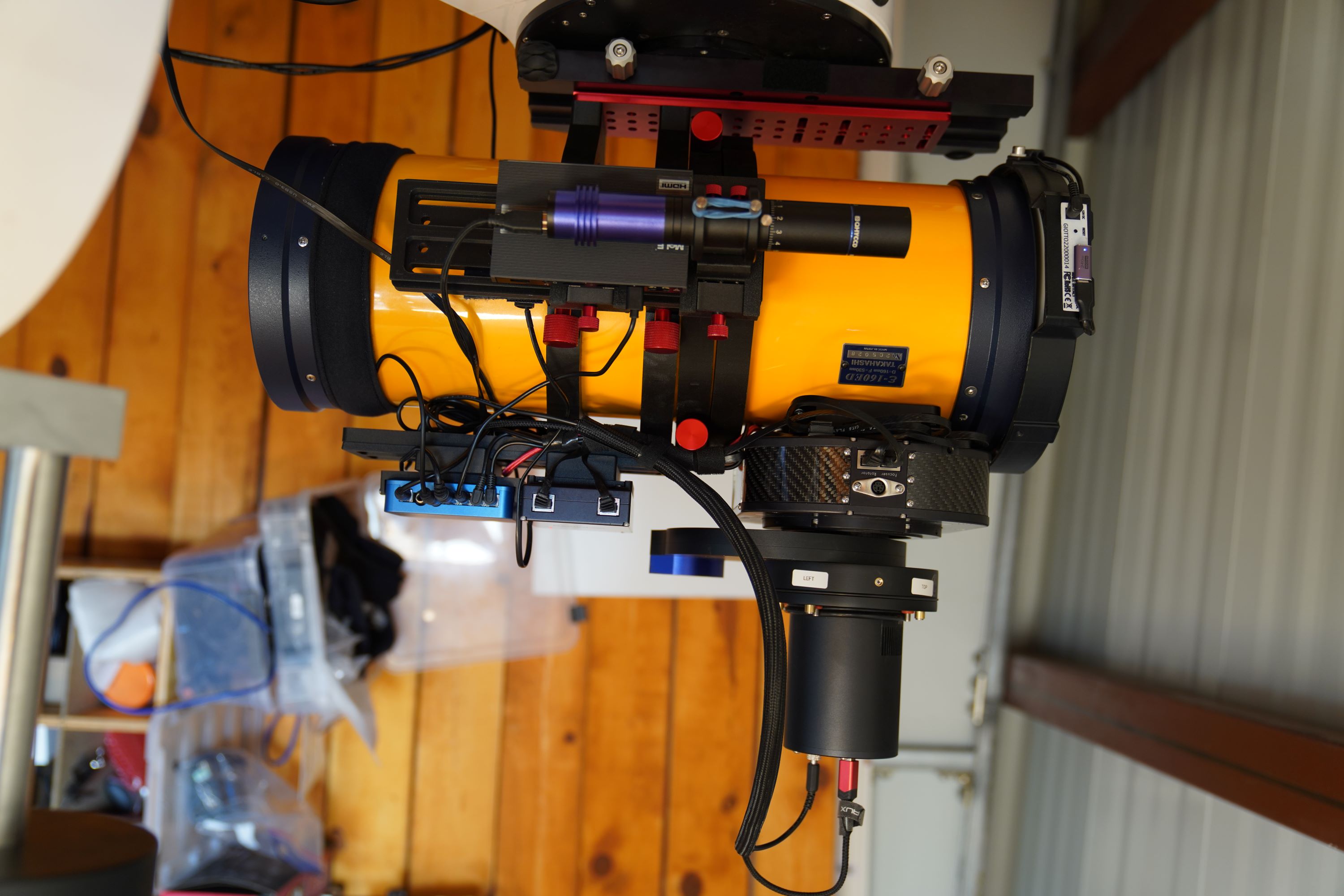

Replaced the bottom dovetail with a lightweight CNC one. Aux plates to carbon with the carbon composite FDM rings. Total of 3x aux. carbon plates - 4x rings. Dumped 16lbs of weight.  |

Rouz Astro: Replaced the bottom dovetail with a lightweight CNC one.
 Questions: 1) Do you know what the total weight of the system with everything shown is (male dove plate and everything "above it")? 2) How well does the little guide scope work with it? I have never been a fan of guide scopes. Too flaky with differential flexure. FYI, I have a lathe and mill so can do my own custom aluminum mounting parts with minimal weight but would use carbon where available.
Bill McLaughlin:
Dumped 16lbs of weight. Questions:
FYI, I have a lathe and mill so can do my own custom aluminum mounting parts with minimal weight but would use carbon where available. Hi Bill, Not sure about the reason for the little guider. The initial setup was 52lbs - that was with 2x dovetails. We added carbon composite brackets for the Pegasus UPBV2, PPADV box and Mele. 2x extra rings to be at 90 degrees offset for the extra dovetails. Also added 4 Losmandy sized carbon clamps. And 2x extra Losmandy type dovetails to get. After the extra bits, weight was 40lbs. In terms of weight, its hard to beat. There are a lot of mounting parts on the site - Rouzastro.comThis was the most I could load - tested on a small 4inch ring:  |

Rouz Astro: After the extra bits, weight was 40lbs. OK, I will have to stick with the 130. I am already at max weight with my present secondary system at 22 pounds - 40 would put me well over.
Dumped 16lbs of weight. 16lbs! That's a serious reduction.

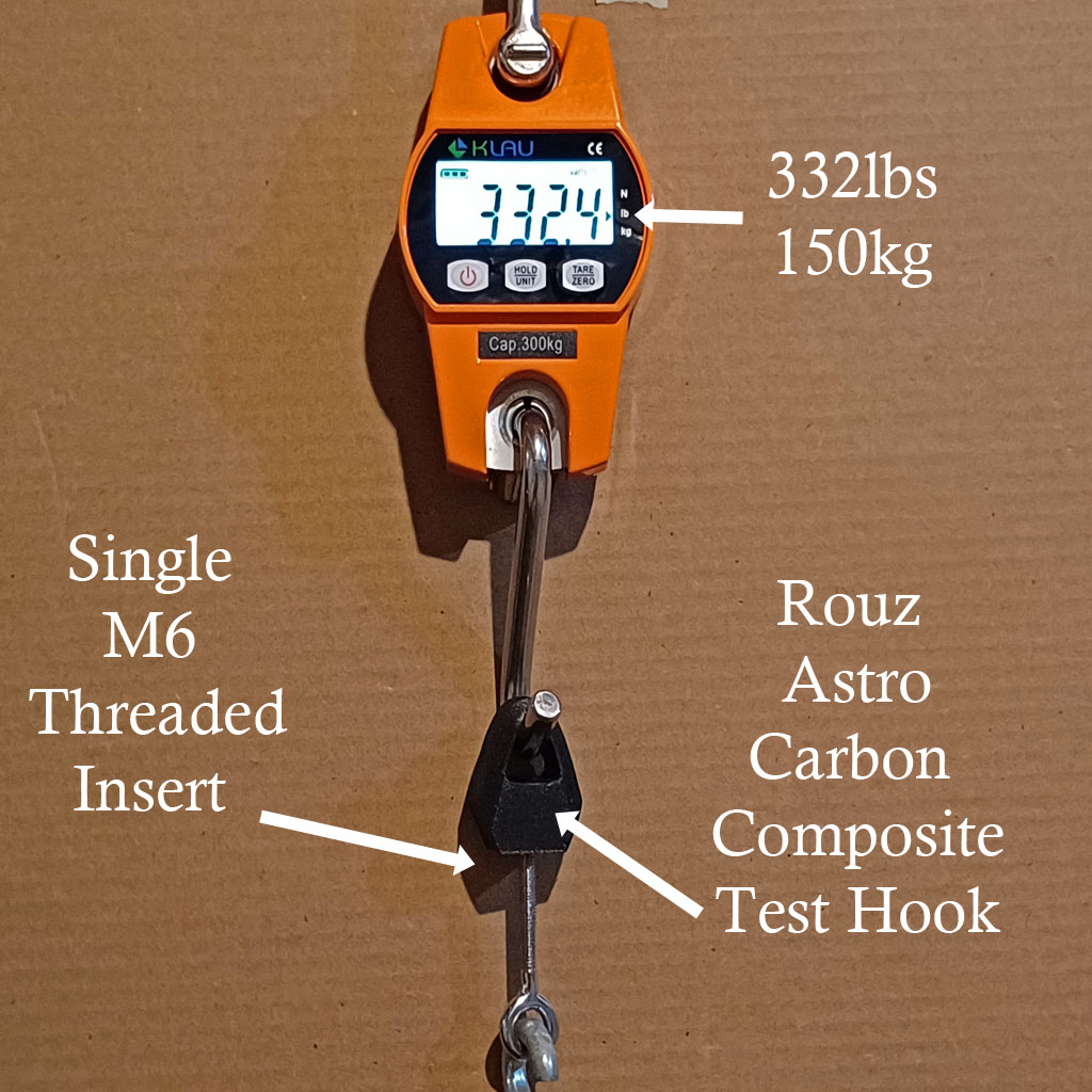

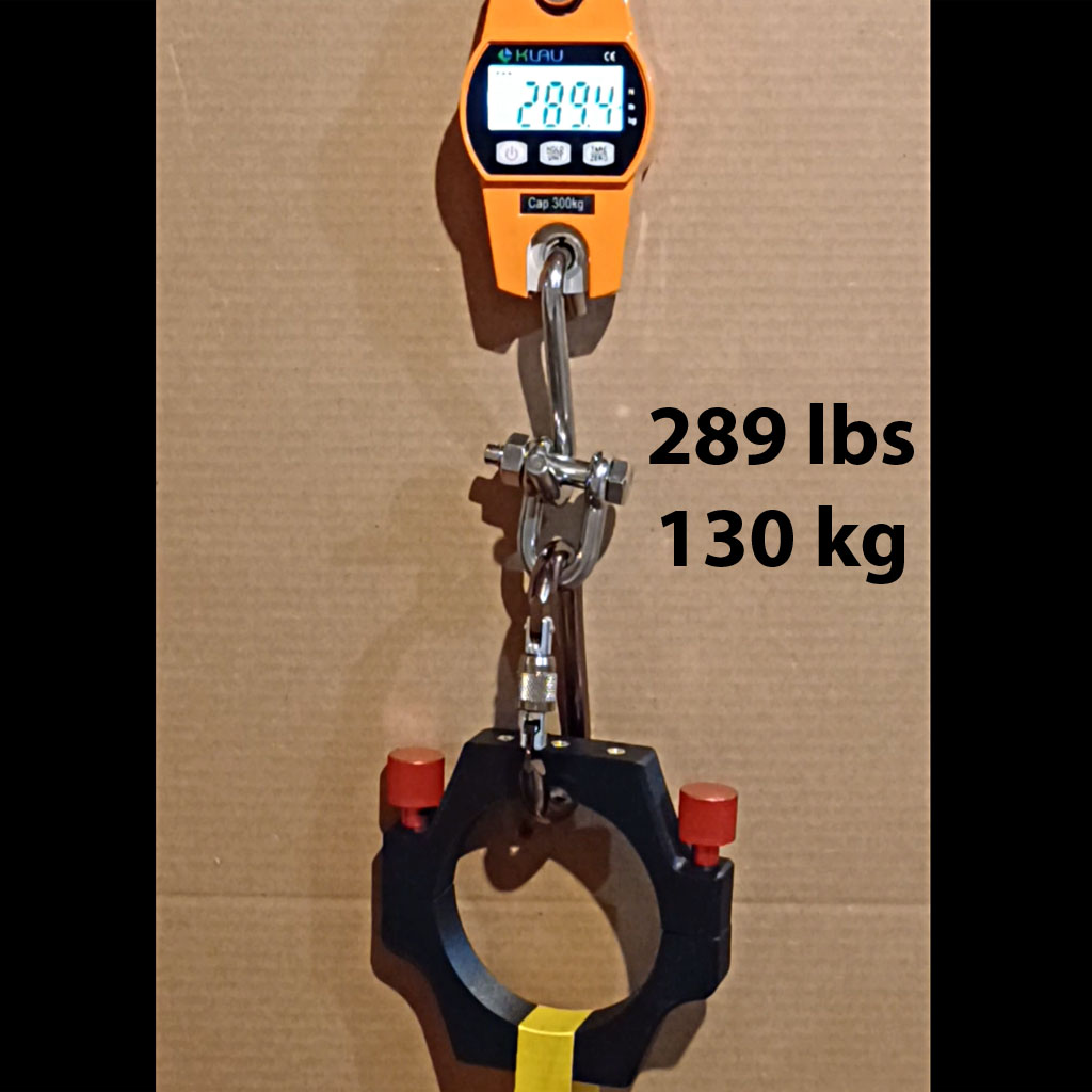

Rouz Astro: This was the most I could load - tested on a small 4inch ring: Was the test done to include the withdrawal force for the brass threaded inserts (I assume they are heat pressed into place)? If not, what was that number?
Bill McLaughlin:
Was the test done to include the withdrawal force for the brass threaded inserts (I assume they are heat pressed into place)? If not, what was that number? *Yes sir, another good question:  |
