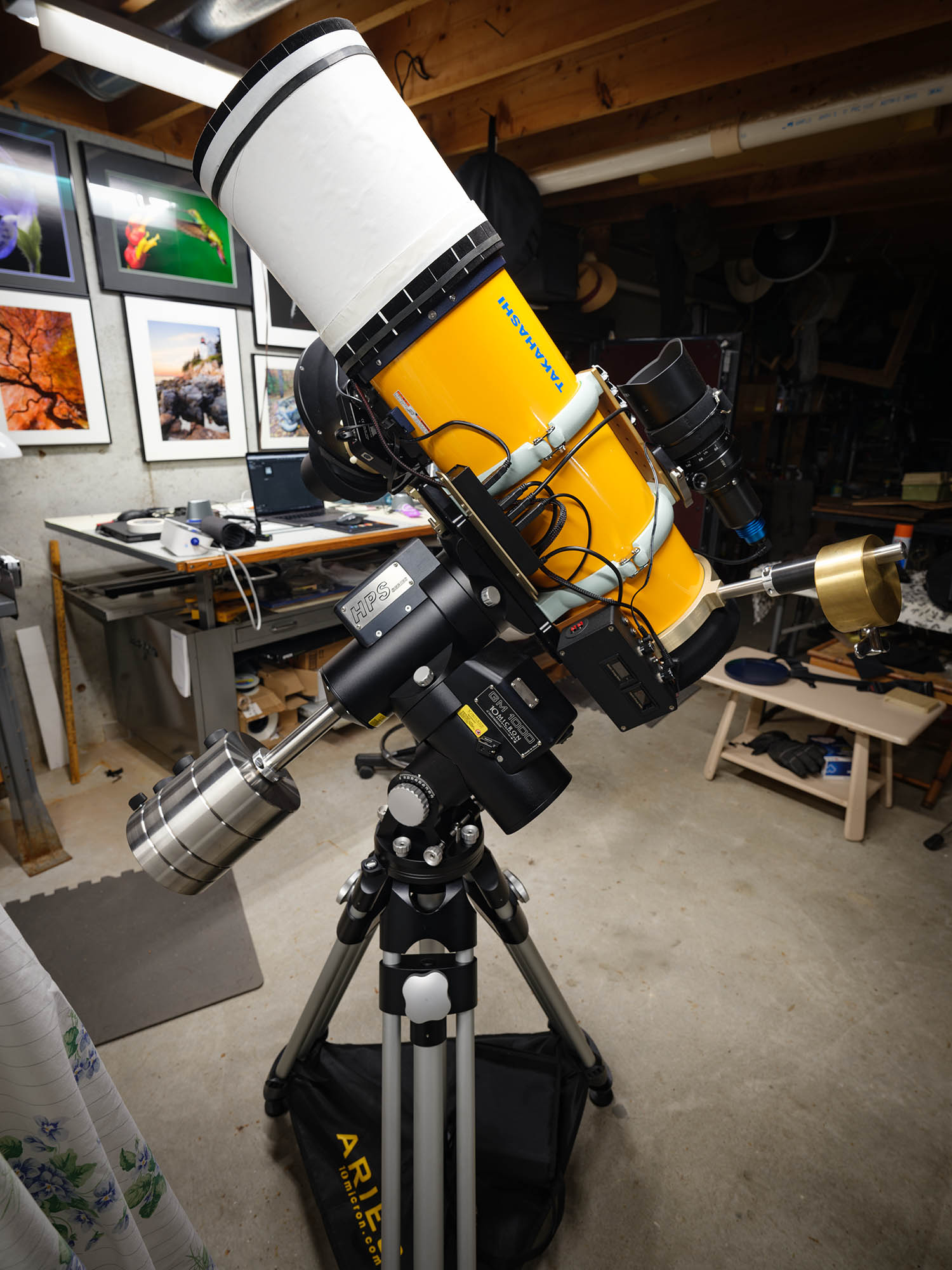

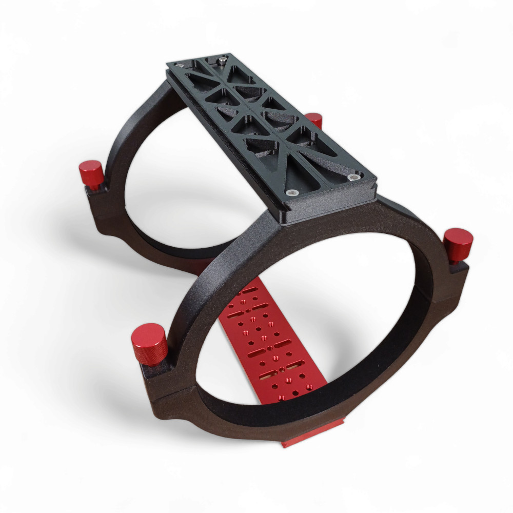

I have also worked with Optec and other Epsilon users to develop solutions for the Epsilons with Optec's Leo focus which has tilt correction as well.
Also, a lightweight mounting cage that consists of carbon fiber FDM rings and accessory top dovetail and CNC aluminum bottom dovetail.
You get a good amount of aperture in a compact and lightweight package.

Cage

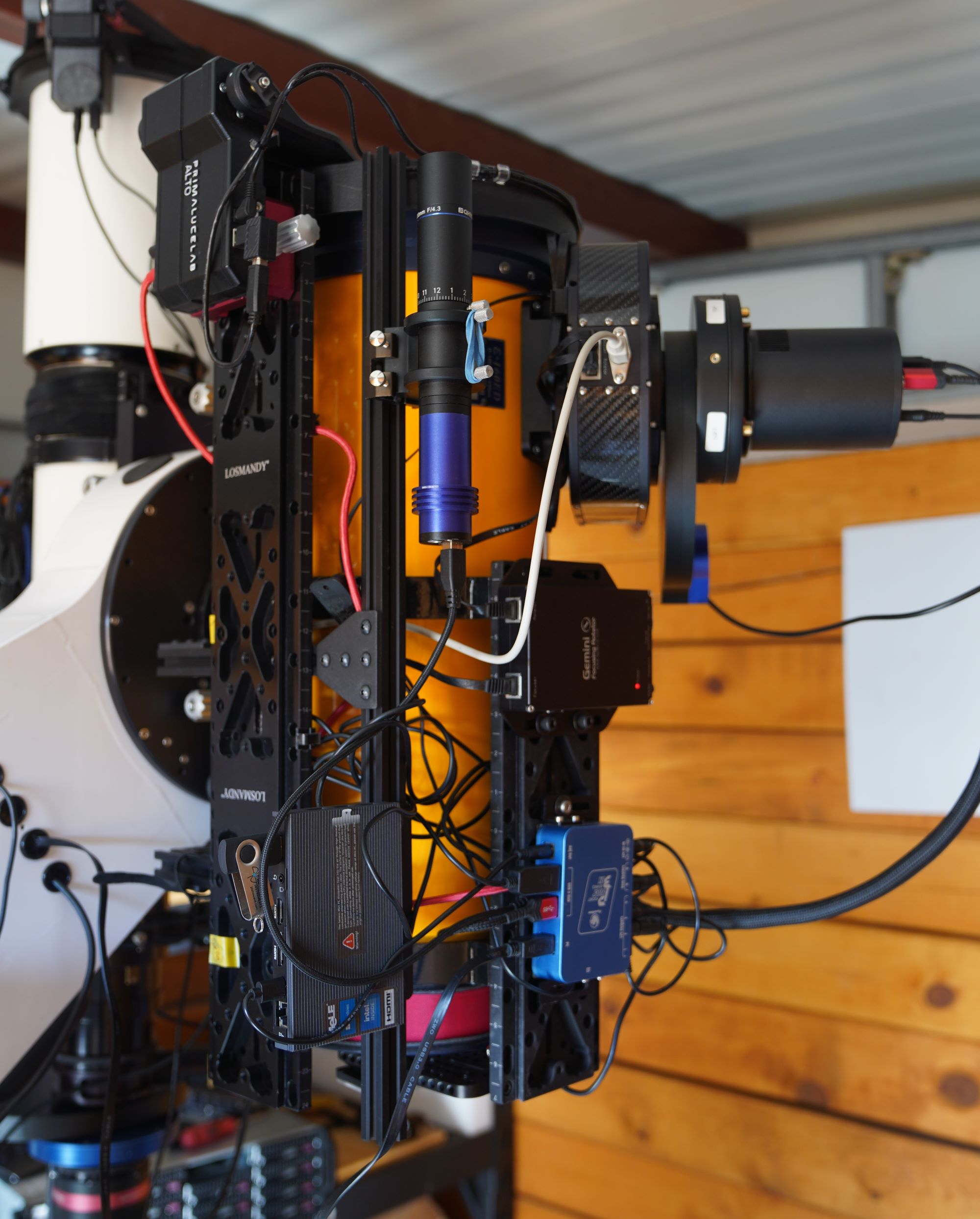

Rouzbeh 8.95
Here is Nick's setup, his input was instrumental.
He later added the Leo focuser to the setup
