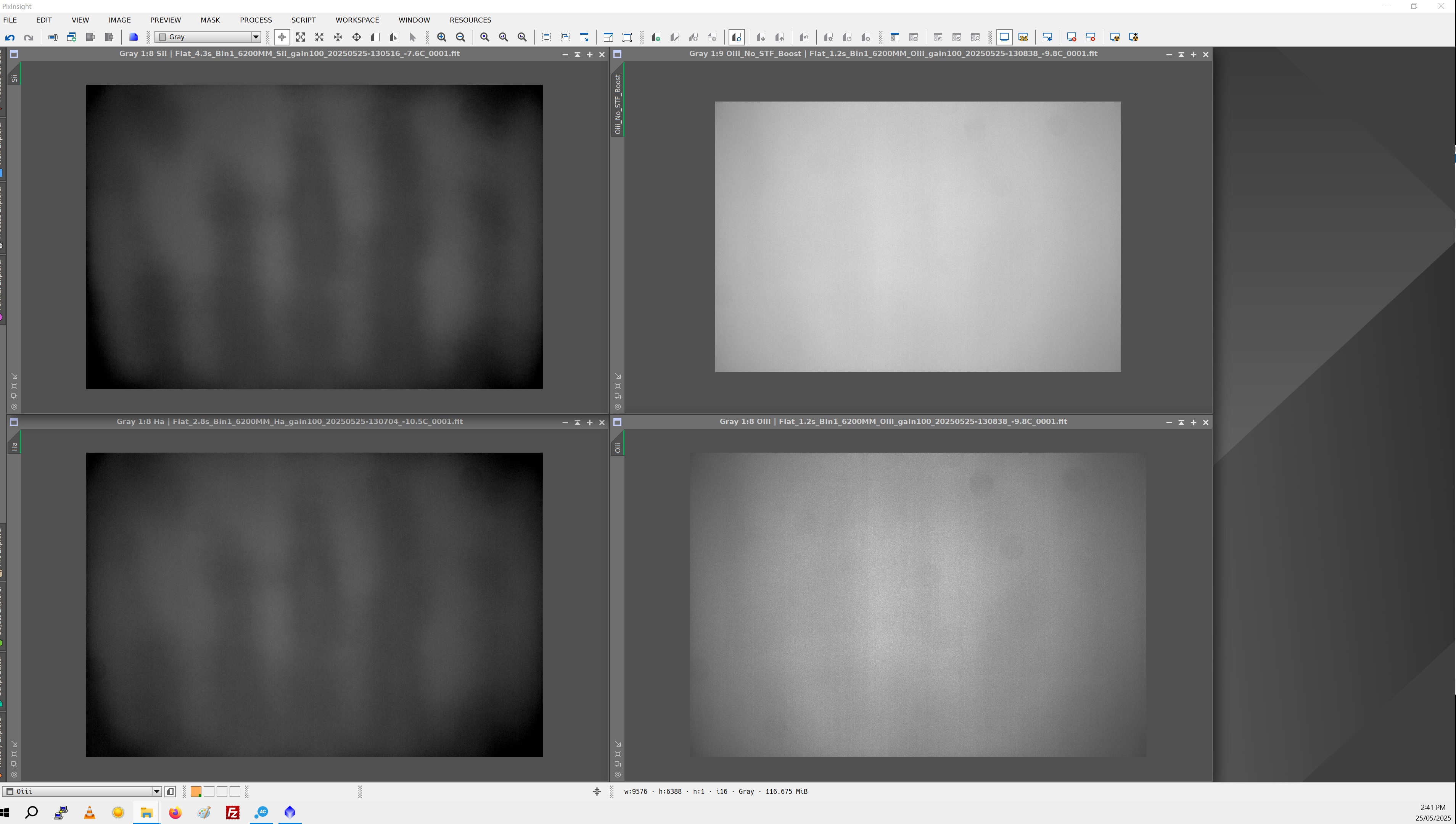

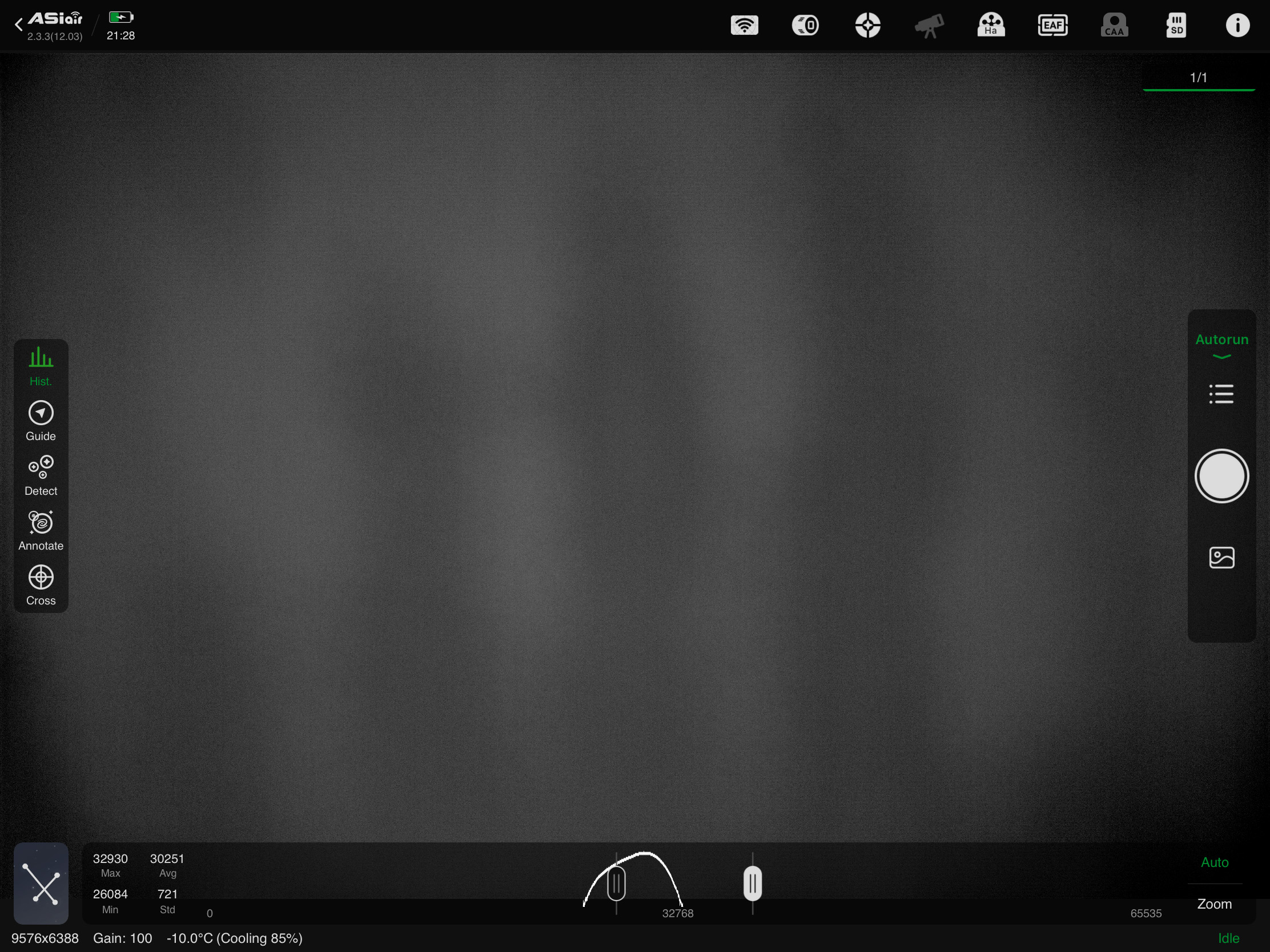

Im currently using an Askar FRA500.  I was using a ZWO 2600MM and Antlia filters prior and never saw what Im seeing at the moment.  Went mad and purchased a ZWO6200MM, FW and 50mm Antlia filters.  I took a 300s dark frame when I put it all together and no light leaks.  Thought Id  take a flat and see what the vignetting is like.   They look like I took an X-Ray of some ones fingers.   So I thought it has to be the panel.   I use a plastic bag, opaque perspex then a trace panel to do my flats and had pleasing results previously.  I then purchased a Giotto flat frame generator and still have a weird flats.
The scope is a petval and is at correct focus as I took some 5min subs on Carina with each filter and they look ok to this non guru.
Unsure if I installed the filters in reverse...  Pattern stands out more on Ha and Sii.  The FW has a 54mm opening at the rear and my adapters screw straight in.  I checked prior to see If the adapter would snag and scratch the filters before putting the FW on the camera etc.
I have attached a couple of pics.  I also have a safe link to one drive if a guru had time to take a look at my lights etc.  Maybe its all due to flat panel/s..Or my scope cant handle the a FF camera.
Maybe some one has encountered this before?  Appreciate your time.  Regardshttps://1drv.ms/f/c/ddfc7008f79a866e/EoZXIKkdT3JJl53GH842zYwBMcIXR_LqV8smhkfc1fb5DQ?e=otX7T0Ha Tablet Screeny.jpg

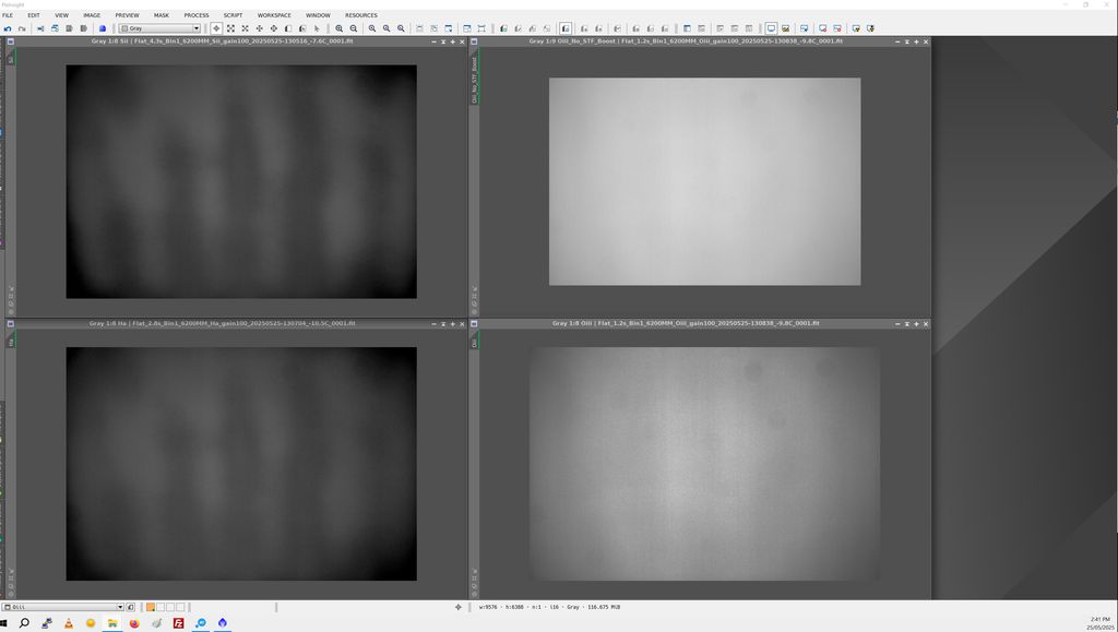

The attached pics are just flats taken inside with flat panels.  One with a trace panel the other with a Giotto.

Yes the bottom pic is an STF stretch from PI.  The top pic is just a screen grab from my Ipad showing the same pattern on Ha and Sii filters.  The scope is at the same focus from a couple of nights ago when I took some 5min subs of Carina for a test.  I did cool the camera as well whilst on the bench.  I could try 0 gain.  Was not sure of that Lum filter; so hard to tell if I placed it into the FW the correct way.  The fits are in the link which look pleasing enough.  Just wondering if that pattern though will effect the stacked image as well.  Just not sure.  The pattern is very dominant in the Ha and Sii.
As always the question is, do they calibrate properly?

My Ha flat is waaaay worse that any of those and calibrates out just fine. You'll be all right, I'd reckon.

I recently upgraded from the 2600MM to the 6200MM as well and noticed the same vertical pillar patterns in my flat frames. I used the exact same flat panel and very similar settings as I did with the 2600MM, so I suspect the artifacts might be inherent to the camera itself. That said, they don't seem to cause any issues during calibration. My calibrated images still look fine even when using these "pillar flats." Still, I wonder if this pattern could be considered a defect.
Or maybe the IMX455 just naturally has worse consistency than the IMX571 and tends to read out those pillars.

I got a similar pattern with my IMX533 mono chip when taking flats with Ha and SII. Until now, I did not check in detail where it is coming from. At the moment I skip flats for those filters as I struggle to get good calibration results. I think that the narrowband filter in combination with the small pixels is the issue (intrapixel etaloning?).

My flats look "blotchy" (not necessarily fingers, though) when taking NB flats of a refractor with excellent coverage.   Since there's little fall-off from the center, it shows every imperfection in flatness or unevenness of the filter or scope or camera.   But if you look at the actual differences between values (or look unstretched), they are actually very even and calibrate just fine.    You would never see these patterns in a DSO subexposure since the stretching covers a much larger range, swamping the subtle patterns.

I too have a Player One Zeus that I just put together with Chroma filters and have strange patterns in my Ha, Siii, and Red filters.
It looks like there's variability in the QE of the pixels on the IMX455 in the longer wavelengths.

This is completely normal.    It's only an issue if they don't calibrate properly.    Source: I went down this crazy path once.
