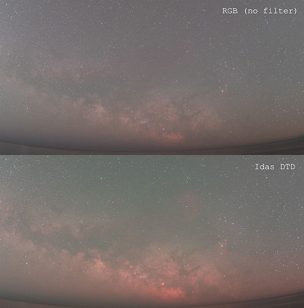

Comparison between an RGB (11mm, f2.8, 30 seconds, iso 1200) shot and a DTD shot (11mm, f2.8, 120 seconds, iso 2000), with WB correction.

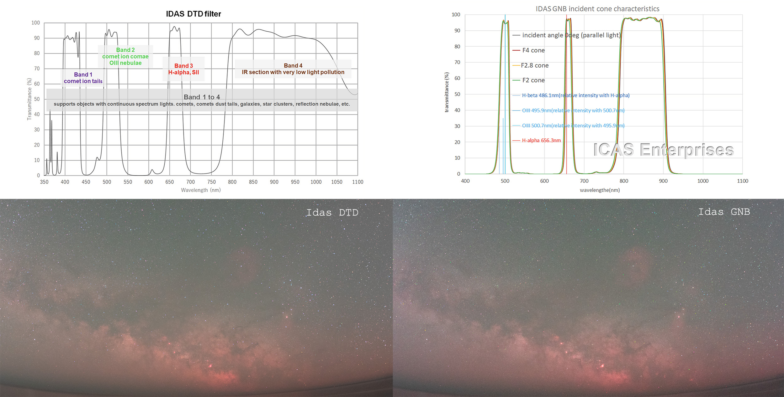

Comparison between the capture graphs of the Idas GNB and the Idas DTD, and between the capture of information from the Milky Way between the two filters. Parameters of the Milky Way photographs: 11mm, f2.8, 120 seconds, iso 2000 for the DTD photo, and 11mm, f2.8, 120 seconds, iso 2000 (+ one and a half stop exposure compensation to match the DTD shot) for the GNB photo. Both ewith WB correction.
