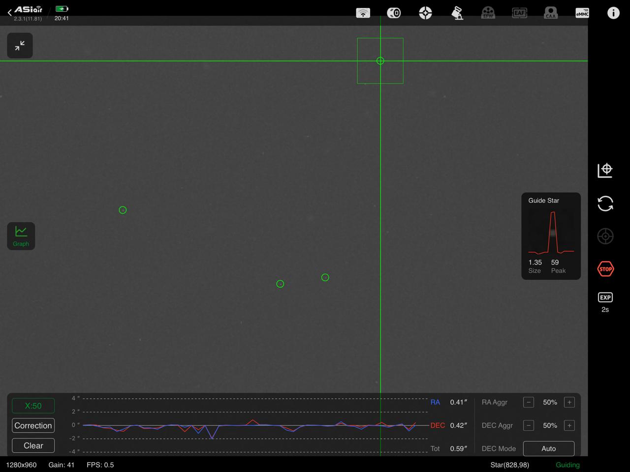

apalsikar 0.90
I have not tried OAG sofar and am using a 60mm Guide Scope with ASI 120 MC as Guide camera along with my AM5N mount.
While initially the guiding with ASI Air was bit of any issue but through trial and error was able to get this resolved.  Now guiding is decent all across and am trending at overall error of 0.5".  This is pretty decent and am not sure if an OAG will significantly improve the guide performance.  Would request feedback on comparison of performance using Guide scope+Camera vx OAG.

KGoodwin 4.71
Aloke Palsikar:
The difference in using a guide scope vs an OAG is not to be seen in the guiding stats.  In either case that will depend generally on the seeing and the mount quite a bit.  The difference is in the images.  If you're guiding with a guide scope and the FWHM in the subs seems higher than it should be or especially if the guiding graph looks good, but the eccentricity in the subs is high (> 0.4) then you may have differential flexure, which could be improved by using an OAG rather than a guide scope.  With a guide scope what you're guiding is the guide scope itself.  If there's flex between the guide scope and the main scope then the main scope isn't doing exactly what the guide scope is.  So you can have excellent guiding on your guide scope, but not get those results in the final images.  The OAG approach has you guiding the main scope directly.  Whatever the OAG see is the same thing the imaging camera sees (just a different part of the field), so it's inherently more robust as you're guiding the thing that's imaging directly.
