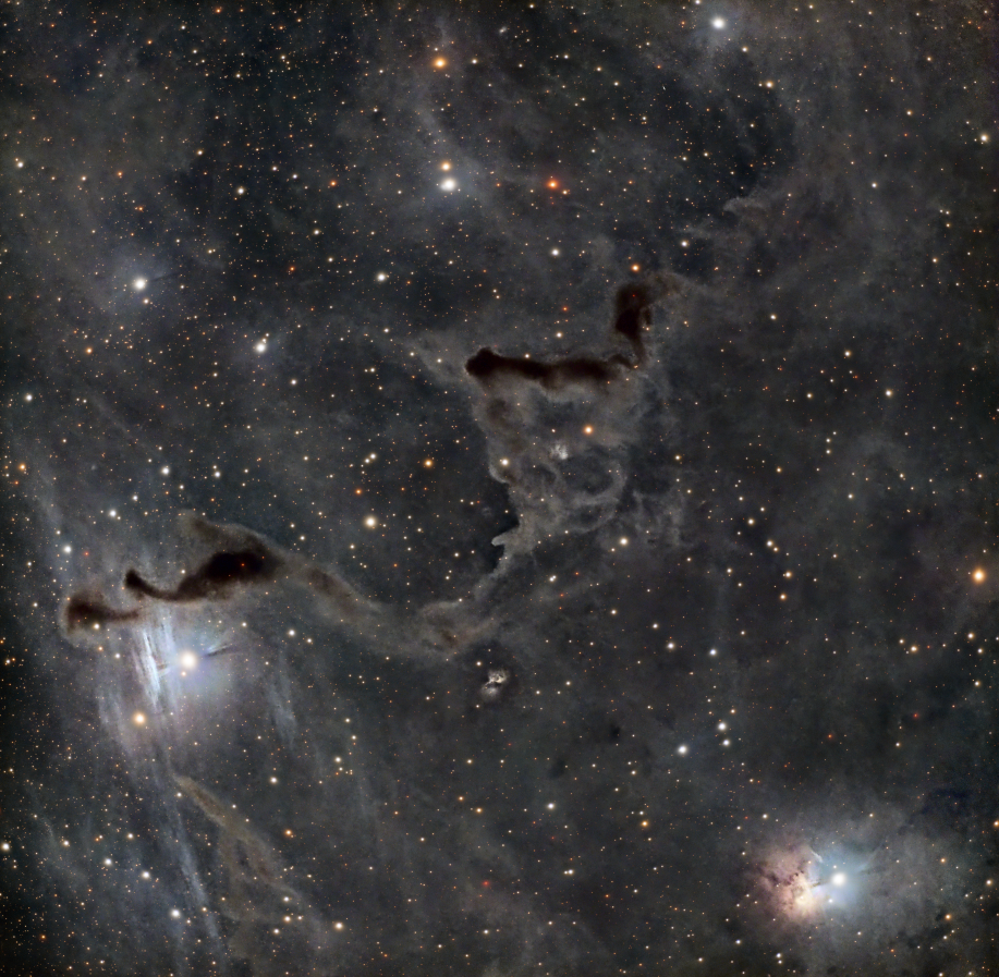

This was very interesting to read. I have just drawn a 100+ hour project to a close due to the excessive diffraction problems I am seeing with my Z4. LRGB, all filters. It has definitely been much worse past 2 months with quite a few sub-zero nights here in the UK.
Bigger / brighter stars with the scope have always been a little "wonky" even (as you stated) when it has not been that cold... but I always put it down to me and / or a problem with how I was capturing / processing. But the problem is clearly scope related.
Of course it could be some protrusion in the scope (seal, baffle, spacer etc) but it has gotten so bad since late November, I am sure temp is a factor. I too am discussing with FLO right now... and have provided sample images / test shots etc etc. Hoping this is something that a skilled scope dude can tweak on their work bench.
Really do not wish to lose the scope... small star detail, star count in general and picture detail is phenomenal... and it focuses like a dream. Fingers crossed!

I hope they get it sorted for you! I've had nothing but good experiences with them overall. I was considering the Z4 for myself in 2023, but I wound up getting the Esprit 100ED in stead which I am very happy with!
I'm sure I mentioned it in a post somewhere before (maybe here), but I always found it a bit werid that the Sharpstar website advertises this scope with fake spikes in the images unless they had something to hide..

Yes, I saw that note from you also... that is a bit strange. Funnily enough, I never spotted that before so never questioned.
Problem is quite easy to see below... as the stars become more prominent, so the issue becomes increasingly worse. (No post stretch star reduction has been performed)
I am never fussed with surrounding star glow or halos even... in fact I like the bleed into the surrounding dust (I tend to do dusty pics lol).
But the tattiness around the edges which increases to the diffraction does need the investigation. Pointless to try any processing technique of course as it is baked into the background.
FYI, the increased red is from use of Antlia R+ filter which offers enhanced IR. The irony here is that I think the small (even tiny) stars are fantastic hehe!
