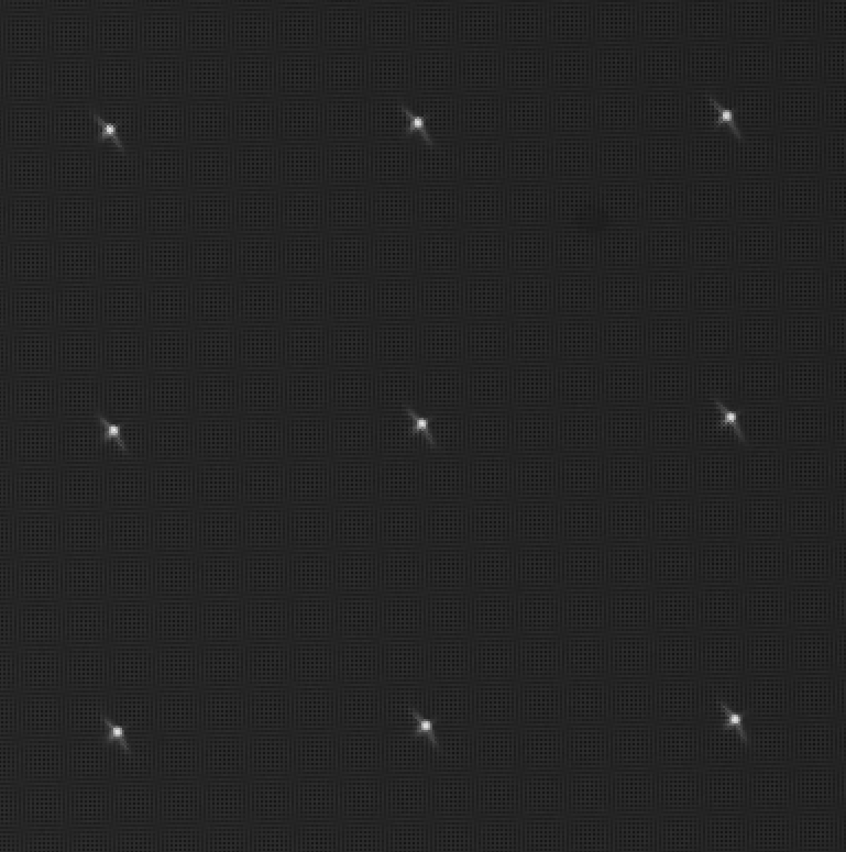

during a backfocus tuning session for a new Sigma 50mm 1.4 Art lens, I found out that when it was used together with a cooled astro camera (I used a Touptek 2600 Color), it generated visible astigmatism in the corners (Picture 1). This happened always in the backfocus range of 44 to 45.5 mm. I tried removing the filter that was placed between the lens and the camera, but the astigmatism persisted.

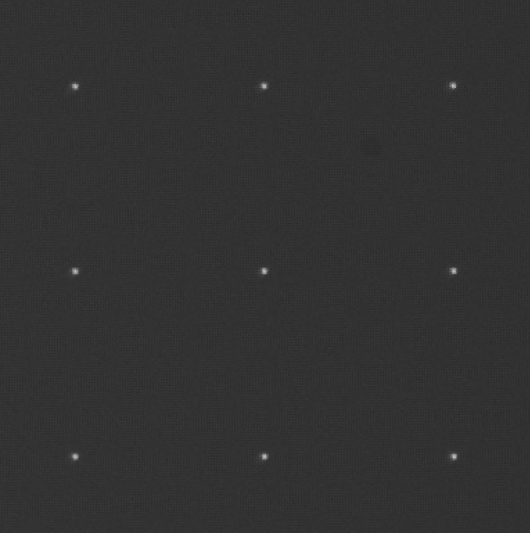

Instead, when I mounted the lens on a modded Canon 77D body, the astigmatism in the corners disappeared (Picture 2).

Picture 1: Image corner with Touptek TS2600 Color + Sigma 50 1.4 Art
Picture 2: Image corner with Canon 77D + Sigma 50 1.4 Art
It isn't astigmatism, I bet it is some quirk of the AR coatings in those cameras (which, given your experience with them, seem best avoided).
