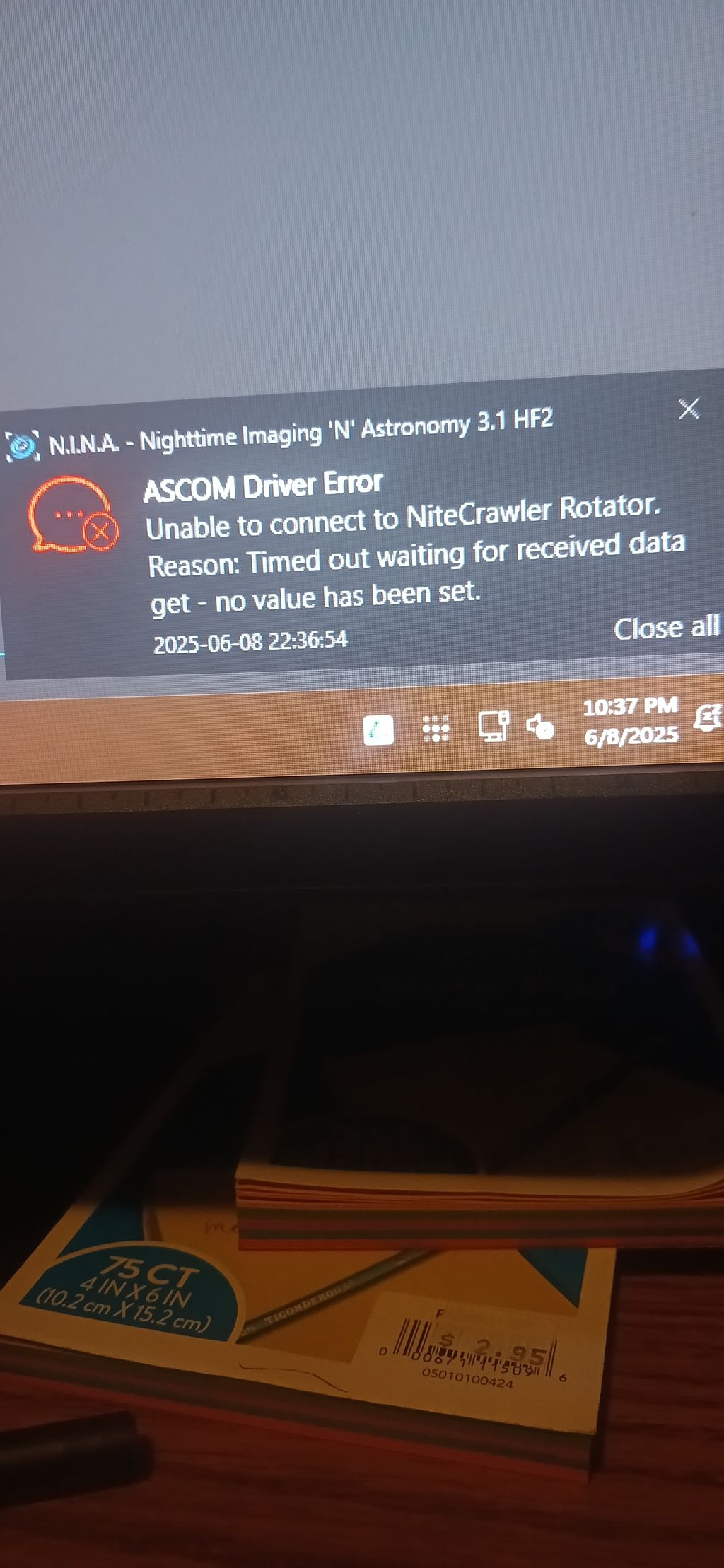

I'm getting this message below when I try to connect the Moonlight Nightcrawler focuser/rotator to both NINA and to the Moonlight Remote software. I am not having any issues connecting the camera, flat panel, filter wheel, which are also ASCOM. I've tried restarting and rebooting computer but to no avail. Windows 11 device driver looks fine, all com ports are working properly, I ran an ASCOM diagnostice test and every test succeeded. Damn, another clear night lost to tech problems. I don't know what to try next. I had it working earlier today. Anyone have any ideas? Thanks, Jerry  |
