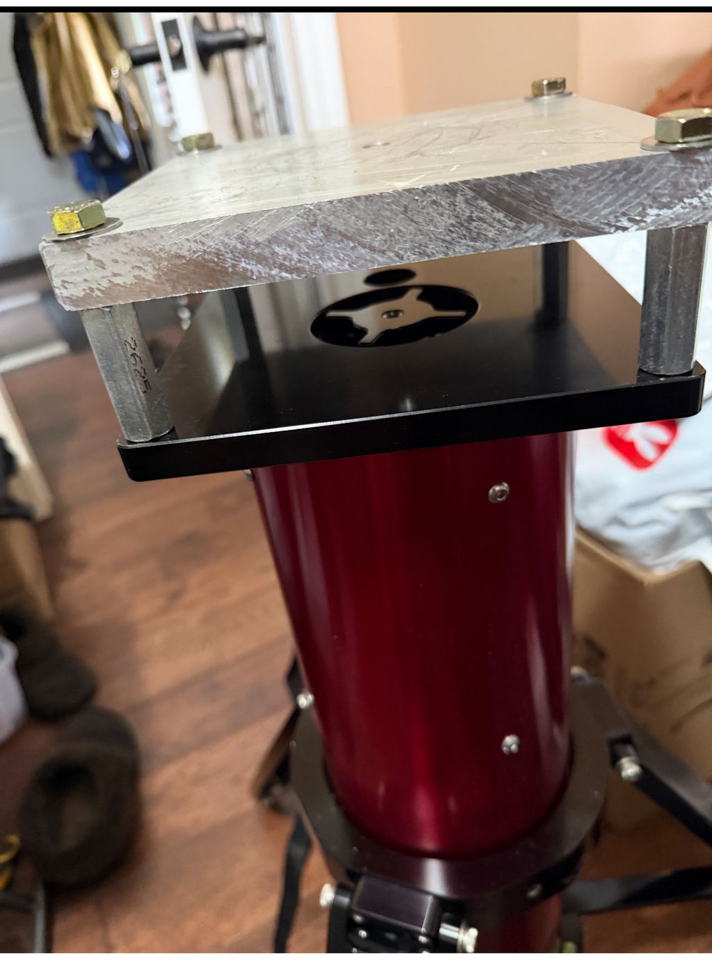

I bought a used paramount MyT tri pier for use with my mounts using a 3/8" bolt. I cut an aluminum plate and fastened it using bolts and connectors for spacers, but I would rather have bolts that I can tighten without needing a wrench. Bolts with a large plastic knob or star shape would allow hand tightening and not require a wrench. The only ones I can find are too short or the wrong thread pitch. The pier uses a 3/8" and 24 thread pitch which is not popular. The bolt needs to be 4" long. Does anyone have suggestions of where to find such a thing, or will I need to make my own? I've included a picture of the setup.   |

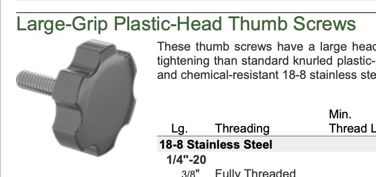

John Hayes: https://www.grainger.com/product/3GER3?gucid=N:N S aid:GGL:CSM-2295:6VHHZD:20500801:APZ_1&gclsrc=aw.ds&gad_source=1&gad_campaignid=21369464100&gclid=Cj0KCQjw1JjDBhDjARIsABlM2SsbtOZbbc4QXUPAvi1VRGpsqvwb6PGFkN6yWp1nKO3PHEBWiIDkijYaAkZiEALw_wcB
This sort of snap-on knob will simply attach to your existing bolt head and turn it into a knob. You just have to be sure to buy the right size.
