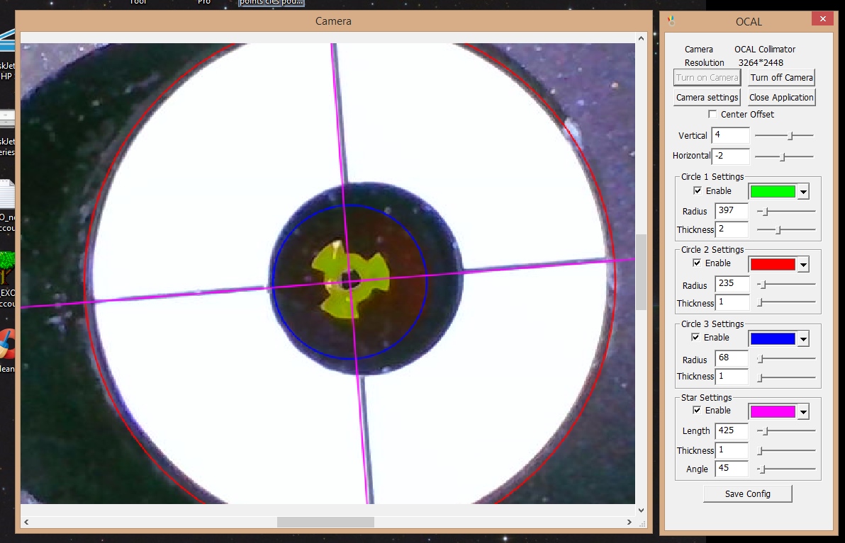

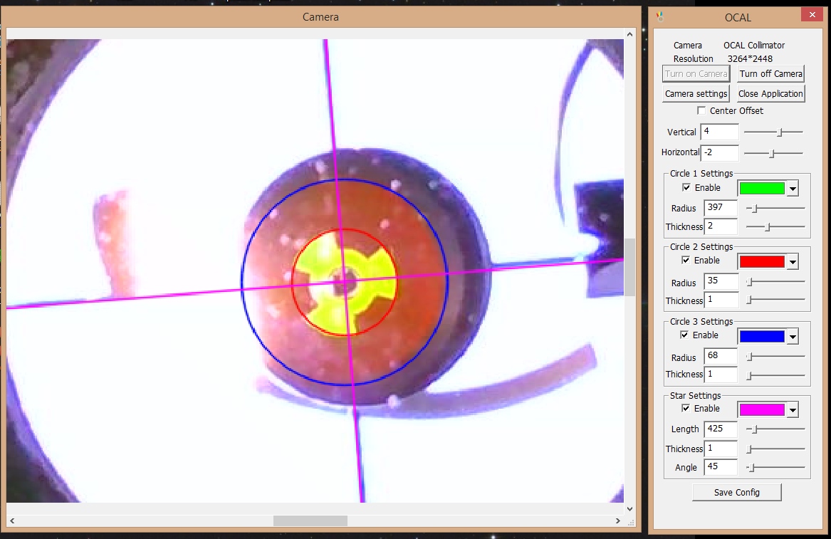

The challenge I am having is that when I get the outer green circle perfectly centered using the center offset, then the innermost circle is not centered perfectly. What I need to know is which circle is most critical in terms of being centered using the vertical and horizontal offsets? Once I know that, I can then collimate easily. Here's a photo: As you can see, the green and red circles are centered, but the innermost blue circle is not. Should I proceed with collimation or should I center the innermost circle as in the 2nd image:   |
