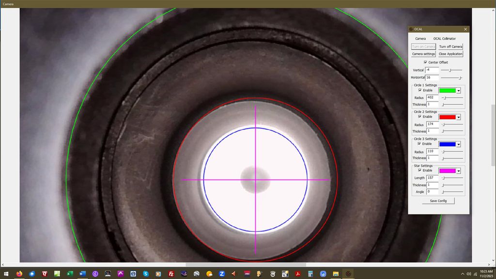

The challenge I am having is that when I get the outer green circle perfectly centered using the center offset, then the innermost circle is not centered perfectly.  What I need to know is which circle is most critical in terms of being centered using the vertical and horizontal offsets?  Once I know that, I can then collimate easily.
Here's a photo:
As you can see, the green and red circles are centered, but the innermost blue circle is not.  Should I proceed with collimation or should I center the innermost circle as in the 2nd image:

I don't think I can do better than this, but still haven't yet been outside under the stars to verify results. I still don't understand what the "tilt" and "pan" functions are on the camera settings with OCAL 3.0.  They don't change anything in the image as I move the sliders around. Also, what is the "backlight" function for?  Again, when I turn it off and on I see no change at all in the image. JerryOCAL 3.0 Collimation Resuts 2.jpgOCAL 3.0 Collimation Resuts.jpg
