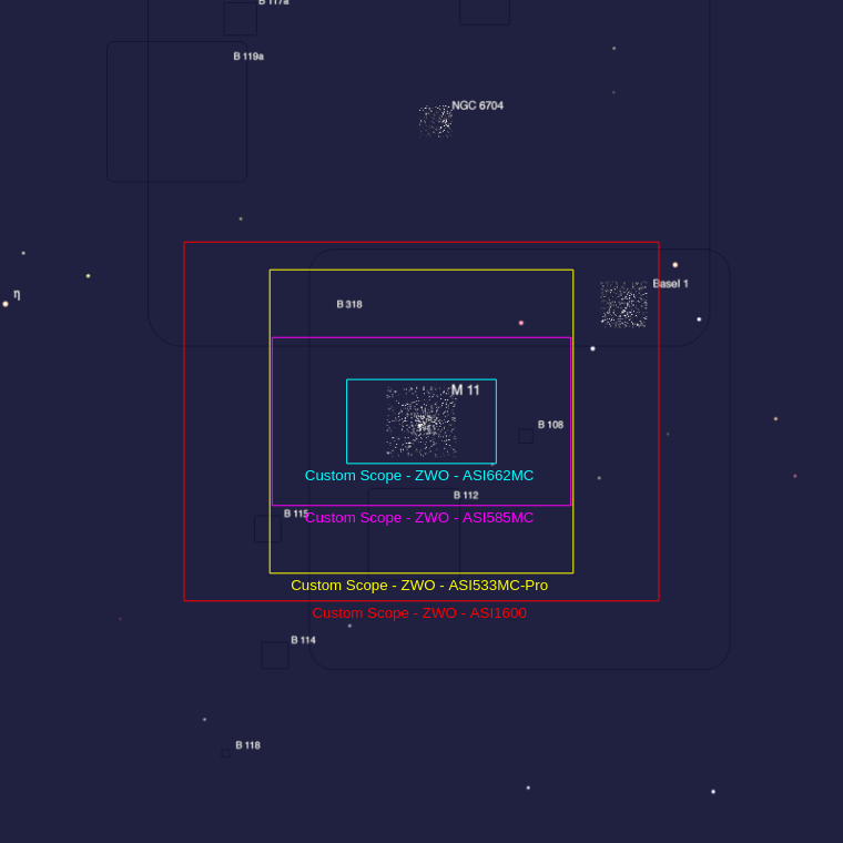

Now, you want to paint a deep sky field that has been captured with the 1600MM, it will take you so long you might as well use your filters. Unless you go for the 533 which is still a bit small but much closer (the graph says Pro but it doesn't matter for FOV). I put a 600m focal length to produce this graph btw.
