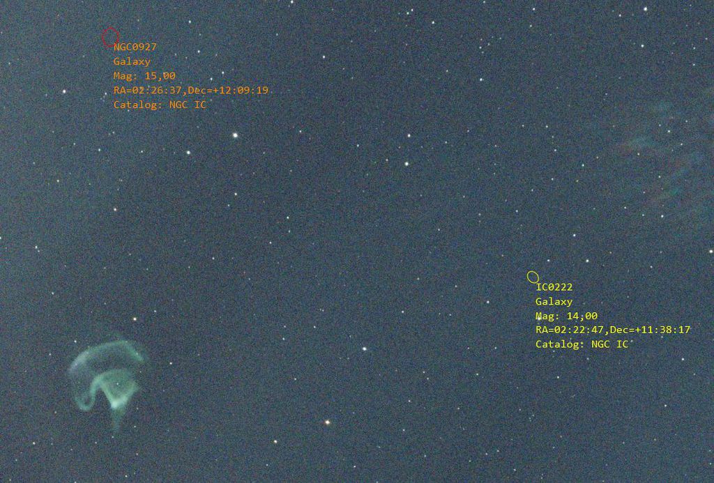

Last Sunday on a cold winter night I tried to position my mount precisely to the north. Since the Polar Star is not visible at my observation location, I tried an alignment on Jupiter. I was 6 degrees off from Jupiter and tried to bring the mount in using PlateSolve. I discovered a very noticeable object, which I originally thought it was a reflection of Jupiter. It was about the size of the Medusa Nebula and very noticeable with Hyperstar on the C11 with ASI2600 at 5 seconds exposure and auto histostretching in SharpCap. Unfortunately the weather is bad for my observation location for the next few days. This means I can't check exactly. There is no object noted in this area in Aladin.
Now I'm no longer sure whether it was just a reflection and would ask you to take a quick look.
The object was with my equipment in the same field of view as one of the listed objects. Unfortunately, I can no longer say exactly which object.
Either: NGC 927, IC 222, NGC 990, IC 238, NGC 1024
I would be very grateful if someone could briefly check these objects to see if the object I mentioned is in the same field of view.
Request for feedback.
Kind regards,
Bernd from Austria

Could you highlight which object you are talking about ?
UnendlicheWeiten 0.00
Unfortunately, false alarm. I suspect Jupiter just cheated his way into the picture here.
@Spacetime Pictures  Thank you very much for the clarification.
Unfortunately, the object I described is not visible in your two photos. I suspect that I only saw a reflection of Jupiter back then. Thank you again for your efforts.

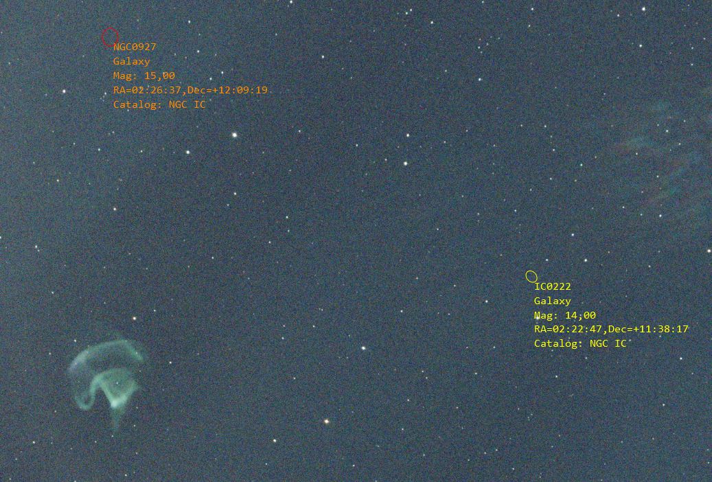

So, the mystery of the strange object near IC222 has now finally been solved!!
It's just a dominant light reflection from my f2 hyperstar system, which only appears so prominently in exactly this area of ​​the image.
spacetimepictures 4.82
Optics are weird smile
