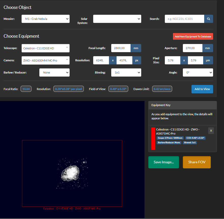

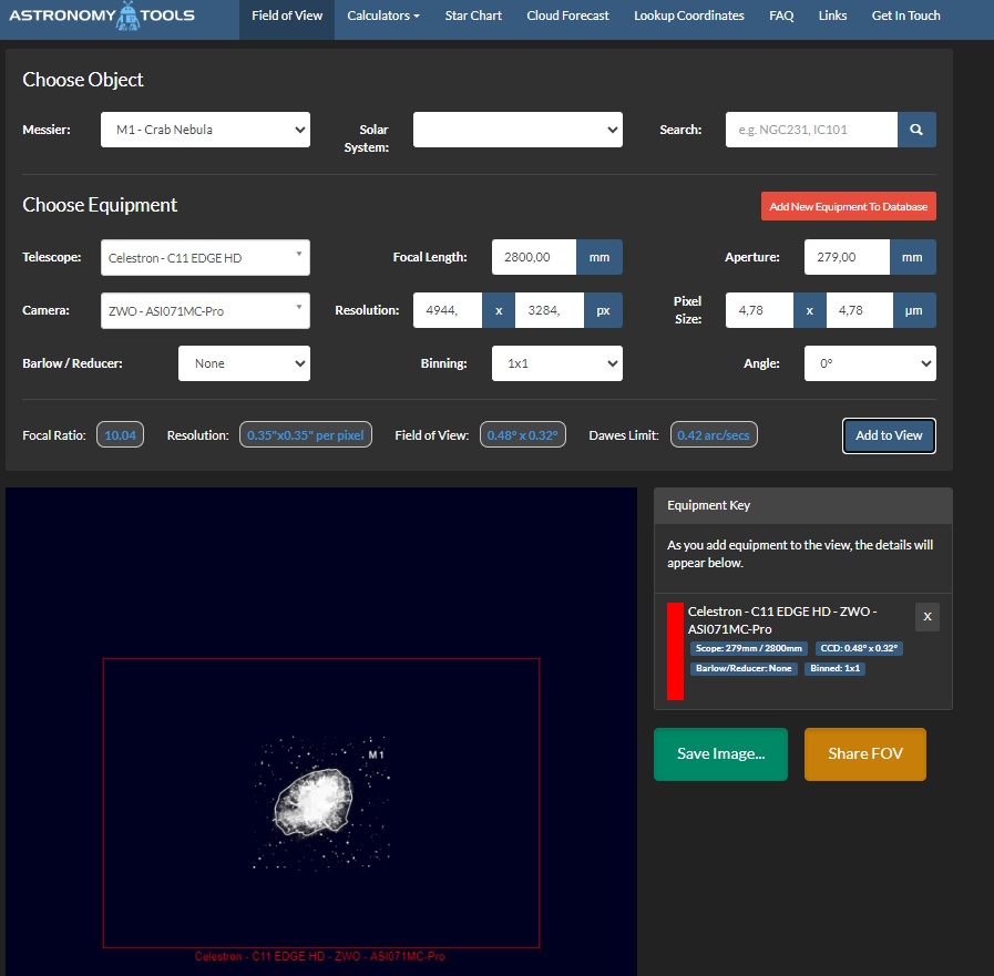

Just a couple of things to take into account if you are using the C11. With the 071, you are already pushing the resolution to the limit with 0.35'' per pixel. With the ZWO 2600 you are pushing it further down to 0.28'' (the benchmark is usually between 1'' to 2'' unless your skies are perfectly stable, I tend to think it is not the case in Houston). A good match for such a long focal length telescope would be a camera with a big sensor size , say higher than 6 microns' unless you are using the hyperstar. If that is the case, no problem.image.png

Guy, thank you very much for this analysis.  I’ve looked at this before and without going back to see results, I started out about 3 years ago  with an ES127 ED Triplet carbon fiber and the 071.  I don’t remember if the 071 is more within the specs on this or not.  I also use the same 071 with my WO Z73, so it’s used on 3 different scopes.  If I’m looking at this correctly, the 2600 will give slightly better resolution but I always wonder if it is significant enough for me to spend another $1800.  Will I see it in my images or not?  I just looked up the price of the 2600 and it appears it has come down from about $2300 to $1800.  Interesting and tempting.  As I mentioned, it seems to me that careful processing with Pix and all of the blurx, noisex and starx along with Adobe Lite Room stuff cures a lot of ills.  Thanks again for doing this for me.  Do you think it would make a noticeable difference?

***Hello again Terry. Precisely, what I meant is that you will not benefit from that extra resolution, because you are already below the resolution limit  or FWHM (arcsecs) you can possibly get at 2800 FL and seeing conditions. The light is spreading across more pixels which means you will need more capture time but not better resolution with the 2600 compared to the 071. The field of view is almost identical with both cameras, so you are pretty much on the same spot there too. That said, the 2600 does provide 16 bits (as opposed to 14bits) and slightly better full well capacity which pretty much increases the dynamic range and will outperform the 071 . The 2600 will also reduce noise and QE quite significantly.
Does that mean you should spend that extra money? That is a subjective issue and a tough one. Only you can provide the definitive answer, sorry You will get marginal gains but it comes at a significant cost. If your budget allows it, go for it, otherwise, I would be cautious about it.
