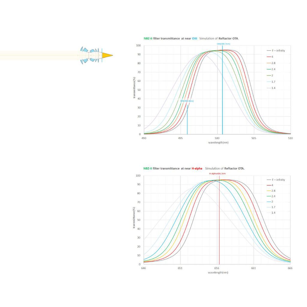

Here's an example of the IDAS NBZ II filter that shows the focal ratio performance by transmittance%:

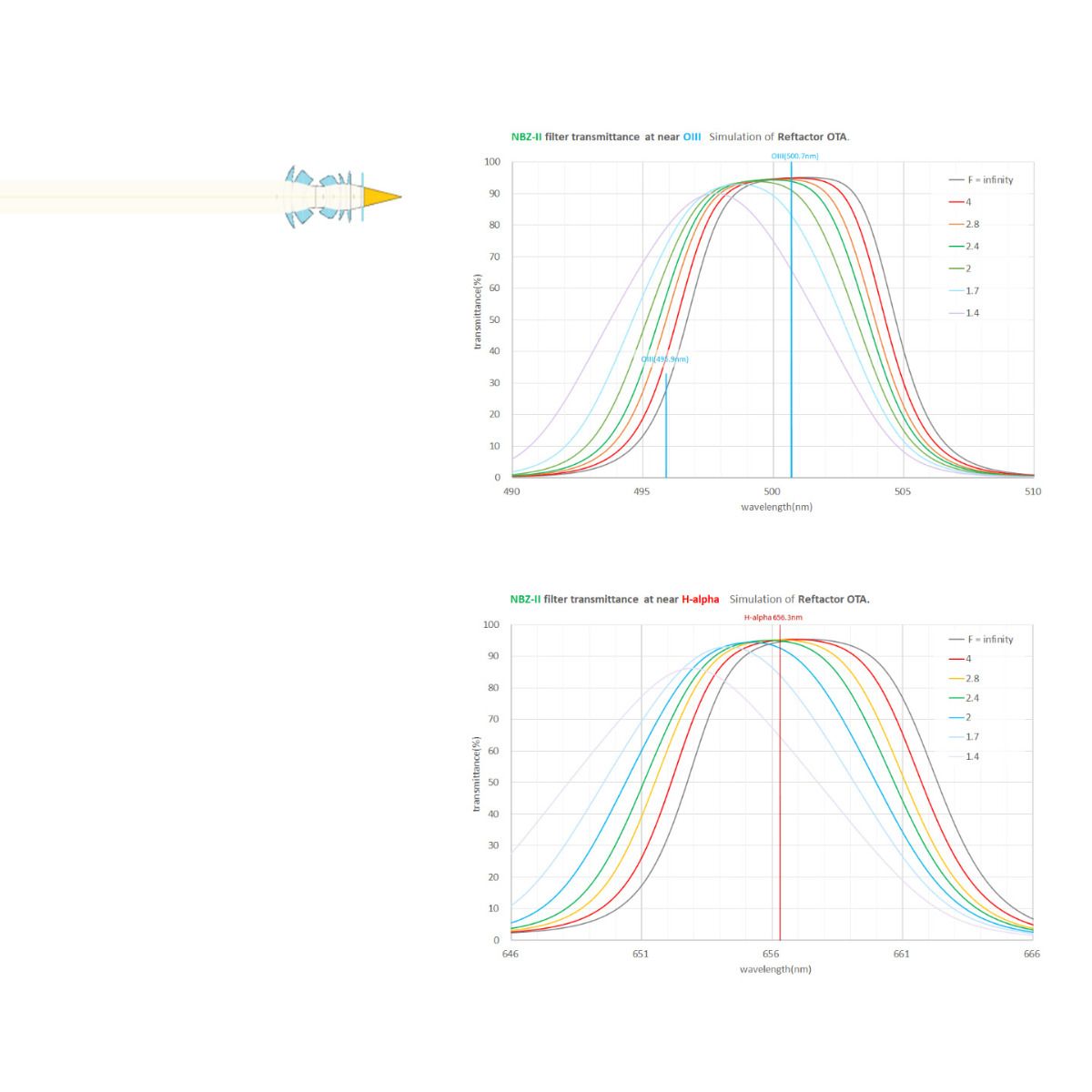

Perfect thanks!

 I have the IDAS NBZ filter the graph refers to. I think the graph is designed to inform buyers of the light band fall off using camera lens.  I don't know of any scope going to F1.7.  But the F stops are typical of camera lens.  So, the chart informs me that if I use the filter with my 135mm lens, F4 is my best F setting and not to go below F2. Of course it can be a guide for scopes also. I use the filter on a FSQ85ED at f3.9.
