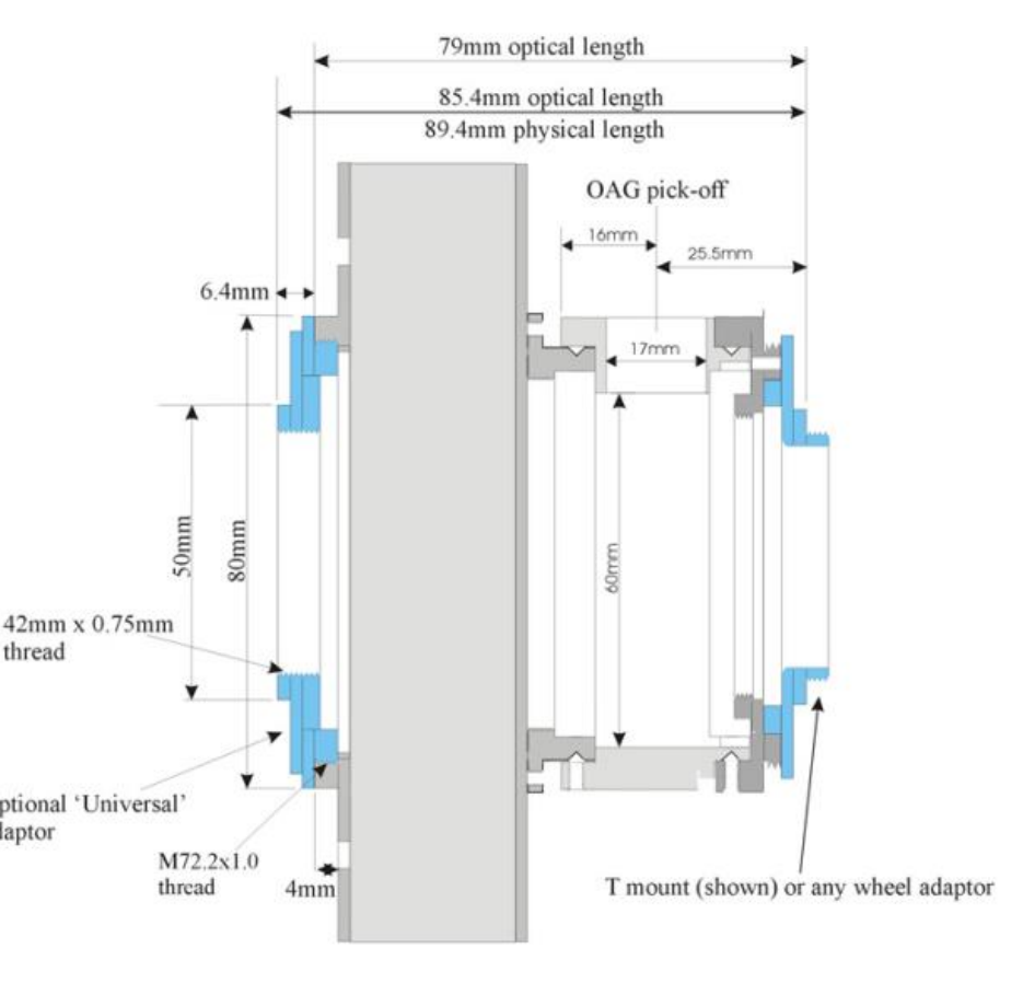

What can you tell me about the custom adapter?  Where did you get it?  What is it like?
I'm trying to squeeze something into the 90.3mm +/- 2mm backfocus the SCTCORR-4 gives me.
I need a custom M42 x 0.72 Female -> M72.2 x 1.0 Male telescope side  and then something to connect the Camera side to a Pegasu OAG (leaving room for the guide camera).
None of their diagrams show just the AO device without their OAG attached.
I’ll have to see if I can find the info. I know places like precise parts can make custom adapters, but be darn sure you have all your measurements correct before ordering from them.
