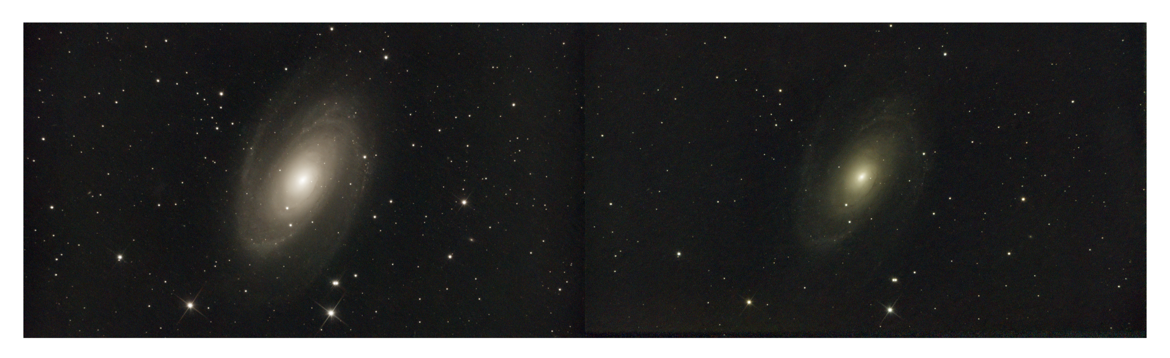

I finally had an opportunity last night to do a side by side filter test of M81. Both images are stacks of 160, 15 sec. subs with full calibration. Each image was color balanced, stretched 10%, background extracted and noise reduced. The no filter image was taken before meridian passage and the uv/ir image after to match elevation Transparency and seeing seemed to be constant throughout the session. Sensor was a ZWO 585 cooled to -10c, gain set to 255. Telescope was a 150mm f/6 Newtonian with standard coatings, no corrector configuration. The uv/ir cut filter is from SVBony. Average measured FWHM for both images was 2.8". Imaging scale was 0.66 arc/sec per pixel. Light pollution, Bortle-7.5
It should be noted that the flats had to be shot at 0.05 for the uv/ir cut and 0.02 sec. for the no filter config to get a similar histogram between the two configurations.
Oh, and I forgot to mention that the uv/ir cut image is on the right!
